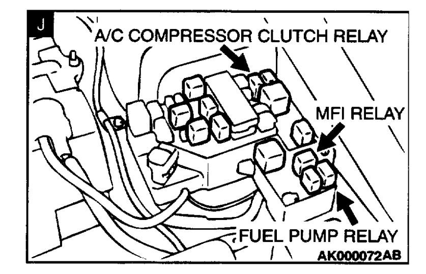

Good morning,
Do you have a set of gauges to give me the high and low side readings of the system?
Do you have a voltmeter or test light to do some testing? I want to see about testing power to the compressor.

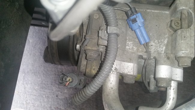

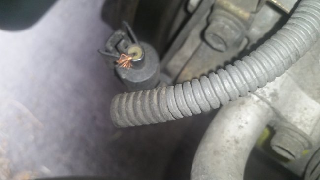

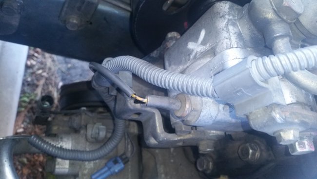

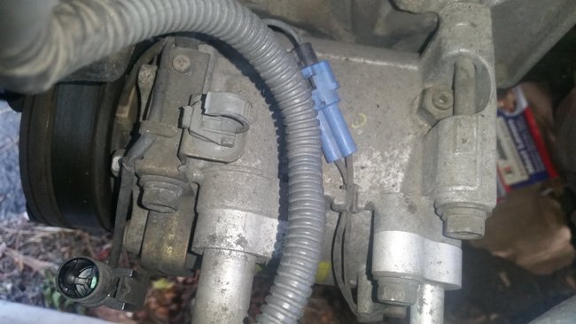

So today I went to recharge the A/C system, and noticed a broken wire connected to the A/C Compressor (see attached pictures). I believe this is the Refrigerant Temperature Switch according to the repair manual. It's a one wire connector that plugs into the A/C Compressor. There is a separate 2-wire connector which must be power and ground. So this must be the signal wire I assume. Anyway, from the help of a friend, we tinned up both sides of the wire, soldered it back together, added a little duct tape, and the compressor started working again! So that's the solution to this question.
Since I already bought the R-134A recharge kit, I went ahead and did that too since it was a little low as well. I'm a little paranoid that I overfilled it because the gauge is jumping around a lot. I realize it's supposed to read high when the compressor is off, and gives an accurate reading when the compressor is on. But I was getting varying readings while the compressor was running too. Does it take a while for the fluid to circulate or something before it reads accurately? It was reading as high as the yellow area of the gauge (50-60 PSI) while running, and finally settled back around 35-40 (the green area is 30-50 PSI). I'm going to recheck this again in a day or two and see what it says then. I want to be sure I did not overfill it, and thus could cause damage to the compressor.

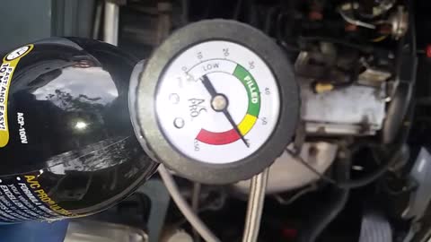

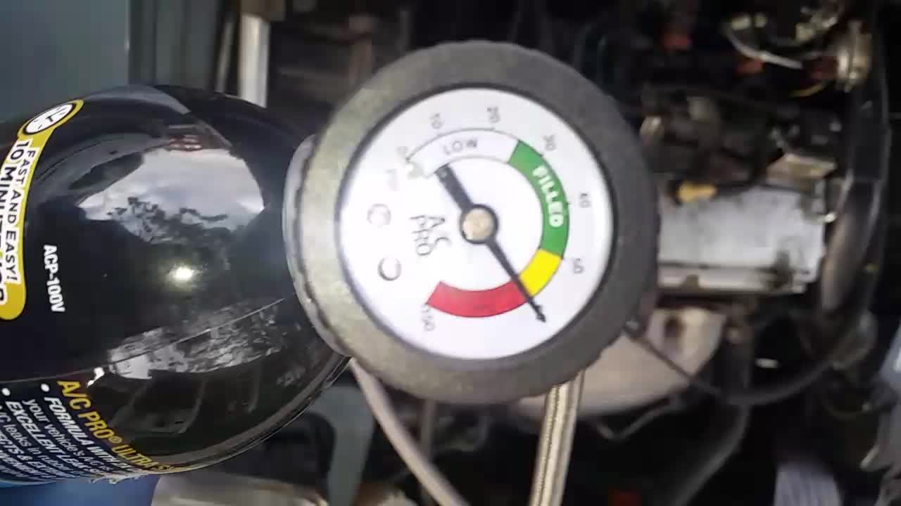

Low side is what the kit has me check and plug into. The gauge goes from 0-150 PSI, which 30-50 PSI being green, 50-60 being yellow, and 60-150 being red.
One thing I forgot to do was have recirculate activated, which I know drops the reading further. I've noticed my compressor is kicking on and back off a lot while idling, I notice the RPM's going up and down from the IAC. When I'm driving, sometimes the A/C is blowing very cold, other times it's kinda warm. So something is still not quite right here.
Jun 3, 2020 at 10:47 AM
What is the reading on the gauge when the AC is operating?
Jun 3, 2020 at 10:55 AM
KIWASABI1
  • 202 POSTS
See attached video. This is with the A/C set to maximum with recirculate "on". When the compressor is off, it's at 60 PSI. When it turns on, it's around 50. Which evidently is about right on an 80-90 degree day, you're supposed to be at about 45-55. But I suppose my problem is how the compressor is constantly cutting off and on. When it's off and the reading is at 60 (which as you see, is most of the time) it is blowing warm air. When I first turned the car on and it wasn't as heated up, the A/C was blowing very cold and staying on. Once the car got hotter, the compressor constantly cuts out like you see in the video. It would seem there's another problem now unless I'm missing something.

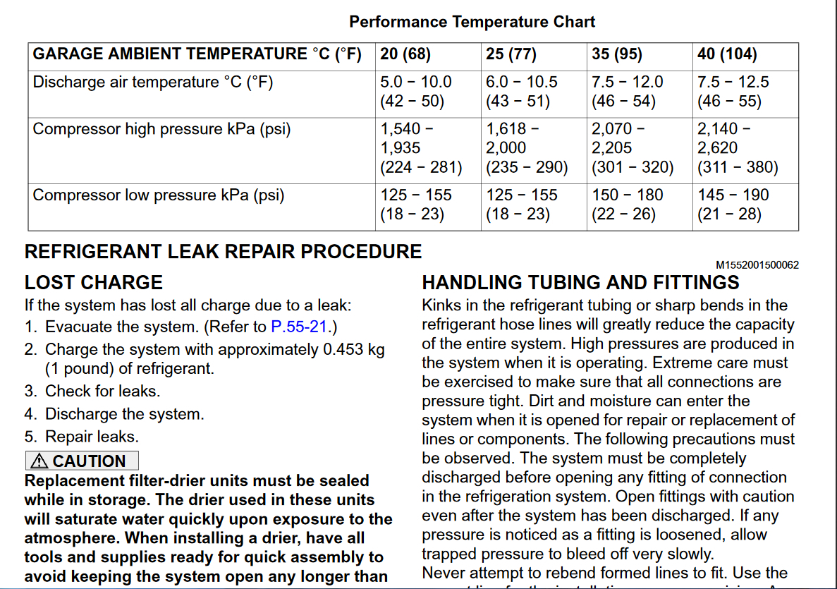

I just did a quick search through the repair manual for PSI and found this that I've screen shot. If I'm reading this correctly, the low side pressure should only be 22-26 PSI when it's 95 degrees outside. When I first put the gauge on, it was reading about 34 PSI or so. I figured, that's on the low side of the green area (30-50), plus when it's hot you're supposed to adjust more like 45-55 I read. I really wish I just left it alone now. Gonna bring it to my mechanic I guess. Otherwise I'm literally bleeding out R-134A onto a towel, which is illegal I've heard.
Jun 3, 2020 at 4:51 PM
Okay, the low side is not dependent on the temperature at all. When running, it should be 25-30 only. If it is higher, the expansion valve is allowing too much Freon into the evaporator.
The gauge you are using has those readings only for adding Freon. They are not indicators for the level at all. Do not think that the reading tells you anything but that you have pressure on the low side.

KIWASABI1
  • 202 POSTS

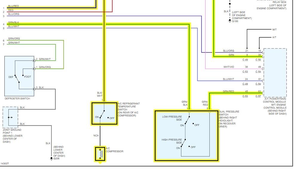

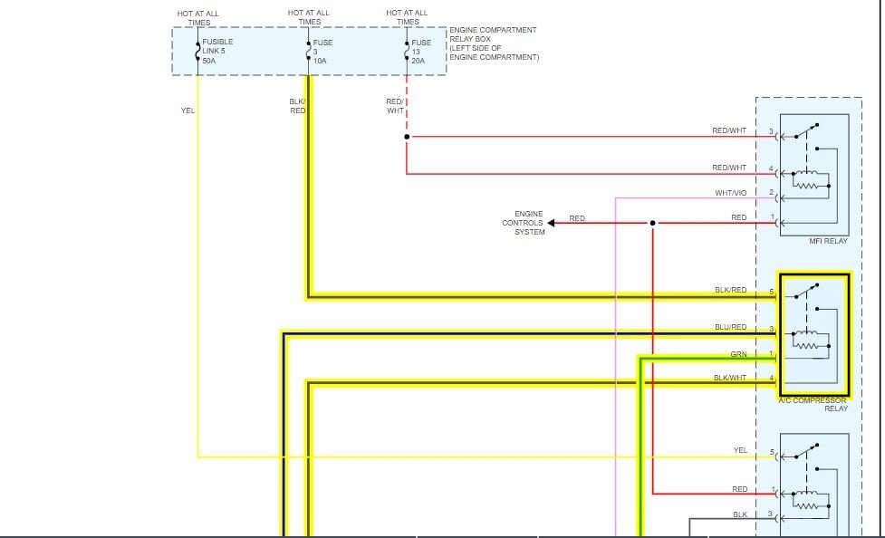

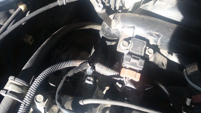

So what's the name of the sensor in these pictures that had broken loose? We soldered it back together and that fixed the A/C. It stopped blowing cold yesterday, and it has broken loose again. I don't think there's enough wire left on the sensor itself to solder it back together again. So probably gonna need a replacement.
Jun 9, 2020 at 6:58 AM
KIWASABI1
  • 202 POSTS

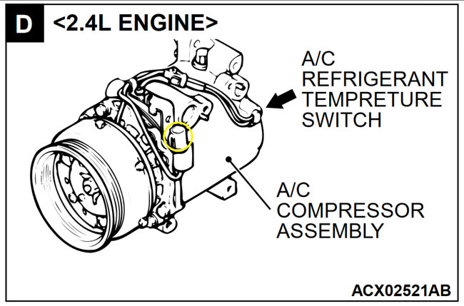

I've circled the sensor in yellow on the diagram. Of course nowhere in the repair manual do they actually put the name of it that I can find.
Jun 9, 2020 at 7:18 AM
The connector you circled is for the temperature switch.
Jun 9, 2020 at 7:27 AM
KIWASABI1
  • 202 POSTS

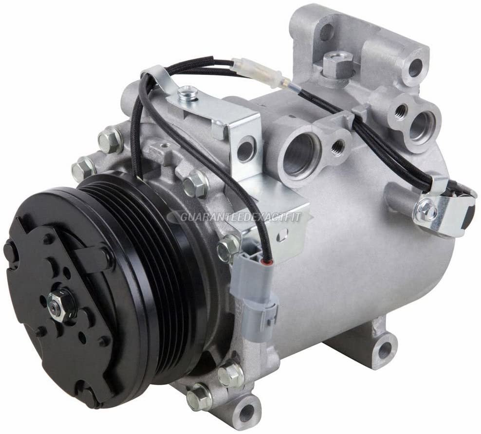

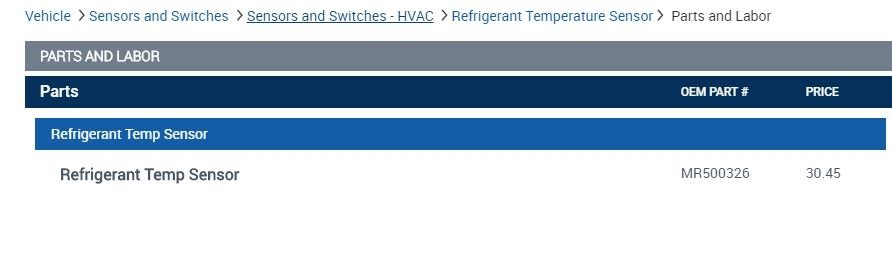

Can you find the part for me? Temperature switch just seemed to bring up the ECT sensor and engine cooling fan sensor. Which temperature switch are you referring to?
Jun 9, 2020 at 8:10 AM
Okay, I attached the part number for you. You need to contact the dealer parts department to confirm price and availability.
Jun 9, 2020 at 8:20 AM
KIWASABI1
  • 202 POSTS

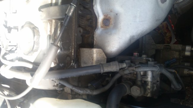

The part you linked appears to connect to the opposite side of the compressor from the connector I'm talking about. I'm attaching more pictures. It is a one wire connector that is housed in a ribbed gray plastic shell, and it continue all the way up to the main wiring harness behind the engine with the MAP sensor and such. So I suppose a complete replacement would include the wire all the way up to this point, or to replace the entire connector harness.
Jun 9, 2020 at 10:07 AM
KIWASABI1
  • 202 POSTS
The connector is the round black circle connector in the bottom left of the last picture. It's right up next to the pulley.
Jun 9, 2020 at 10:09 AM
The only other connector is for the clutch itself which is part of the compressor.
I could not make out anything from your pictures.

KIWASABI1
  • 202 POSTS

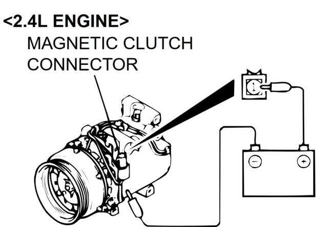

Mostly the last picture is the useful one. It shows exactly where the connector sits on the compressor. The black circle connector in the lower left is the connector in question.
Can you find the part number for the A/C clutch connector then? This appears to be spliced in directly to the main harness though. That's what the other pictures are supposed to show, that the gray sort of ribbed plastic housing for the wire continues all the way up to the main harness, splicing in right around the MAP sensor. There is no other connector that it plugs into, like the refrigerant switch sensor that you mentioned above does.
Jun 9, 2020 at 6:27 PM
KIWASABI1
  • 202 POSTS
Here's a perfect picture. It's the connector right by the clutch. So I guess you're right, it's the A/C Compressor Clutch Connector. I can't for the life of me find one online. I found Standard Motors part #S-1530 which is very similar, but it's 2-wire and has a slightly different connector from mine.
Jun 9, 2020 at 6:47 PM
KIWASABI1
  • 202 POSTS
I finally found it in the repair manual. It's called Magnetic Clutch Connector in there. But searching for that brings up no results. This may simply be a junk yard item only.
Jun 9, 2020 at 6:52 PM
There is no part number for the connector. It is not serviced separately.
You could just bypass the connector and solder and shrink wrap the wires together to eliminate the connector itself.
Jun 9, 2020 at 6:55 PM
