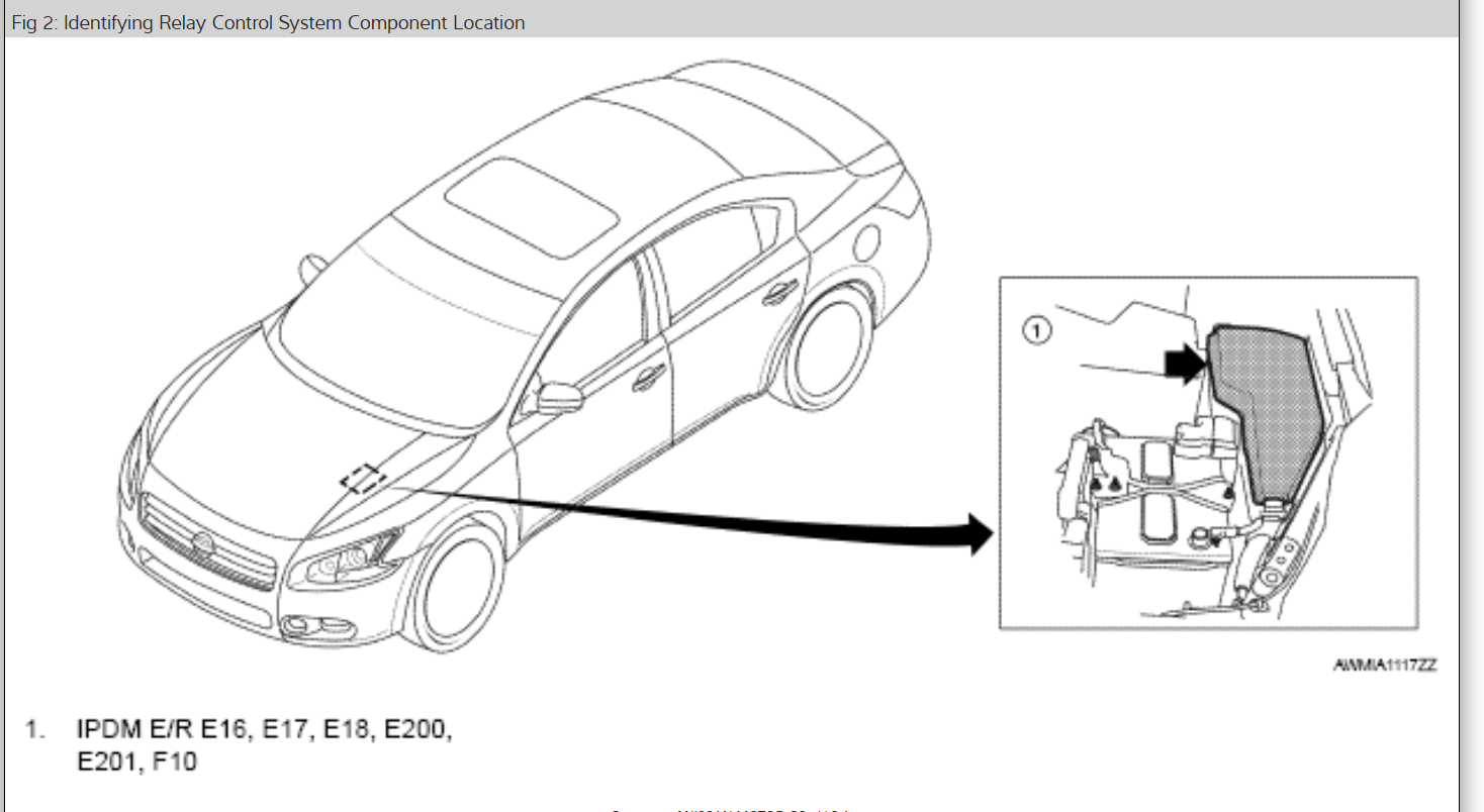

I'm trying to find the location of the A/C relay but I cannot seem to find it. Any help please?
Jul 6, 2019 at 11:21 PM
  • 55,433 POSTS

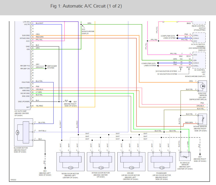

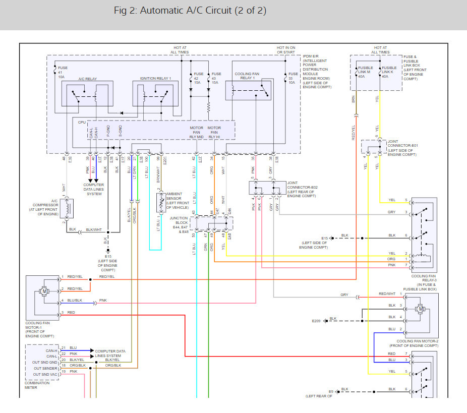

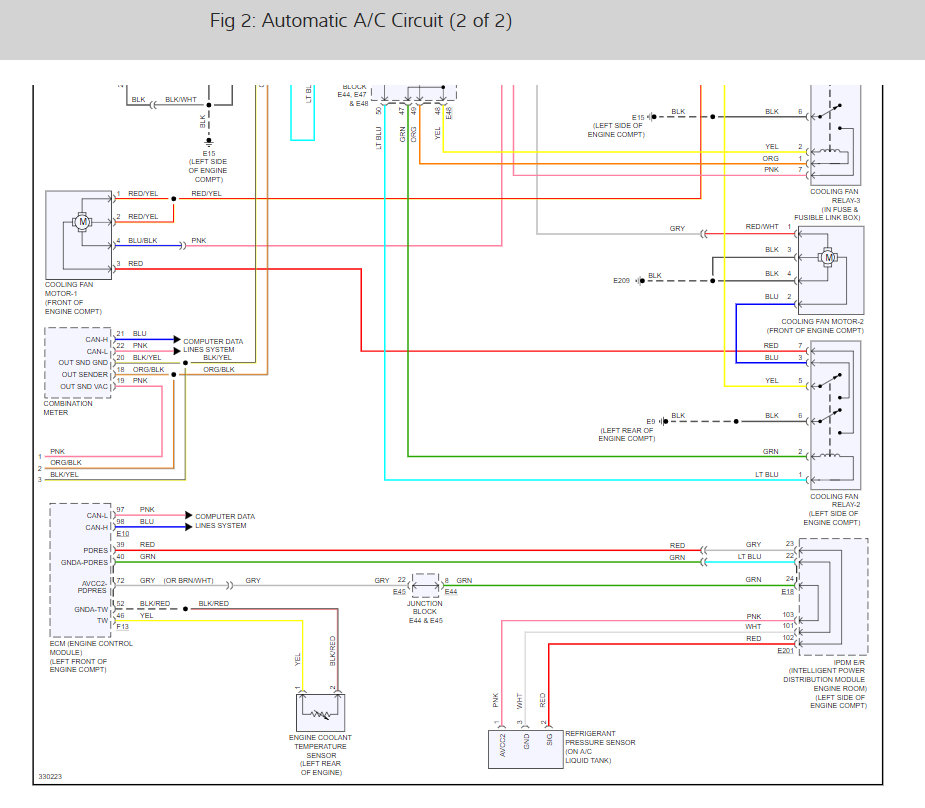

A/C relay is in IPDM E/R (intelligent power distribution module, engine room). Internal and not serviceable. Here are the air conditioner wiring diagrams so you can see how it works with a guide to help you check for power to see what's going on:
