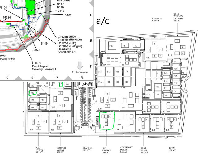

My battery died, and after I charged it the A/C is acting weird. The A/C button light and the circulation button light are blinking continually. You can control the power of the air coming out but that’s all. It blows hot air up through the defrost vents and that’s all it will do. I checked the fuse box inside the car and it’s fine. I didn’t check the A/C clutch fuse under the hood. I’m not sure if that’s even relevant to the problem. It was blowing ice cold before it died and now that the new battery is in, it’s gone wonky. Can anyone help me?

BMDOUBLE
  • 1,139 POSTS
Here are the fuse and relays for your car highlighted in green. The smaller ones are the fuses, fuse 23 is a 5 amp fuse and 34 is a 10 amp fuse, a quick check of these should be done just to make sure they are not blown. The relay sometimes can be swapped with another relay as long as it looks exactly the same and it is oriented in the same position. I would just snap a picture before removing anything. I'll do some more digging during the day.
Jul 11, 2019 at 9:59 AM

VIOLA SHUMAN
  • 8 POSTS
Okay, I checked the fuses under the hood and it all looks fine. Nothing blown. Blah.
Jul 11, 2019 at 12:32 PM
