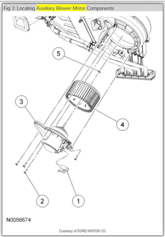

2. Rear air not blowing at all on any temperature setting. The rear fan controls (in the front and in back) do not engage the rear blower at all. No air comes out regardless of the temperature or fan setting. Would this be caused by a resistor or more likely is it a blower motor? How would i be able to tell which one is the culprit? The other challenge I have is that I do not know where the blower for the rear is located. Any tips would be greatly appreciated.

Also, for the rear air here is a diagram you must use a test light to see if the blower is getting power if not it needs replacing.
Let me know what you find.

Second problem was the auxillary blower. I removed the passenger rear panel and after removing 3 star screws and the electrical connectors, replaced it and now it blows like a charm! Thanks!!
