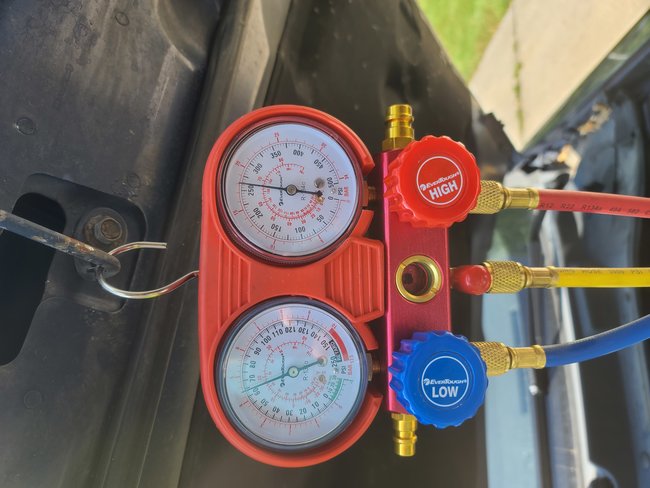

Okay, we are back to the gauges. I need to see the reading for the A/C pressures.
Can you rent a set and get them for me?
May 27, 2020 at 3:52 PM

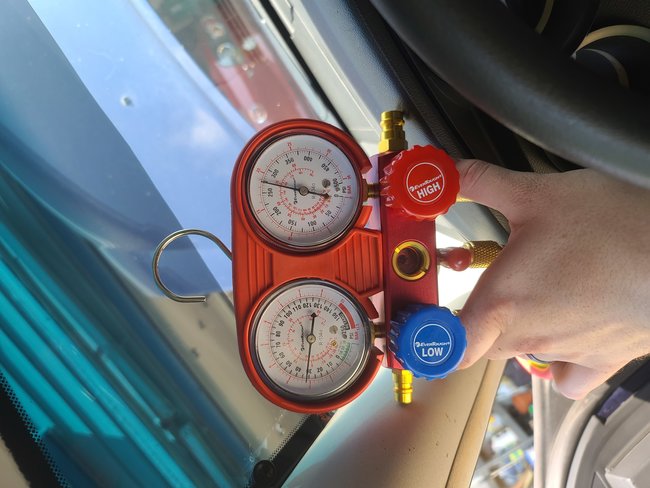

XAVIER_COX
  • 34 POSTS
Low side reading 105. High side reading 100.
May 27, 2020 at 4:01 PM

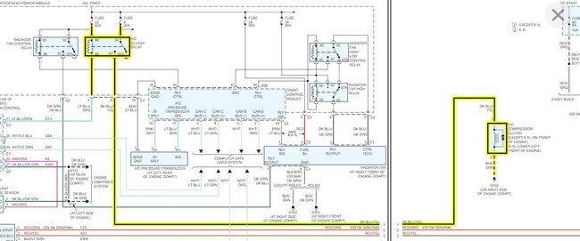

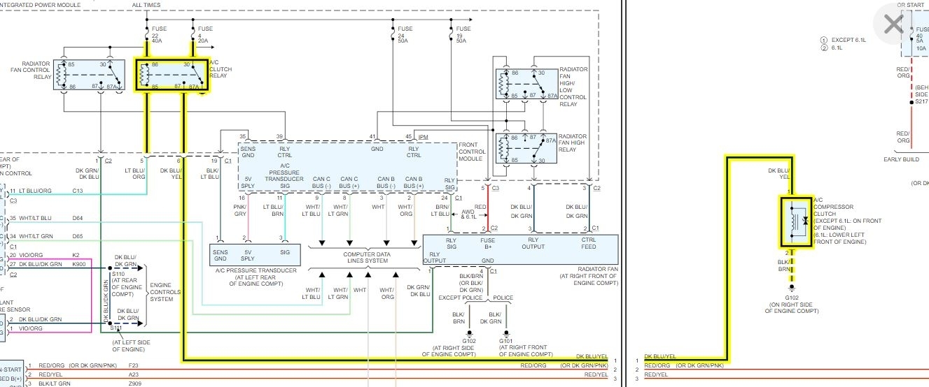

Nice, thank you.
If the A/C clutch is engaged and that is the reading, then the compressor is bad.
If the compressor is not engaged there is an electrical issue. I attached a wiring diagram for you of the compressor circuit.
You will need a test light to do some tests.
May 27, 2020 at 4:07 PM

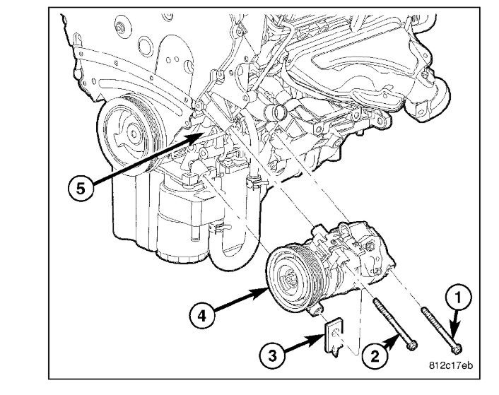

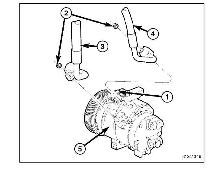

Compressor
1. Recover the refrigerant from the refrigerant system.
2. Disconnect and isolate the negative battery cable.
3. Remove the air cleaner housing.
4. Remove the serpentine drive belt.
5. Disconnect the wire harness connector from the A/C compressor clutch coil connector (1).
6. Remove the nuts (2) that secure the A/C suction line (3) and A/C discharge line (4) to the A/C compressor (5).
7. Disconnect the suction and discharge lines from the A/C compressor and remove and discard the dual plane seals.
8. Install plugs in, or tape over all of the opened refrigerant line fittings and the compressor ports.
9. Raise and support the vehicle.
10. Remove the front end splash shield.
11. Support the A/C compressor (4) and remove the bolts (1 and 2) that secure the compressor and automatic transmission cooler line bracket (3) to the cylinder block (5).
12. Position the cooler lines out of the way and remove the A/C compressor from the engine compartment.

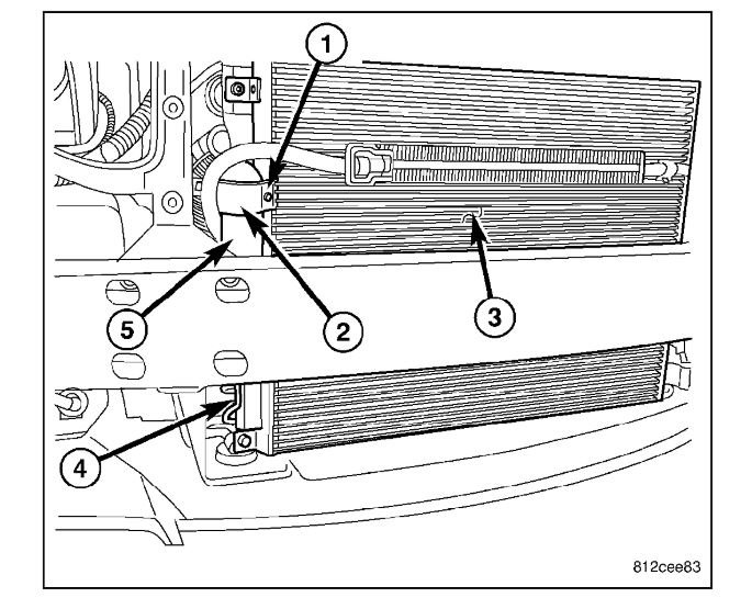

Dryer
3. Remove the front fascia.
4. Remove the screw (1) that secures the receiver/ drier mounting bracket (2) to the right end of the A/C condenser (3).
5. Remove the bolt (4) that secures the receiver/drier (5) to the A/C condenser.
6. Disconnect the receiver/drier from the A/C condenser and remove and discard the dual-plane seal.
7. Install plugs in, or tape over the opened receiver/drier fitting and the condenser ports.

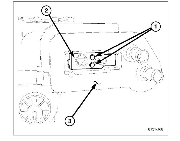

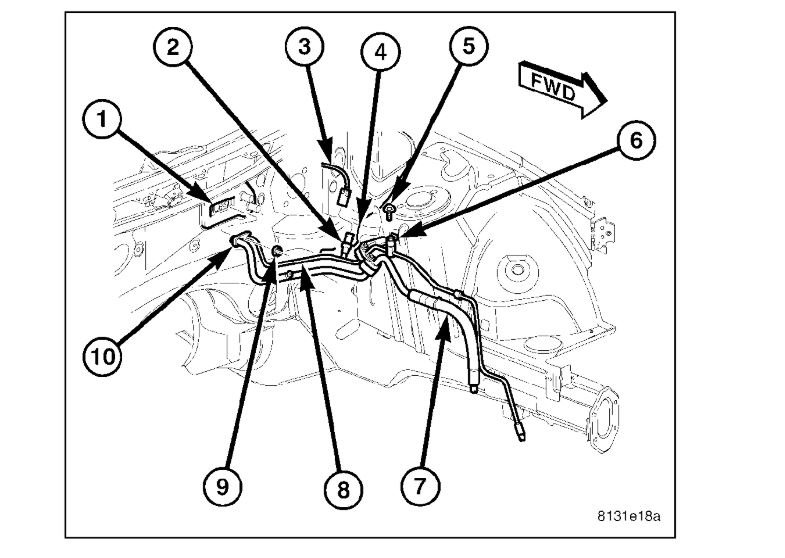

Expansion valve
3. Remove the bolt (5) that secures the refrigerant line mounting bracket (6) to the left front shock tower (4).
4. Remove the nut (9) that secures the refrigerant line tapping block (10) to the A/C expansion valve (1).
5. Disconnect the wire harness (3) from the A/C pressure transducer (2) to help allow access to the A/C expansion valve.
6. Disconnect the A/C suction line (7) and the A/C liquid line (8) from the A/C expansion valve and position the refrigerant lines out of the way.
7. Remove the dual plane seal from the suction and liquid line fittings and discard.
8. Install plugs in, or tape over the opened suction and liquid line fittings.
9. Remove the two bolts (1) that secure the A/C expansion valve (2) to the evaporator tube tapping block located within the foam seal (3).
10. Remove the A/C expansion valve from the evaporator tube tapping block and foam seal.
11. Remove the dual plane seal from the evaporator tube fittings and discard.
12. Install plugs in, or tape over the opened evaporator tube fittings and all expansion valve ports.

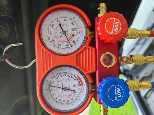

XAVIER_COX
  • 34 POSTS

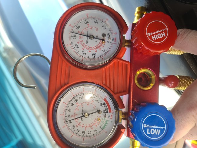

Today it looks like this. Are we still thinking compressor is bad? It's only 73 degrees out today. Yesterday was 85 or so.
May 28, 2020 at 9:33 AM
Same result.
The high side should be 2 times ambient temperature plus 15%
The low side should be 25-30 pounds solid.
The fact they are the same indicates a failed compressor.

This picture shows fully rev at 2,500 for 20 seconds.
Jul 9, 2020 at 1:58 PM

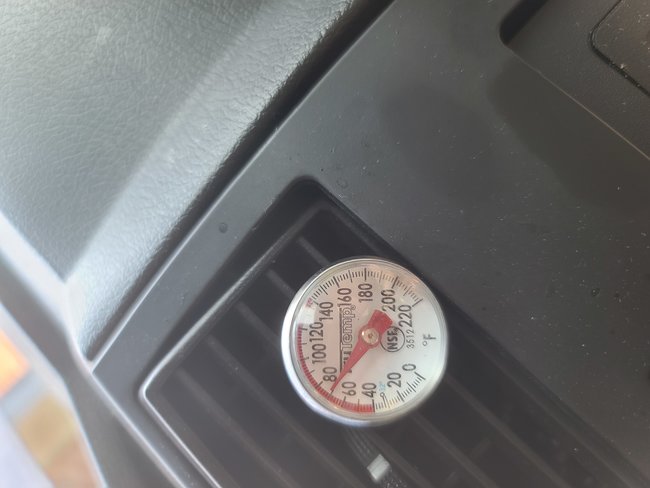

XAVIER_COX
  • 34 POSTS
This picture is idle with vent temping at 60 degrees on a 90 day.
Jul 9, 2020 at 1:59 PM
XAVIER_COX
  • 34 POSTS
Any clue one what's going on? When I sit in my car it's usually 60 degrees coming out of the vent and if I rev my engine it goes down close to 50 degrees.
Jul 9, 2020 at 2:01 PM
Okay, put a floor fan in front of the radiator and take the readings again.
the low side is too high. The high side is good.
Did you change the expansion valve?
Jul 9, 2020 at 2:04 PM

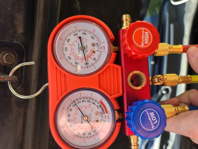

XAVIER_COX
  • 34 POSTS
I did not have a scale. Trying to think it told me like 26 oz. I ended up doing almost 2 small cans. tried to leave just a little left in the 2nd can.
Jul 9, 2020 at 2:16 PM
XAVIER_COX
  • 34 POSTS
This is after fan on it and running about 8 to 10 minutes.
Jul 9, 2020 at 2:17 PM
Okay, you are good. The spec is 1.6 pounds which is 2 12 ounce cans.
Jul 9, 2020 at 2:19 PM

Is it normal for the gauge to fall that low when i rev my engine? I should note i put on a heavy duty condenser. But everything said it was compatible.
Jul 9, 2020 at 2:25 PM
How much oil did you recover when you did the repairs?
The low side should be 25-30 pounds.

I see a connector on the A/C pipes looks like it might be a A/C pressure switch. Is this something to consider changing. Only 27 bucks. I'm not sure if i would need to discharge and recharge my A/C system to change that.
Jul 9, 2020 at 2:59 PM
No, if it was bad the system would not work.
The low side is too high. That is the issue.
I am concerned there is too much oil in the freon system. You said you added 6 1/2 ounces and that is too much. That could be the issue.
You should have only added 3 ounces at the most.
