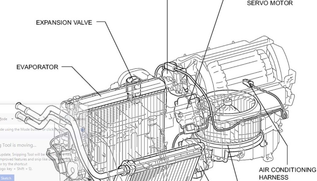

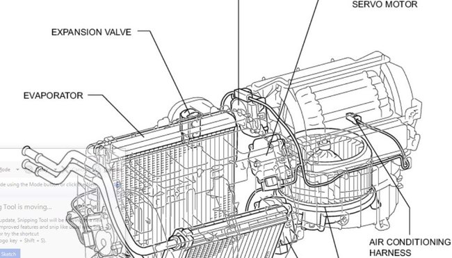

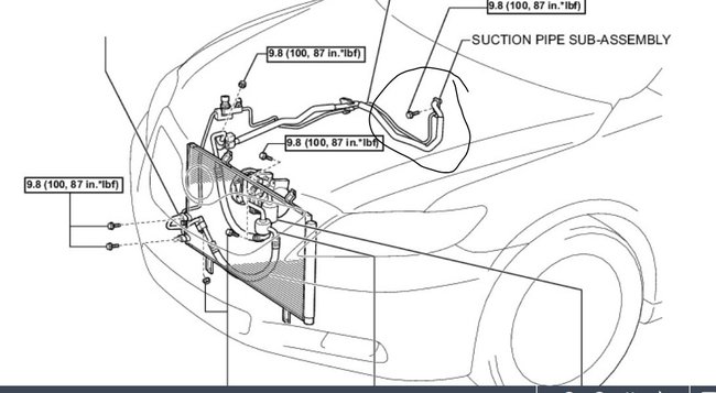

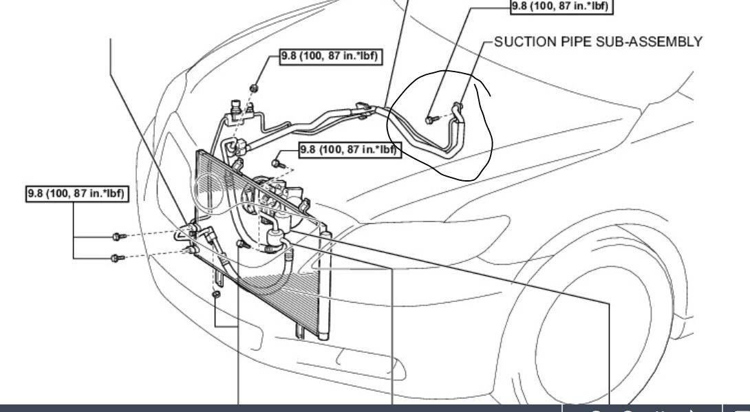

Static pressure, high and low 80 degrees . Outside air temperature 79 degrees. Car running, high 115 low 65 degrees. At 2,000 RPM's high 125 low 70. After car shut off for 18 minutes high 125 low 90. Dose this indicate a bad TXV or compressor control valve?
Oct 28, 2019 at 7:22 AM
Good afternoon,
I do not understand your numbers.
First static pressures should be equal with the engine off and almost the same pressure as the outside temperature.
Running, the high side should be 2 times ambient air plus 15%.
The low side should be 25-30 solid no matter the temperature.
Can you recheck those values?
Oct 28, 2019 at 8:49 AM
LIONEL9
  • 6 POSTS
With the car not used in two day and when manifold gauges were connected (engine off for two days) the high side pressure read 80 psi and the low side read 80 psi, on a 79 degree day. With the engine started, A/C turned on, max cooling set on control and fan set to near max, the high side read 115 psi and the low side read 65 psi at idle. Increasing the engine speed to 2,000 rpm raised the high side to 125 psi and the low side to 70 psi. With the engine off the high and low side pressures still did not equalize after 18 minutes. high was 125 psi and low was 90 psi. High and low hoses all feel warm to the touch.
Oct 28, 2019 at 11:12 AM
Okay.
Oct 28, 2019 at 12:31 PM
LIONEL9
  • 6 POSTS
Can the problem be in the expansion vale or in the compressor control valve?
Oct 29, 2019 at 7:41 AM
As I stated, yes, the expansion valve and the dryer need to be changed.
There is no compressor control valve.
Oct 29, 2019 at 7:45 AM
LIONEL9
  • 6 POSTS
Hi Roy, my car has a clutch less compressor (does not cycle on and off) it uses a internal control valve to very output PSI. I am not sure if it could cause the pressure readings I am getting if it is acting up.
Oct 29, 2019 at 8:00 AM
No, it would not.
Besides, the expansion valve is not controlled by the compressor.
Oct 29, 2019 at 9:06 AM
LIONEL9
  • 6 POSTS
HI Roy, I get that the expansion valve if failed open will cause the high pressure side to be low and the low pressure side to be high, because there is not a big enough restriction in the expansion valve to separate the two sides. What I do not understand is when the car was turned off the pressures do not equalize. I watched them for eighteen minuets without dropping. Would not a open expansion valve cause the system to equalize quickly. Can the expansion valve be causing both conditions.
Oct 30, 2019 at 3:17 AM
Yes, the expansion valve is causing both issues. If the pressures do not equalize, the valve is closed.
Oct 30, 2019 at 5:35 AM
LIONEL9
  • 6 POSTS
Roy, thank you for your help.
Oct 30, 2019 at 7:23 AM
You are welcome.
Always glad to help.

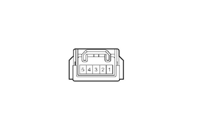

GIOGTVTS
  • 5 POSTS

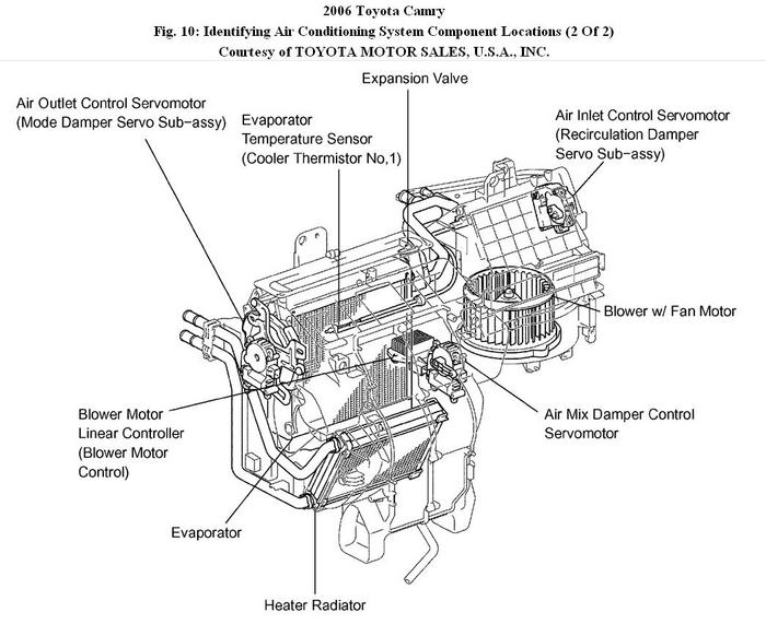

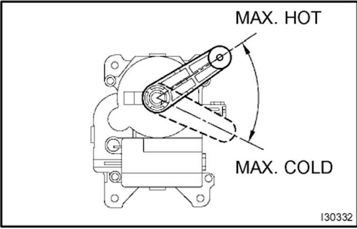

My Toyota Camry is having problems with the left bank vents blowing warm air, while the right bank vents are all blowing cold air
Nov 27, 2020 at 12:27 AM (Merged)
KHLOW2008
  • 41,812 POSTS
Such problems are caused by the air mix servomotor or its linkages. Try switching between heater and A/C a few times and note fif the servomotor is running correctly.
GIOGTVTS
  • 5 POSTS
Thank you for your reply KH Low. I have tried the fix you suggested, but it does not work. My air cond is a manual one (not auto/ temperature control type). Does this type of air cond have Air Mix Servomotor?
KHLOW2008
  • 41,812 POSTS
Yes, even the manual system has the servomotor.
Inspect servomotor operation.
1. Connect the positive (+) lead from the battery to terminal 4 and negative (-) lead to terminal 5, then check that the arm turns to "COLD" side smoothly.
2. Connect the positive (+) lead from the battery to terminal 5 and negative (-) lead to terminal 4, then check that the arm turns to "HOT" side smoothly. If operations are not as specified, replace the air mix servomotor.
GIOGTVTS
  • 5 POSTS
Thank you very much for your help KH Low. Really appreciate it.
