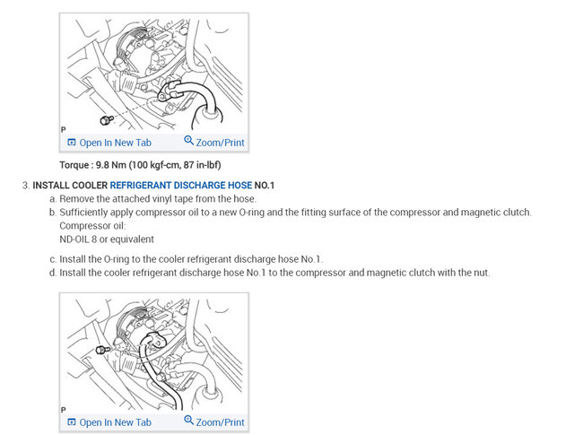

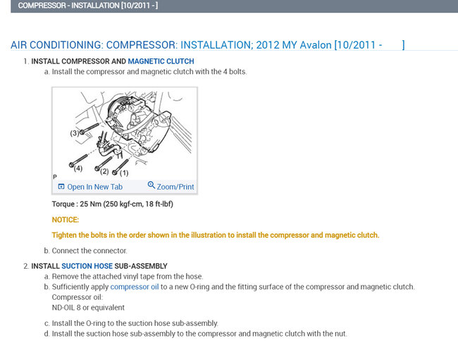

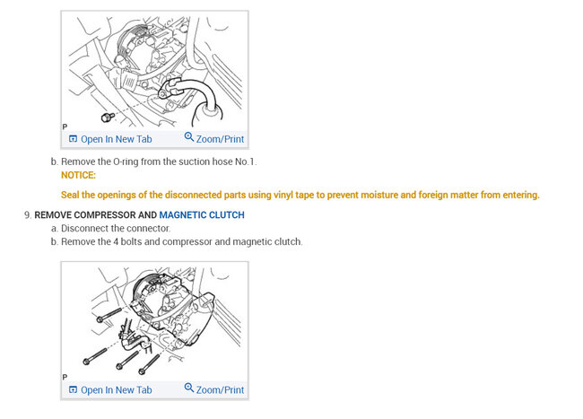

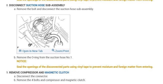

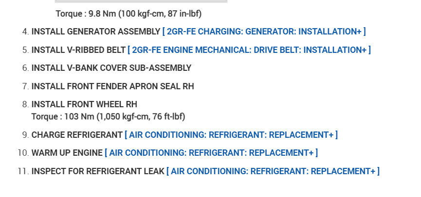

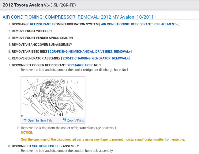

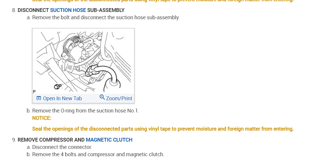

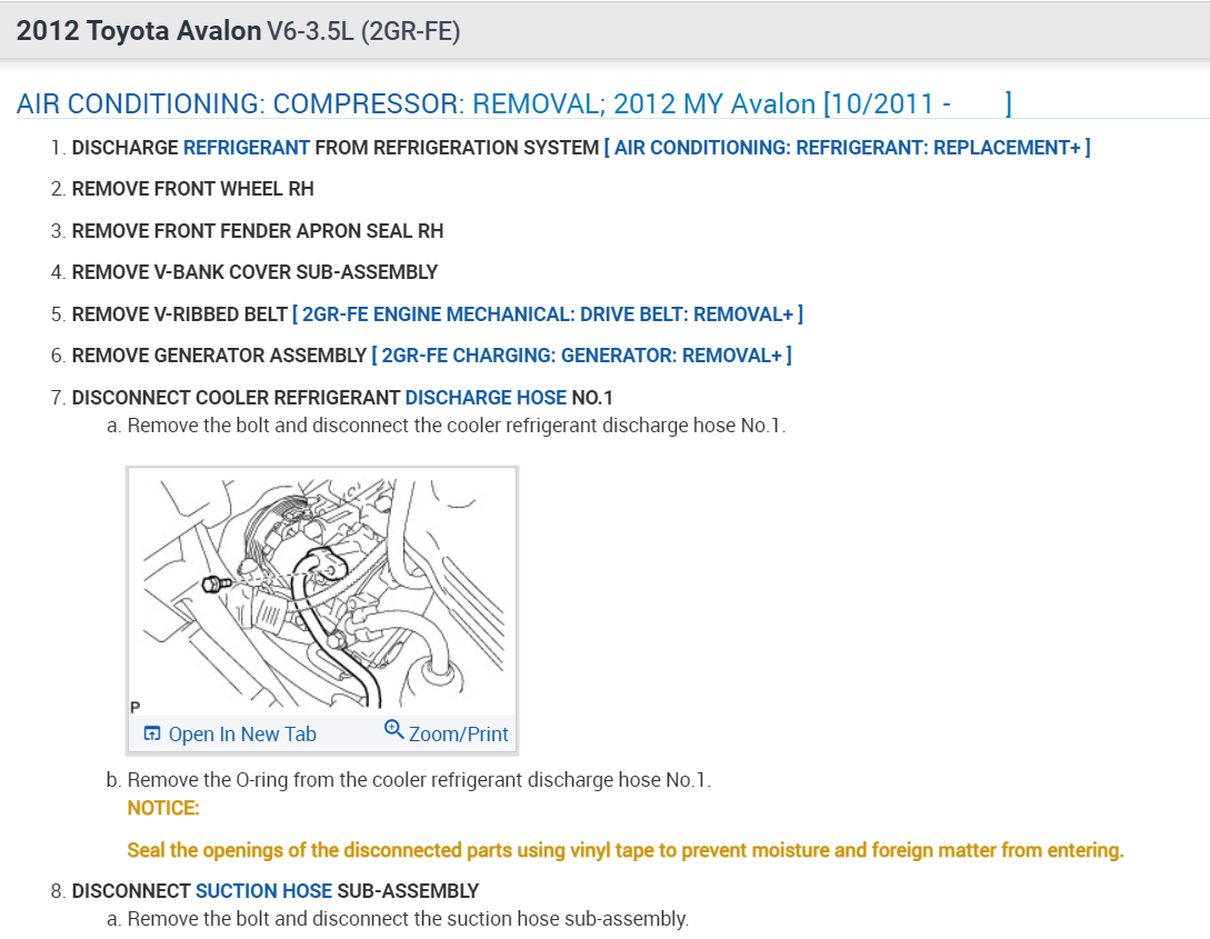

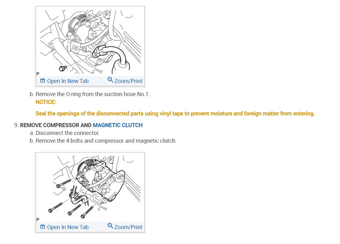

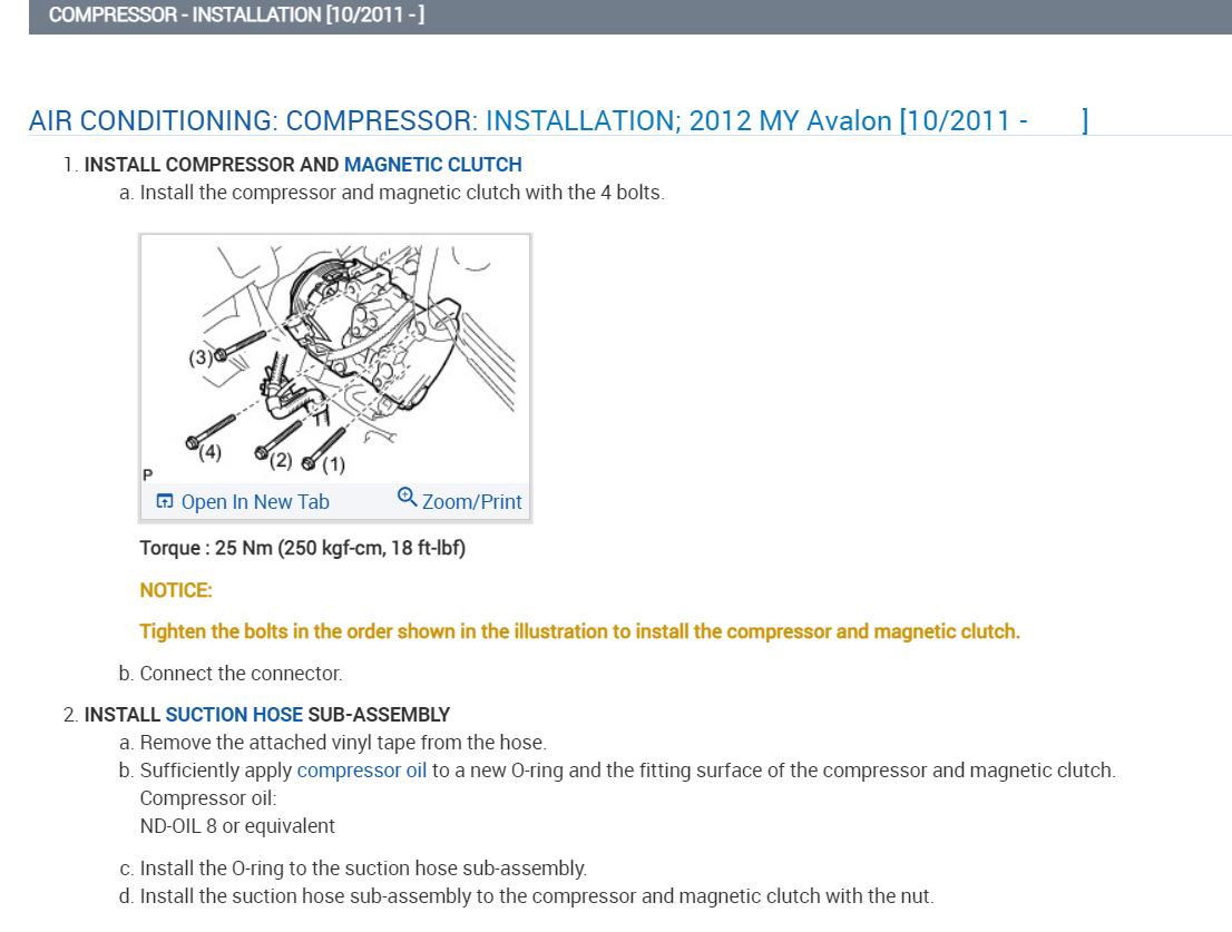

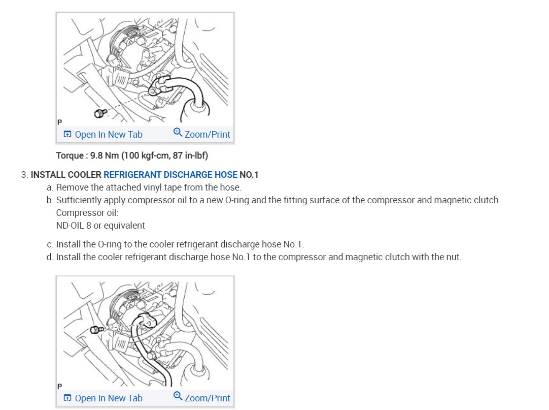

This sounds like the compressor is going out. Here is a generic guide to help you step by step with instructions in the diagrams below to show you how on your car:
https://www.2carpros.com/articles/replace-air-conditioner-compressor
Please go over this guide as well:
https://youtu.be/4EqdrBVb0sY
Check out the images (below). Please let us know if you need anything else to get the problem fixed.

Follow-up: Today I took the new compressor (UAC brand) and turned it upside down to drain out the pre-installed PAG oil, but none came out. Curious, I then took the old compressor and turned it upside down, and none came out of that, either. So, I figured "these compressors must hold the oil in a reservoir of some kind." There was no drain bolt. So I got everything installed and was doing a vacuum draw down when I noticed a sheet of instructions that came with the compressor, and it specifically said to turn the compressor upside down and "discard the oil that came with the compressor, and fill the compressor with half the PAG oil specified by the car manufacturer and put the rest into other components." That made me realize there's not some magic reservoir that doesn't drain out of the openings. So, now I have a fully-installed system that I do not want to have to take apart again. Am I right in concluding that the compressor manufacturer did not put any oil in compressor, since none drained out? And, can I just add the whole charge of PAG oil to the low pressure side to work its way into the compressor, or will that ruin the compressor? Any advice much appreciated!
Aug 29, 2023 at 5:05 PM
  • 55,221 POSTS
That is hard to say, it sounds like no oil came in the compressor but can I ask if you turned the clutch while trying to drain it? If so then the compressor sounds dry and will need an oil charge. Please let me know how it goes.
Aug 30, 2023 at 3:51 AM
TVSTEINKE
  • 6 POSTS
Thanks for the quick response!
I did turn the clutch while holding the compressor upside down to see if that released any oil. It did not. Same with both the new one and the old one.
Aug 30, 2023 at 3:54 AM
TVSTEINKE
  • 6 POSTS
I ended up dividing the remaining oil between a low sideline near the compressor (about 2/3 of the oil) and a high sideline. It seems to be working just fine. Thank you very much for your willingness to help!
