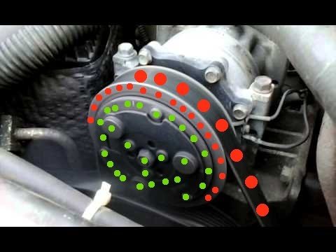

Literally just bought a beautiful vehicle listed above in perfect condition, well cared for. On the way home (chilly winter evening), thought I would test the A/C as it was the one thing we did not check before signing the deal. It blew cool but not icy cold, just cool, felt like it needed recharging. Half hour or so later, the serpentine belt snapped, lost power steering and had to coast into a rural town bar, closest thing in sight. Steam spewing, lost some fluids, hoping there is not more damage but wondering if the A/C compressor has a connection to the serpentine belt and if the A/C was out if that could cause the belt to snap.

The belt drive the AC compressor. It is possible the belt had not been replaced and the extra load of the compressor was enough to snap it. It is also possible that the compressor locked up internally and that snapped the belt. Not hard to test that if you can reach the compressor. Try to turn the belt pulley and then the center hub of the compressor. They should both turn freely. Check the other items the belt drives as well. Idler pulleys, alternator, power steering pump, even the water pump. If any of them stop it will cause heat and tension that can snap the belt.

If the AC compressor itself has locked up it will depend on which part has failed. There is the pulley itself that is driven by the belt and rides on a bearing and should spin freely if the AC is not on (items with red dots in picture). If that piece still spins freely replacing the belt and driving it to a shop should be fine.
The part with the green dots is the clutch plate. It gets pulled back into the pulley when the AC is turned on or if you use the defrost setting, when that happens it spins with the pulley and actually turns the AC compressor itself. It is turned on by a wiring connector near it with a simple two wire connection you see in the picture.
If you try to turn that part (green dots) and it does not move the compressor is bad. That can be expensive but it is repairable.
If the red dotted part turns free and with no noise you can disconnect the clutch wiring just to be sure the green clutch does not turn on until you get it fixed.

Easy way is with the belt off see if the A/C compressor pulley turns. If it does then you could put the belt back on and drive the car. There is a two wire clip in the back of the A/C compressor. disconnect it put it out of the way of any other moving parts. I had done one and just put tape over the electrical end and zip tie it to another wire. I do this on a couple of our cars. during the winter. because when you turn the defrost on the A/C compressor engages so to help take out moisture off the windows. That way you can drive the car a usual until you can have the compressor checked out.
