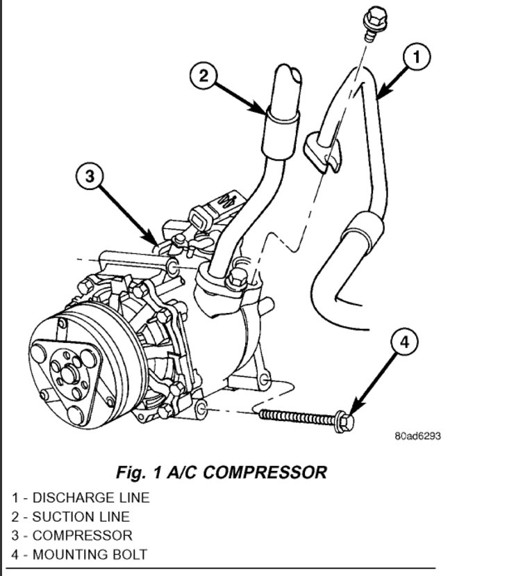

You need to stay with the name brand compressors or the guys installing the compressor are doing something wrong. Here is a guide that has a video that will show the job being done right:
https://www.2carpros.com/articles/replace-air-conditioner-compressor
and here is how it needs to be charged up.
Here is a diagram on how to do it in your car (below).
