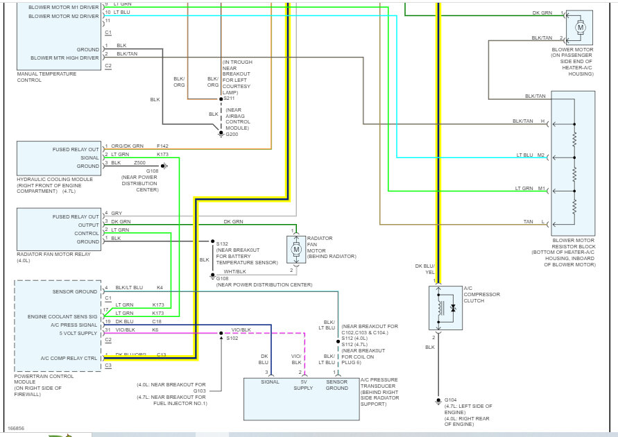

After pressure testing, I recharged my A/C. I jumped the compressor during recharge, and got so I now have a reading of approximately 45 PSI on the low side and 205 PSI on the high side when the compressor is engaged.
However, the compressor will not automatically switch on, in other words, only turns on when jumped.
I checked and have 12 v at each of pins 30 and 86 when the key is in the on position.
Either when the A/C is on or off (when the button to turn the A/C on is on or off), I appear to have a ground at pin 85. I am measuring this by putting my black terminal on 85 and connecting my red terminal to the negative terminal on the battery.
Where do I go from here?

You are connecting pin 85 (which you said is ground) to the negative terminal on the battery? That really won't show anything.

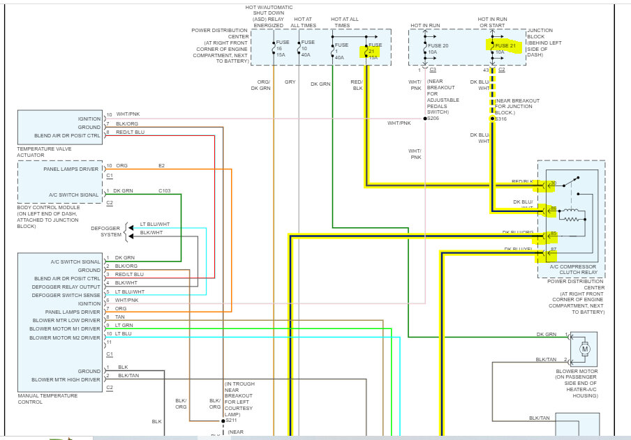

Okay, I attached the wiring schematic below for the circuit. Pin 30 should have battery voltage at all times. Pin 86 should only have power when the key is in the run or start position.
Pin 87 is power out to the compressor clutch, so it won't have power until the relay is actuated.
Pin 85 is a the ground path provided by the PCM to complete the primary side of the relay which then closes the switch on the secondary side powering the clutch.
So, confirm power is where it needs to be. Then, take your test light and place the alligator clip to the battery positive. Then, with the AC requested on and the key in the run position, probe pin 85. If the PCM is providing a ground path, the test light should turn on.
Let me know what you find. Also, here is a link that you may find helpful:

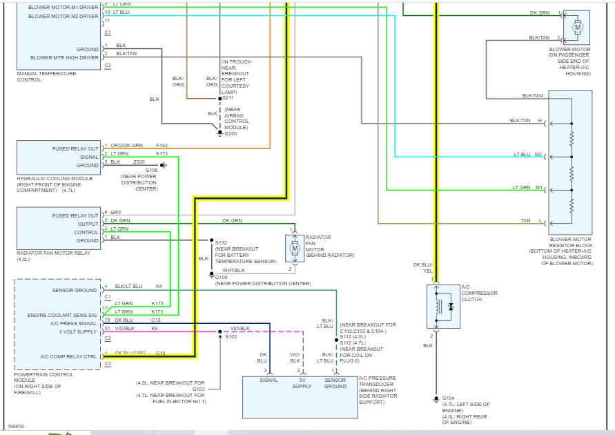

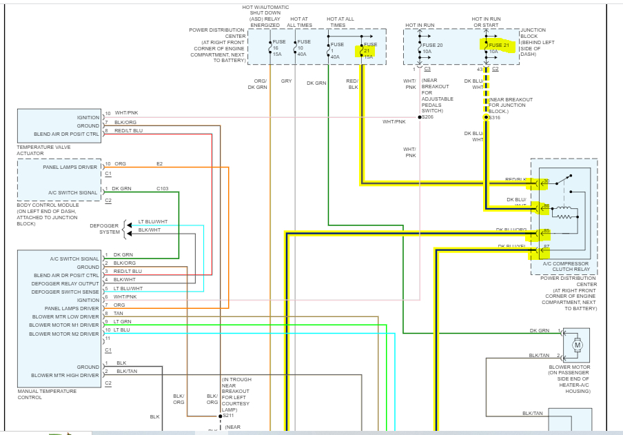

See pics below. Note: I had to cut the schematic in half to make it readable. I did overlap the two and highlighted the related wiring.

Pin 85 provides the ground path to the PCM (AC relay circuit). Does pin 86 have battery voltage? Have you switched the relay with a different one?
Pin 85 shouldn't supply power. It is the ground path to complete the primary relay circuit. Do you mean the light is very dim with the relay installed or are you checking it with the test lamp to the positive terminal and probing pin 85? If that is how you are doing it, the light should be bright with the key on, and the AC requested.
If it is still dim, either we have a faulty connector at the PCM, a damaged wire, or there is a problem with the PCM.
Confirm that is what you are doing and found for me.
