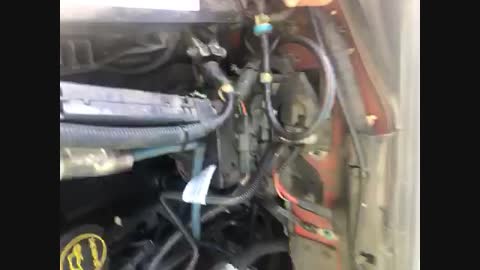

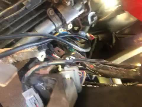

Cancel everything I have said up to this point I have figured out the problem! Under the driver's side footwell there is a part that I have found to be the culprit. I guess it would be called the defrost mode actuator. It controls when the defrost/A/C is engaged. With it being up, it’s defrost (it is automatically up). When I pull the metal piece down it switches to the panels and vice versa. I am going to check to see if a fuse is blown to it or even better if it has power at all.

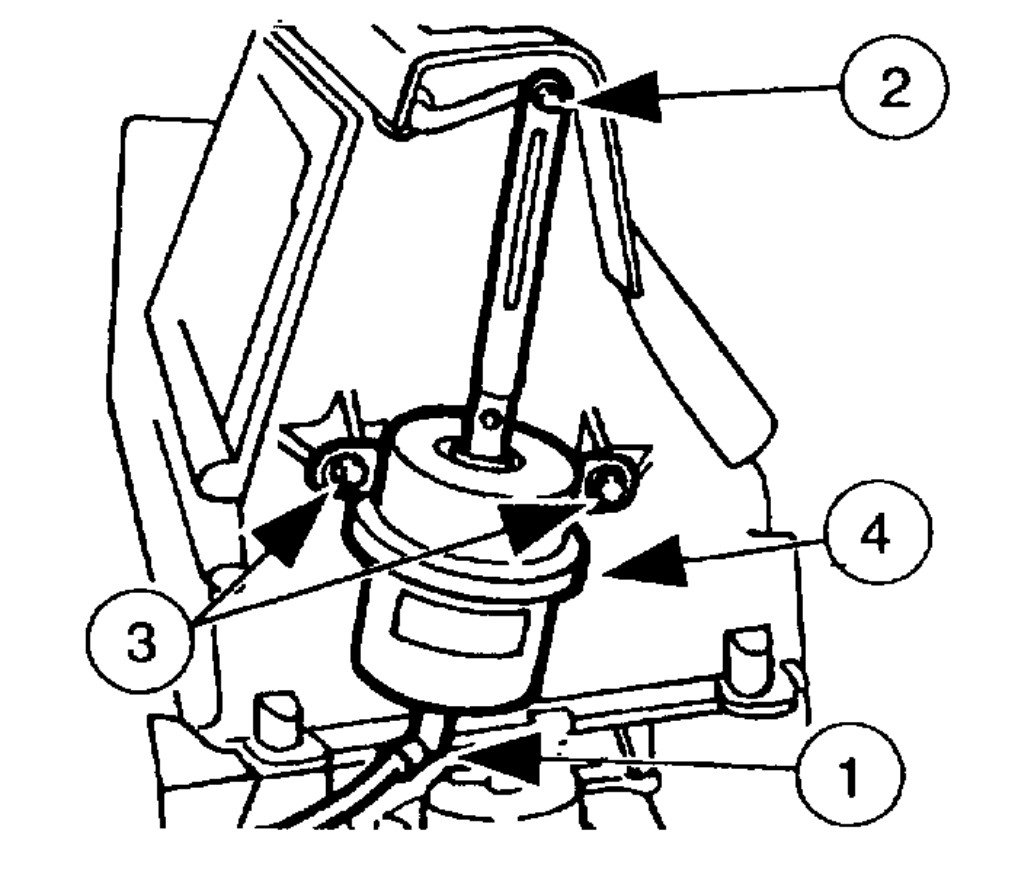

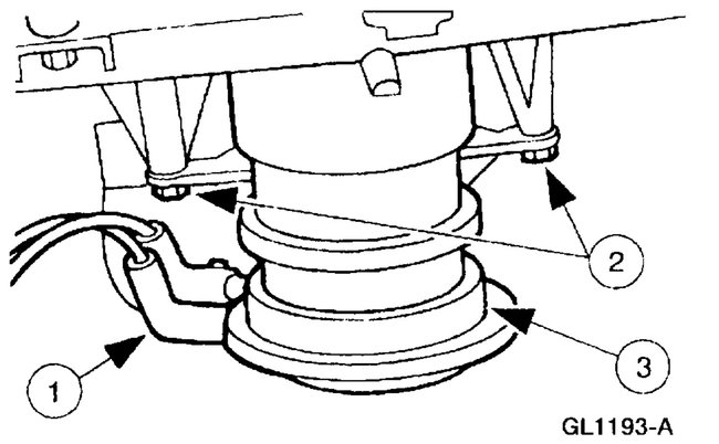

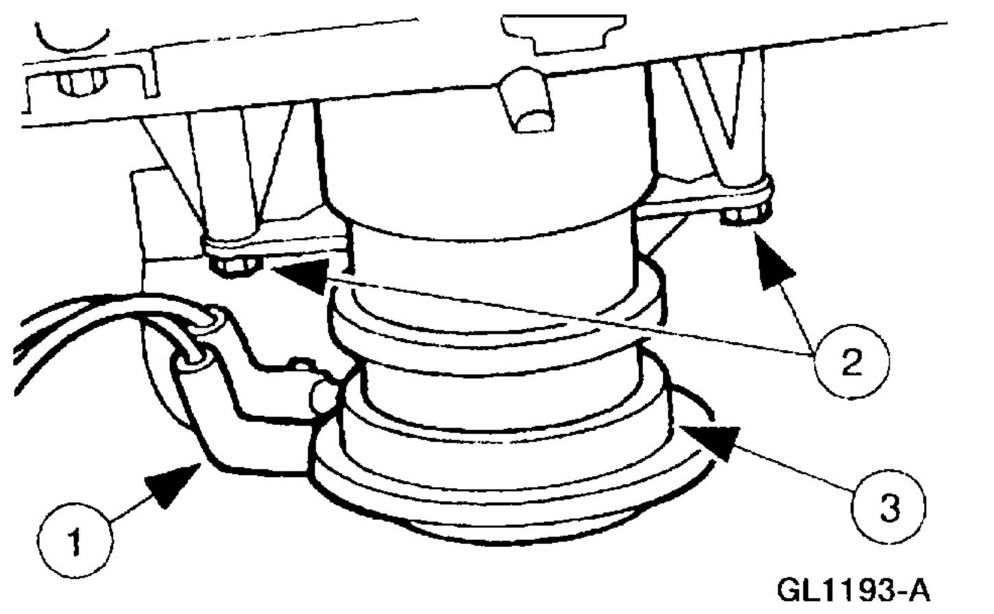

Think you could take a picture of it and post it, it doesn't sound like something on an F series, unless it is the vacuum motor linkage and unhooked from the actual vacuum motor. Does it resemble any of the images?
Apr 7, 2022 at 1:55 AM
SKEPTICHAN
  • 19 POSTS
Yes, it’s the middle image.

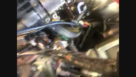

SKEPTICHAN
  • 19 POSTS
I tried to upload a video but I’m not sure that it actually did. Can you see the video?
Apr 7, 2022 at 3:58 AM
SKEPTICHAN
  • 19 POSTS
Hopefully this will send.
Apr 7, 2022 at 4:03 AM
STEVE W.
  • 15,351 POSTS

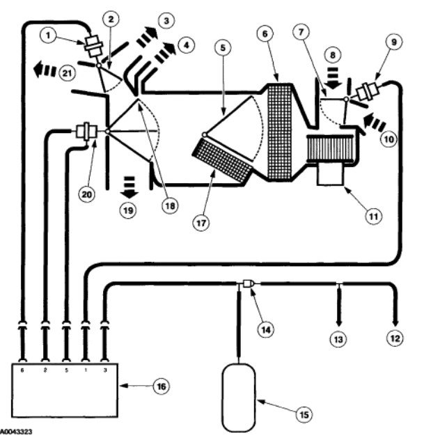

Okay, the middle one is the panel/defrost motor. It is item 1 in the diagram. Should have a single vacuum line that you found already. Stick a chunk of hose on it and apply a vacuum (even sucking the hose like a straw should work) and see if the vacuum motor works, it should pull the door with it. If it works, then the issue is between it and the control head. If it doesn't move when you apply a vacuum to it the diaphragm inside is bad and you can replace it.
Thanks for the video, I was thinking you meant it was something down at the floor level and was like HMM Ford doesn't have anything there. I miss the days of cable controls....

Just tried the sucking through the hose and the defrost motor is definitely good.

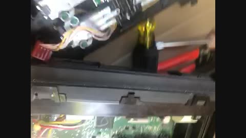

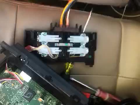

This might help too.
Apr 7, 2022 at 5:07 AM
STEVE W.
  • 15,351 POSTS

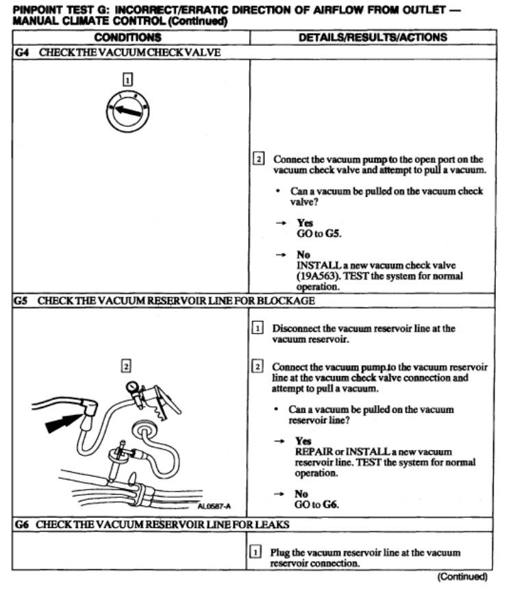

Okay, if it works the issue is that either it's not being controlled through the head or if that lever comes off that easy it shouldn't, should stay on better.

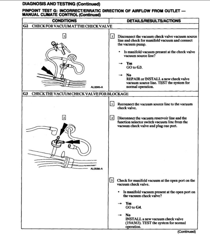

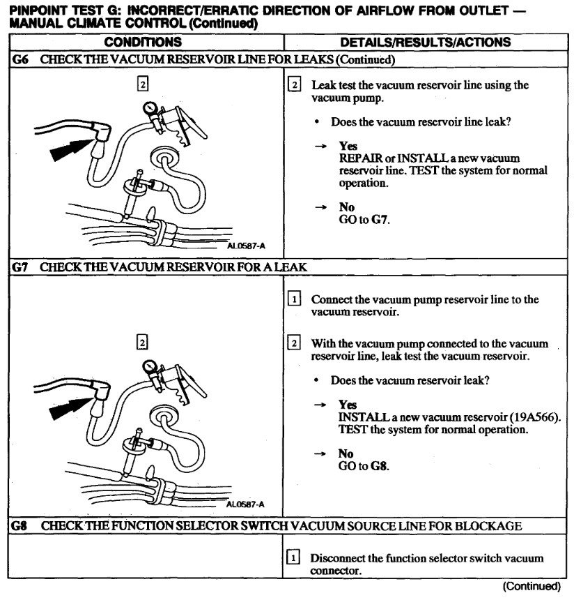

You mentioned that it did seem to work when going downhill? That would also be the time of the highest vacuum levels in the engine so a leak might have been overcome during that time. It could also be the directional check valve has a tear in it and is blocking vacuum one way but not the other as you select the dash vents. Attached are the tests for it.

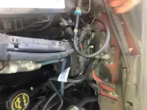

SKEPTICHAN
  • 19 POSTS
Might have found the main problem lmk.
Apr 7, 2022 at 5:15 AM
STEVE W.
  • 15,351 POSTS
Looks like the ring you installed might be bad. Wouldn't be the first time a part was bad out of the box these days. I know Brian myself. Great guy and knows the blue oval really well.
A bad seal could act the way it was with the higher vacuum. Check that the slider is actually seating properly under the retainer, It doesn't take much of a gap to cause a leak when you're dealing with vacuum.
Apr 7, 2022 at 6:03 AM
SKEPTICHAN
  • 19 POSTS

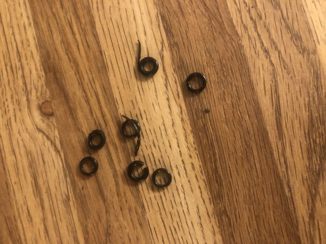

Took it out and sure enough the brand-new o ring did tear some. Could be from rubbing or just cheap. I’m putting it all back together to see if it works right now.

Sorry for the extended update but these are all the o rings that I have been going through. Finally got one to work though! Now the door actually vacuums down, and A/C goes through panels. Thanks for the help, I am grateful.

OOF, looks like they might not be the best. Normally for controls like those I buy a bunch of the correct ones, then apply a thin coat of silicone based grease, just enough to make them hard to hold. That way they can slip easily. But then you run the risk of them twisting if they don't fit the board real tight. But noy that you have it working sounds like you found the problem. Great job. If you ever need other help just come on back.
