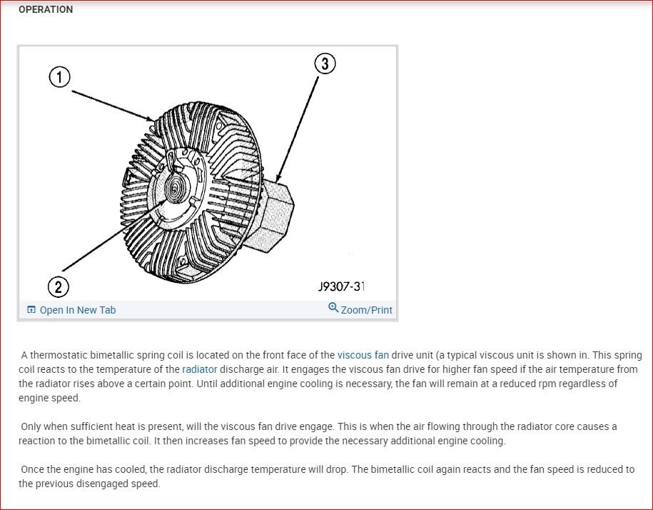

Hi Eismane,
Any time the AC blows colder when driving down the road, that normally means the radiator fan is not operating properly.
You have a viscous fan clutch which have been known to fail. When they fail the fan cannot engage its top speed. It just spins at the slower speed and does not cool the Freon like it needs to. Then when driving faster, the Freon is cooled and your AC blows cooler.
