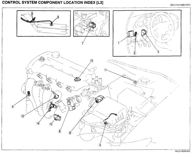

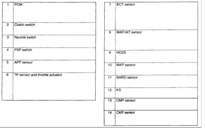

03 Mazda 6 2.3 start to crank engine. Tries to catch for one or two seconds then it just cranks. Turn key off try agian. Does the same thing. Checked fuel pressure, it is steady at 36 PSI while cranking. Replaced crank sensor, cam sensor and the ECU. No change. Put in new plugs coil and wires. No change. Car tries to start but just wont get there.

The fuel pressure spec for that car is 55 to 65PSI so you don't have enough pressure. You also need to test for spark and injector pulse.

This sounds like you have a crankshaft angle sensor that is going out. Here is a guide to show you what you are in for when changing the sensor out.
