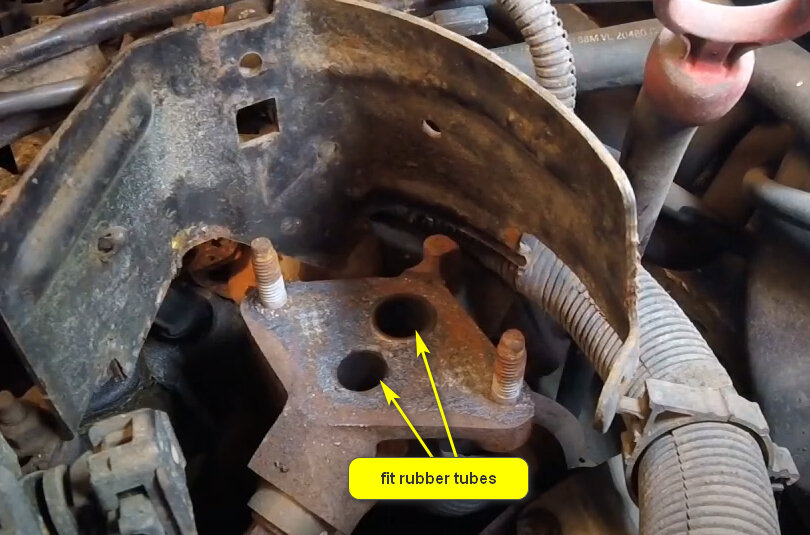

Regarding the P0401 code you still might have a restriction in one or both EGR ports
A quick way to check the EGR passages on the 3800 engine is to take off the EGR valve. Get two long rubber hoses that will fit snugly into the EGR ports. Have the hoses long enough so that you can hold them as you are sitting in the driver's seat. What you will be doing is feeling suction in one hose and air pressure coming out of the other hose which tells you the EGR passages are clear. Take one hose and cover the opening with your thumb. Start the car. If you feel suction, that port is clear. Shut the car off. Now, get the other hose. Cover the hole of the other hose with your thumb. Start the car, with the engine running, feel for air pressure coming out of the hose. If you felt air pressure from one hose and suction from the other hose, your EGR passages are clear.

1. I did the tube test for the two EGR passages and both are clear. One produces suction, and the other blows engine exhaust, and both increase with RPM.
2. I have no means to command the EGR valve Full On, as you suggested.
