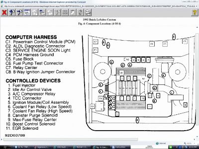

I said EGR system, not valve. All GM's of that vintage and newer have some type of exhaust gas recirculation.
Thursday, January 24th, 2008 AT 9:38 PM
MERLIN2021
  • 17,250 POSTS
Check #11!!!
https://www.2carpros.com/forum/automotive_pictures/62217_9238_1.jpg
Thursday, January 24th, 2008 AT 9:42 PM
