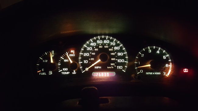

Didn't have opportunity to check voltage yet. On commute to work today engine temp increasing getting hotter. Here's what it got to by my arrival. See pic. Fan motor/thermostat??
Sep 25, 2016 at 6:48 PM
SATURNTECH9
  • 30,869 POSTS
I can't blow up the picture is the car running really hot?
Sep 26, 2016 at 12:06 AM
KEVIN LEAMER
  • 16 POSTS
Almost 200 degrees warning light came on.
Sep 26, 2016 at 12:08 AM
SATURNTECH9
  • 30,869 POSTS
200 degrees isn't hot for that car I wonder which warning light came on?
