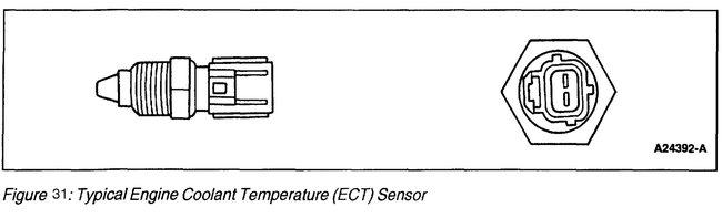

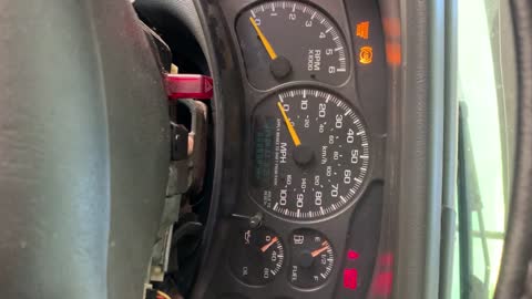

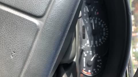

When driving on the highway At 65, I felt that the truck started acting weird.the temperature gauge started dropping and the truck started stalling. So I had to rev the gas to go back to normal. I would go through a bump and it would get better. After 20 minutes on the road The same problem.

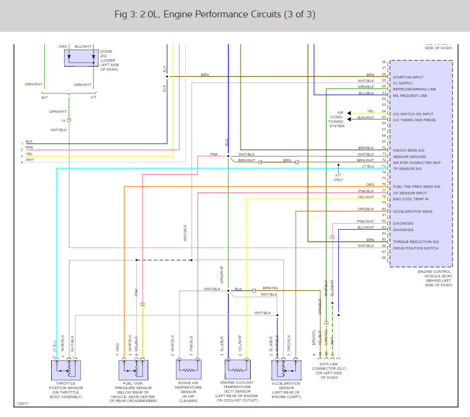

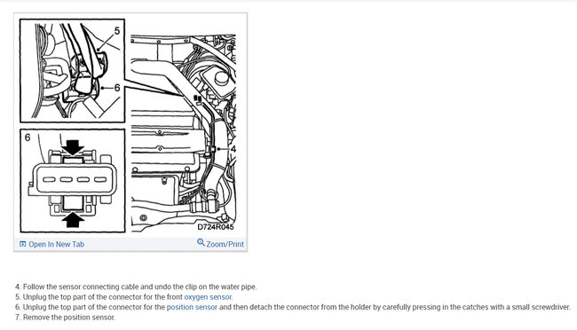

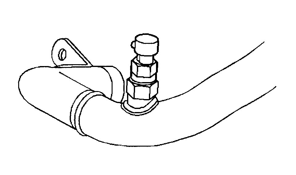

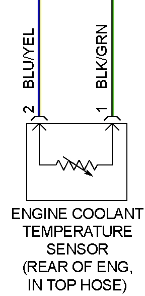

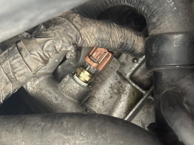

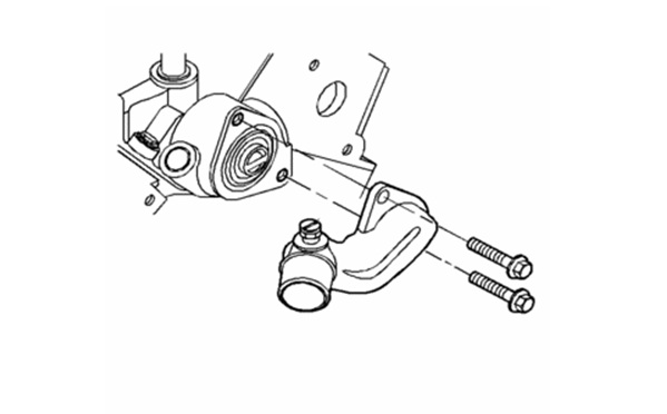

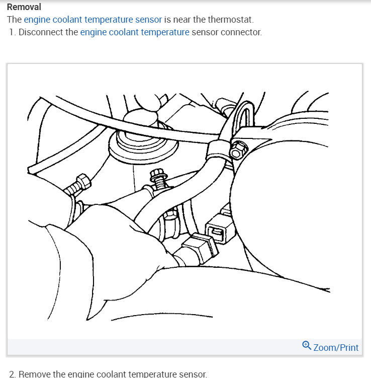

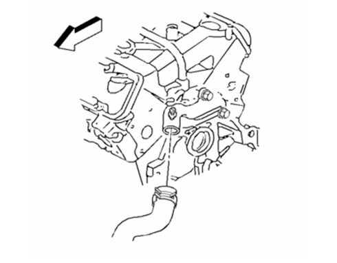

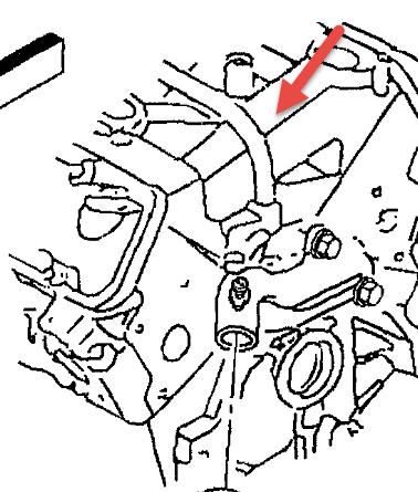

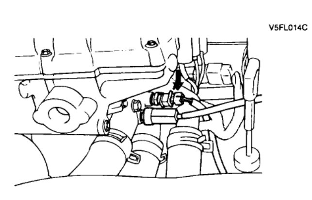

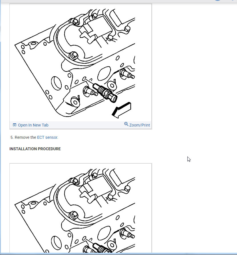

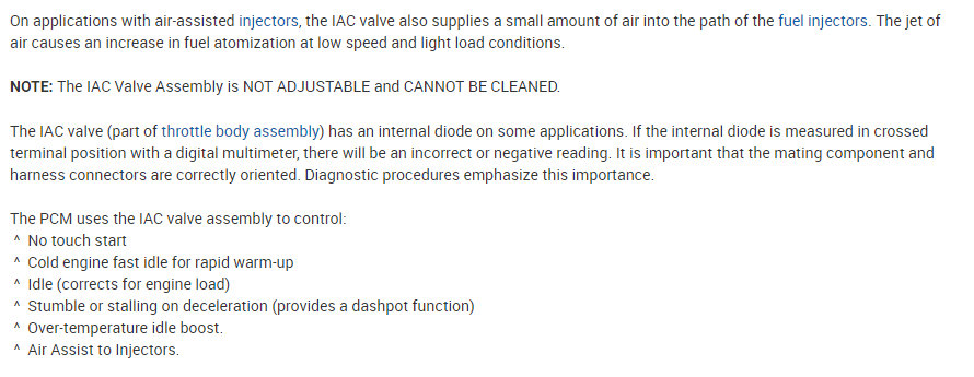

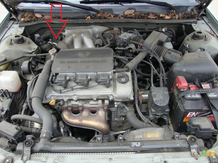

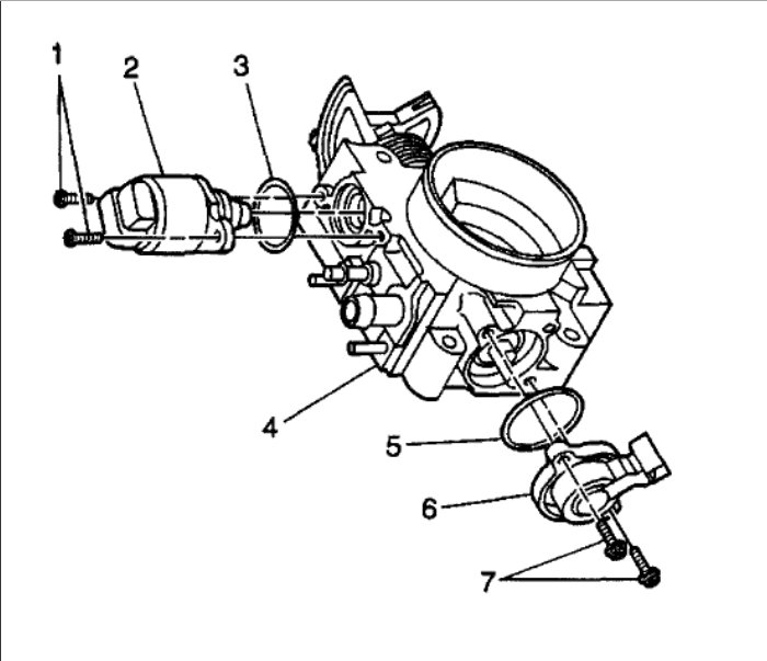

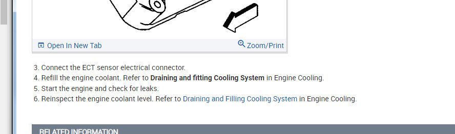

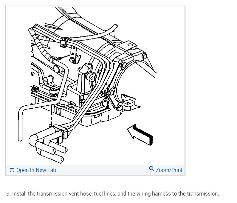

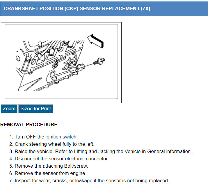

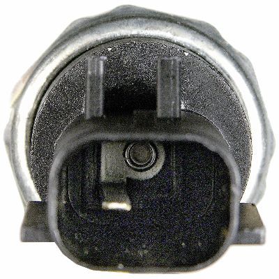

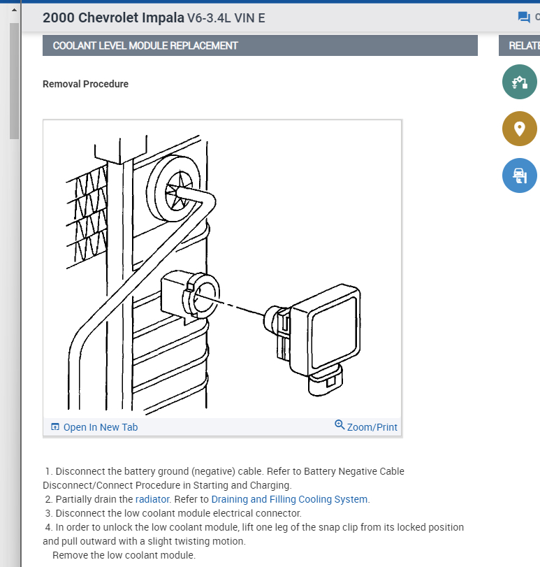

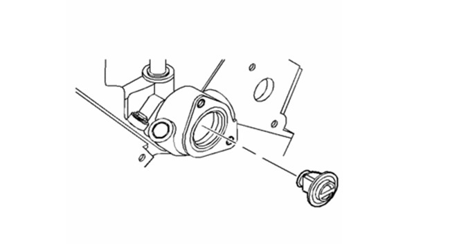

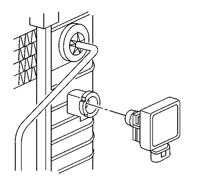

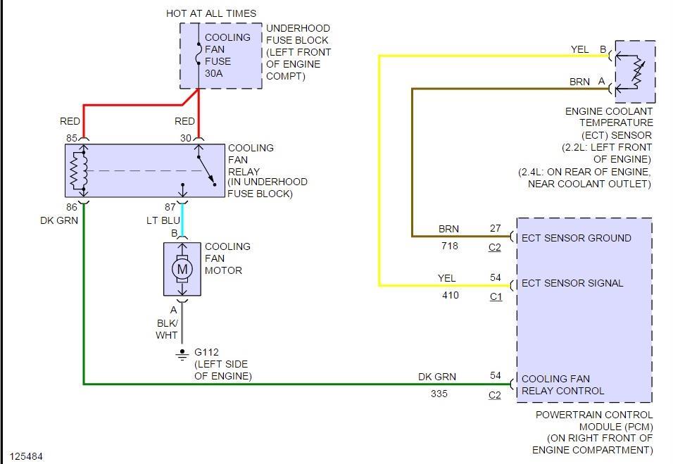

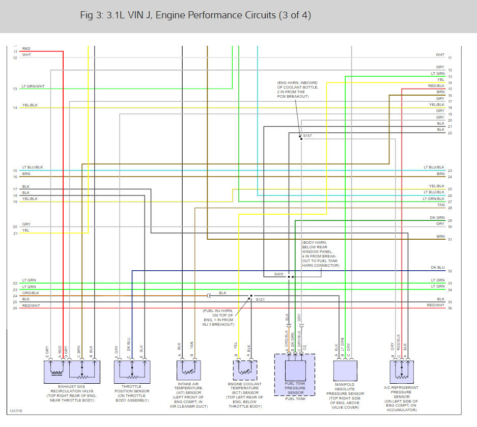

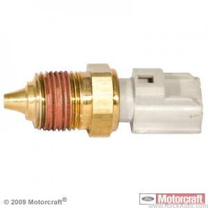

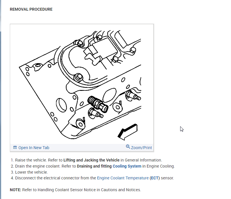

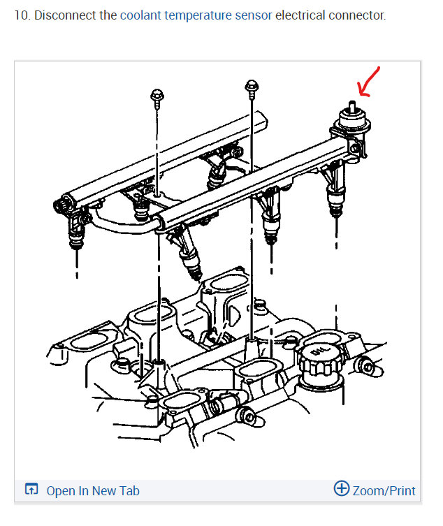

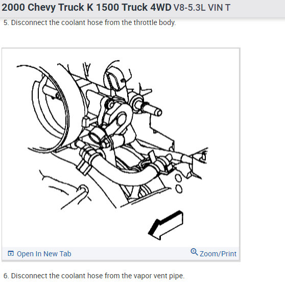

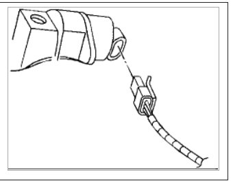

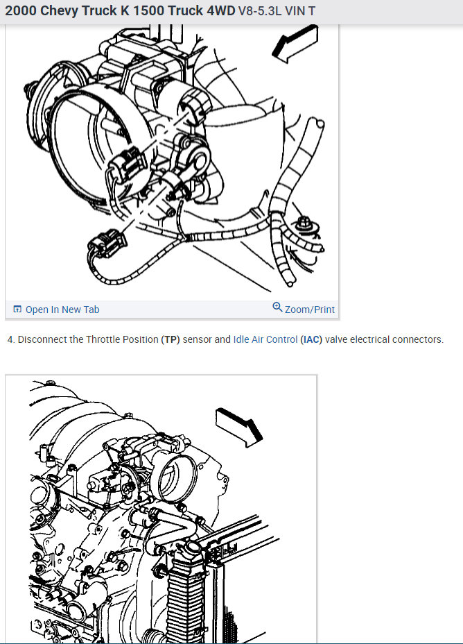

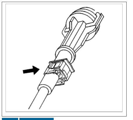

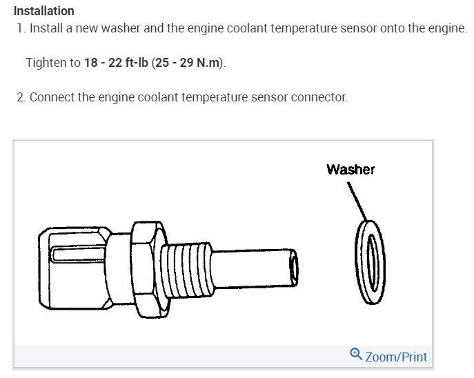

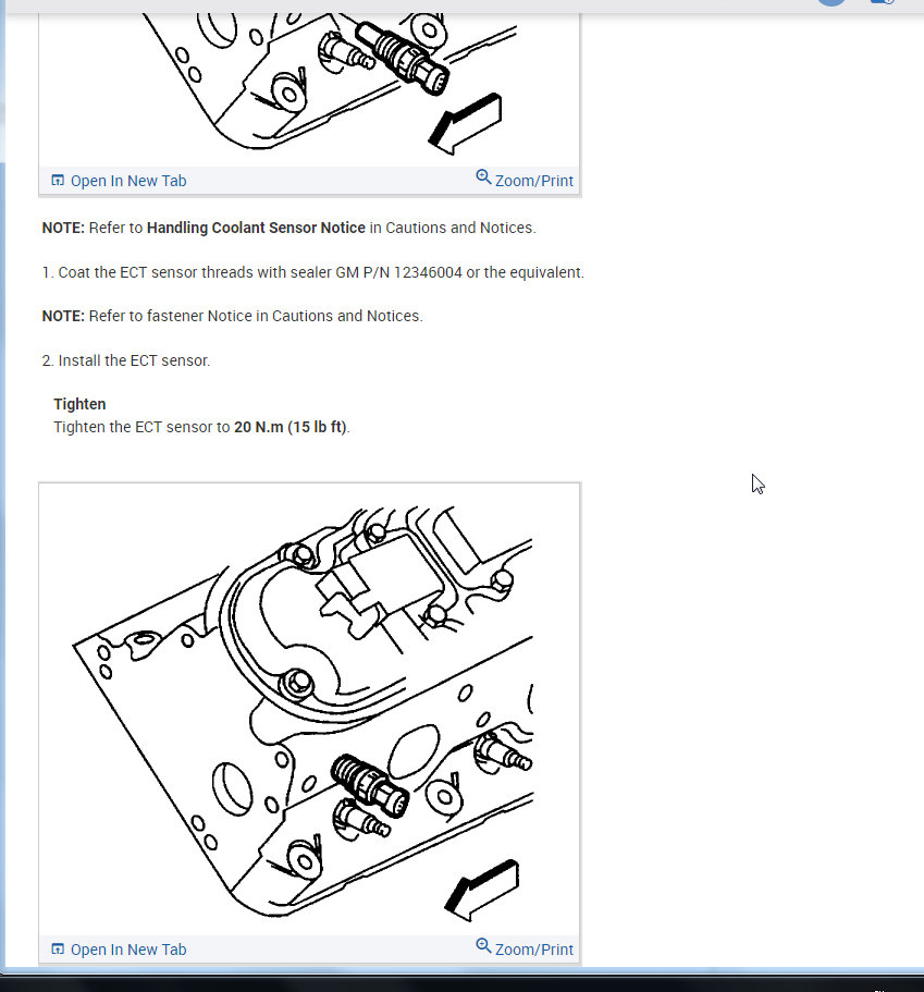

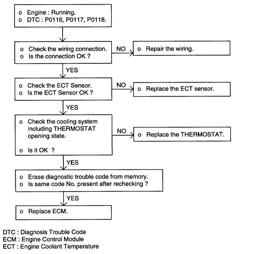

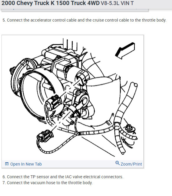

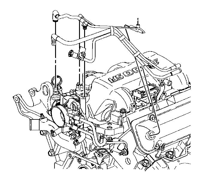

This sounds like the temp sensor is failing or you have a connection issue.
If the cooling temp drops the PCM is going to alter the air fuel ratio and this could cause a stall or poor running condition.
https://www.2carpros.com/articles/symptoms-of-a-bad-coolant-temperature-sensor
https://www.2carpros.com/articles/coolant-temperature-sensor-cts-replacement

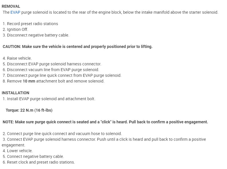

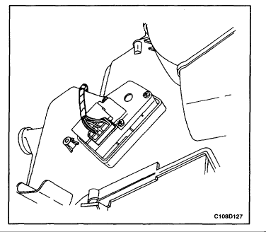

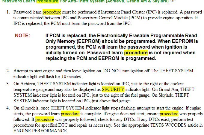

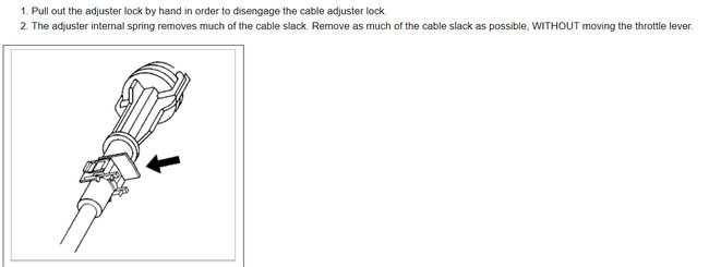

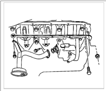

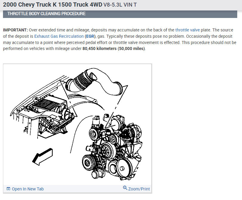

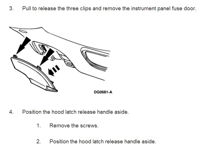

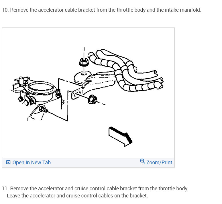

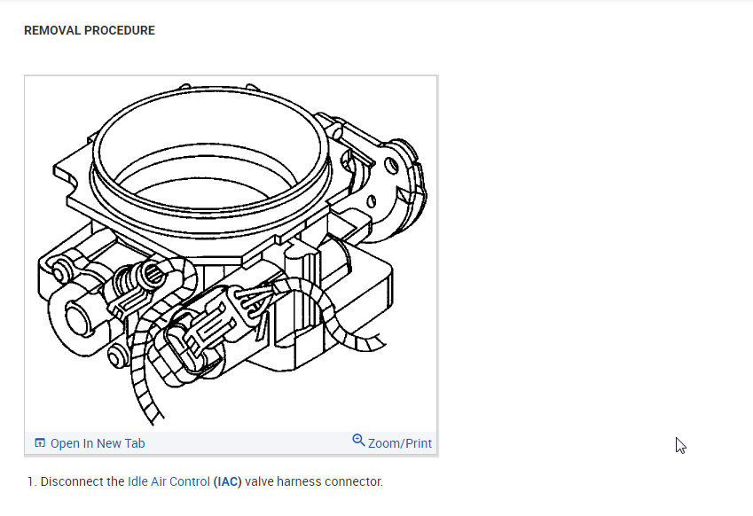

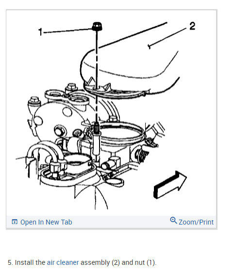

If nothing turns up, I would replace the sensor and retest to see if this happens again. When you have it apart, check the connector terminals and make sure they are clean and tight.
I attached the info below on how to do this. Please run through this and let us know what happens.
Thanks
