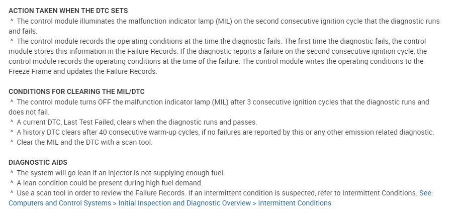

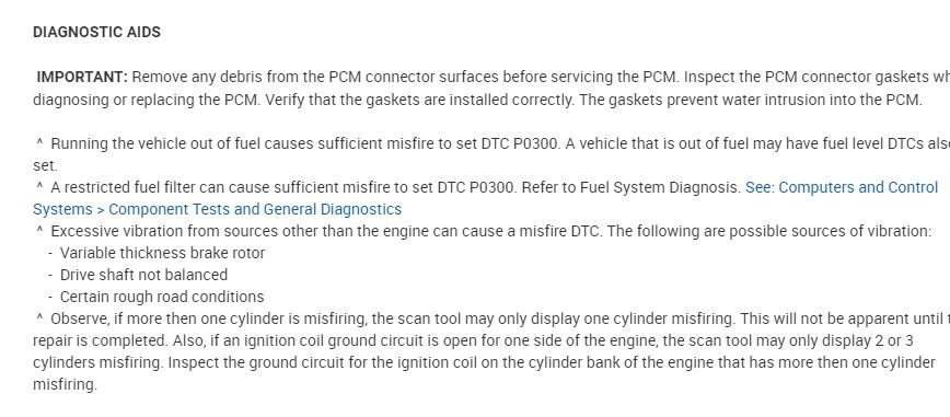

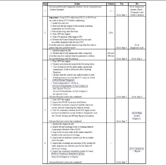

my truck on morning starts the idle is rough once it idles for about 5 minutes it's still some what rough.
once warm the rest of the day even after sitting for 8 hours it idles and runs fine. I have replace all oxygen sensors, wires, spark plugs, fuel filter and cleaned out my MAS. sometimes my check engine light comes on the code is ether P- 171/174/0300 but not all the time. some say intake gasket others say check fuel pump/fuel regulator. but why does it idles rough for a little while and then run fine the rest of the day?
Feb 12, 2020 at 1:53 AM
Good afternoon,

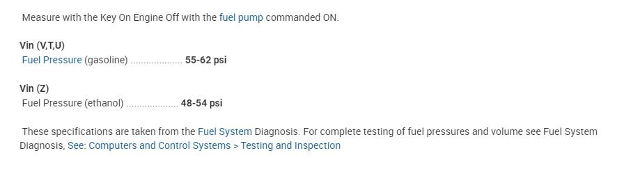

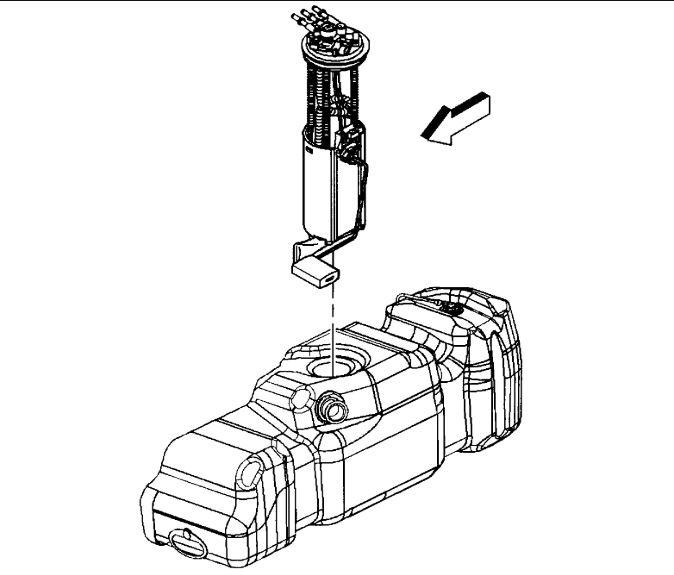

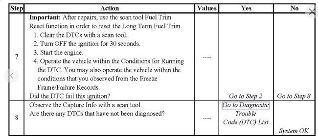

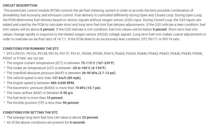

This sounds like a fuel pump issue. Low fuel pressure will cause the rough idle and the lean codes.
https://www.2carpros.com/articles/repair-lean-mixture-codes-p0171-or-p0174-on-some-manufacturers
The most common cause is low fuel pressure. I attached the flow chart as well as the pressure spec for you. You can rent a pressure tester at a parts store.

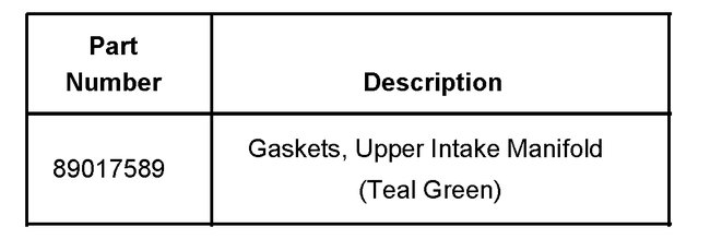

Replace the upper intake manifold gaskets with the teal green gasket material, P/N 89017589.
Important:
  Do not replace the upper intake manifold gaskets with the original orange gasket material, P/N 17113557.

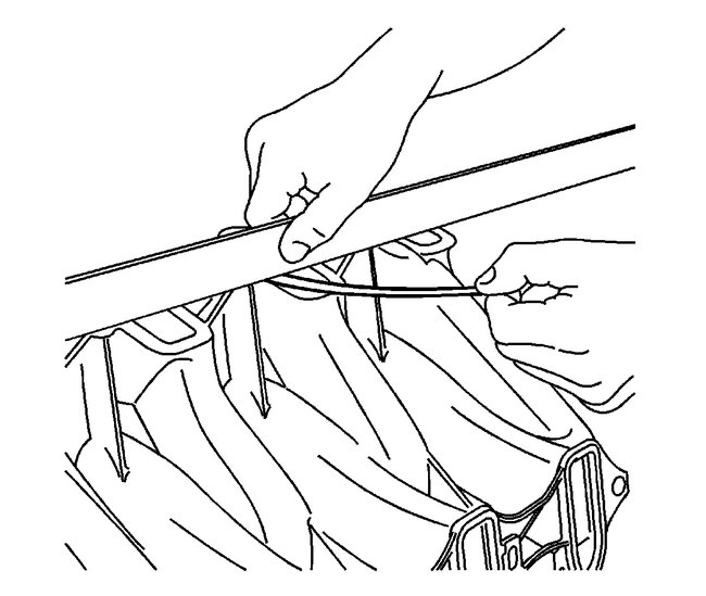

Inspect Intake Manifold to Cylinder head Deck for Warpage
Important:
  The intake plenum should also be checked for excessive warpage that may cause an uneven clamping pressure of the seal. If the plenum is found to be warped it will need to be replaced. Service Information states, "An intake manifold with warpage in excess of 3 mm (0.118 in) over a 200 mm (7.87 in) area should be replaced." Intake warpage is measured at the gasket sealing surfaces and should be measured within a 200 mm (7.87 in) area. This measurement is across only two of the intake runner port openings. Measurements taken across the entire distance of all four intake runner ports will lead to unnecessary manifold replacements.
Important:
  Measurements taken across the entire distance of all four intake runner ports will lead to unnecessary intake manifold replacements.
1.  Locate a straight edge across the intake manifold cylinder head deck surface. Position the straight edge across two runner port openings.
2.  Insert a feeler gauge between the intake manifold and the straight edge. An intake manifold with warpage in excess of 3 mm (0.118 in) over a 200 mm (7.87 in) area is warped and should be replaced. Do not replace intake manifolds with warpage that measures less than 3 mm (0.118 in) over a 200 mm (7.87 in).
