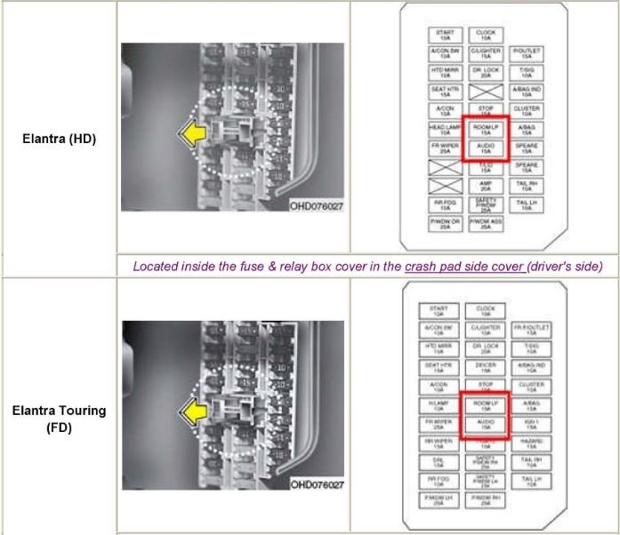

The other option would be to simply pull the memory fuse up in the drivers side fuse box at the end of the dash. This is the method most cars are shipped with and when parked on a dealer lot are set up in. It shuts off the interior lighting and many memory items. However depending on the options your car has pulling the fuse will require some items to be reset when you plug the fuse back in. For your car these items are the Sunroof, Trip computer, Automatic climate control system, Clock, Audio system, and the Auto windows. The fuse location is shown below and is in the maintenance section of the owners manual. The reset procedures are in the owners manual in chapter 4 and are also included in this post.
