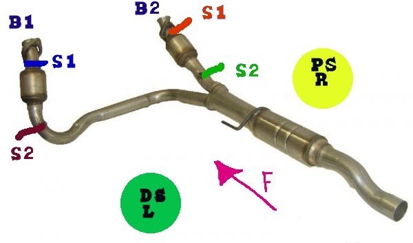

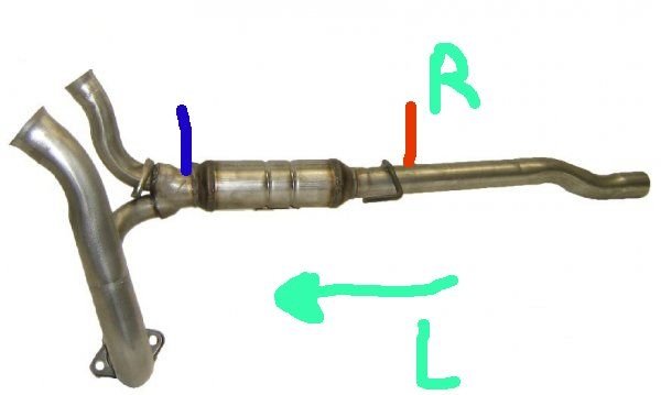

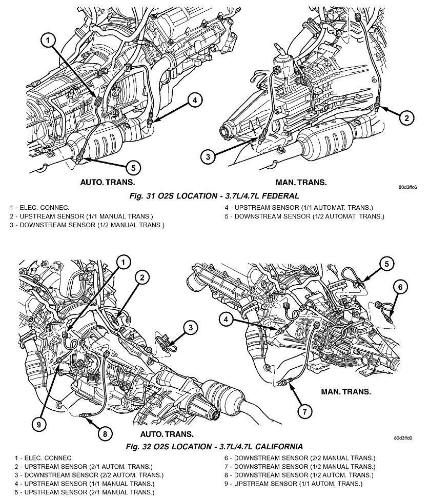

Most auto "directions" are given from the drivers seat not in front of the vehicle.
So right hand would be from the drivers seat.
On your truck (if it has California Emissions) you have a total of four O2 sensors.
As PRP stated Bank one is always where number one cylinder is. That can be different depending on the make year model and engine in a vehicle.
Now if you have a Federal emissions system (depends on where the truck was originally bought) The above still applies but you would only have two sensors.
They are still S1 and S2.
Now if I understand your response above you were facing the engine and replaced Bank 2 Sensor 1.
Hope this helps.

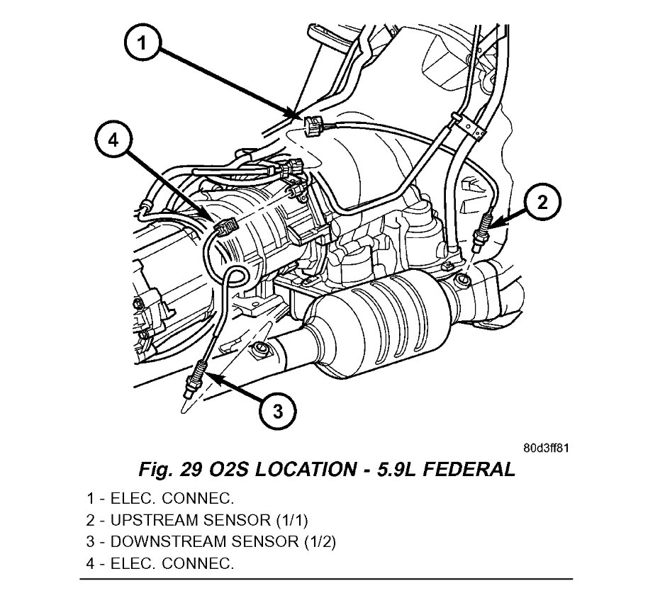

PATENTED_REPAIR_PRO
  • 1,853 POSTS
Did you find the 2/2 o2 sensor yet?
Here are both the Federal and California diagram:

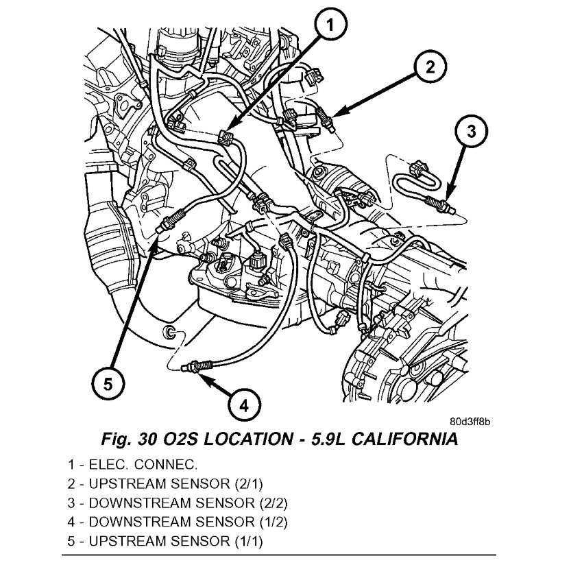

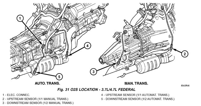

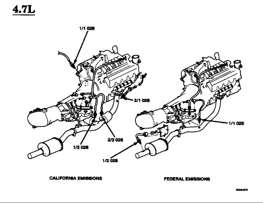

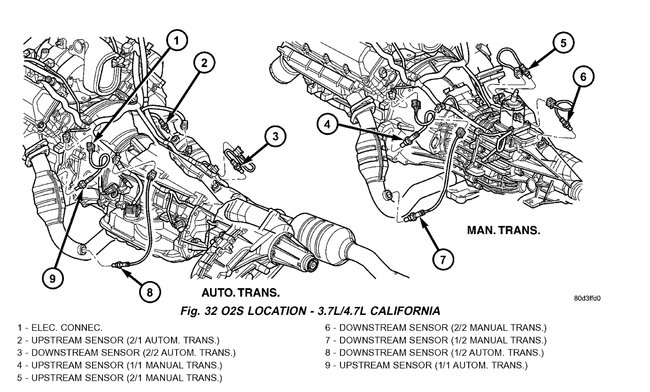

I am having trouble looking for a diagram of the o2 sensors for the truck listed above 1500. Because I need to replace Bank 1 Sensor 1 and Bank 2 Sensor 2. If someone can please help.
Saturday, May 8th, 2021 AT 12:32 PM (Merged)
CARADIODOC
  • 34,365 POSTS
You didn't list the engine size, so here are the drawings for every variable. You'll have to pick the right one for your truck. Note too there's a difference for trucks with the California emissions package.
