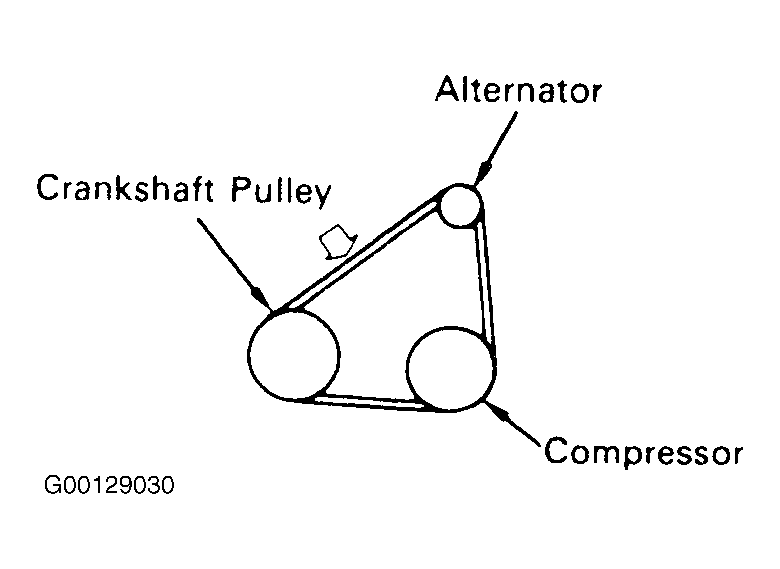

1993 Toyota Cab & Chassis — Drive belt routing diagram 1
Drive belt routing diagram 1 — select to enlarge

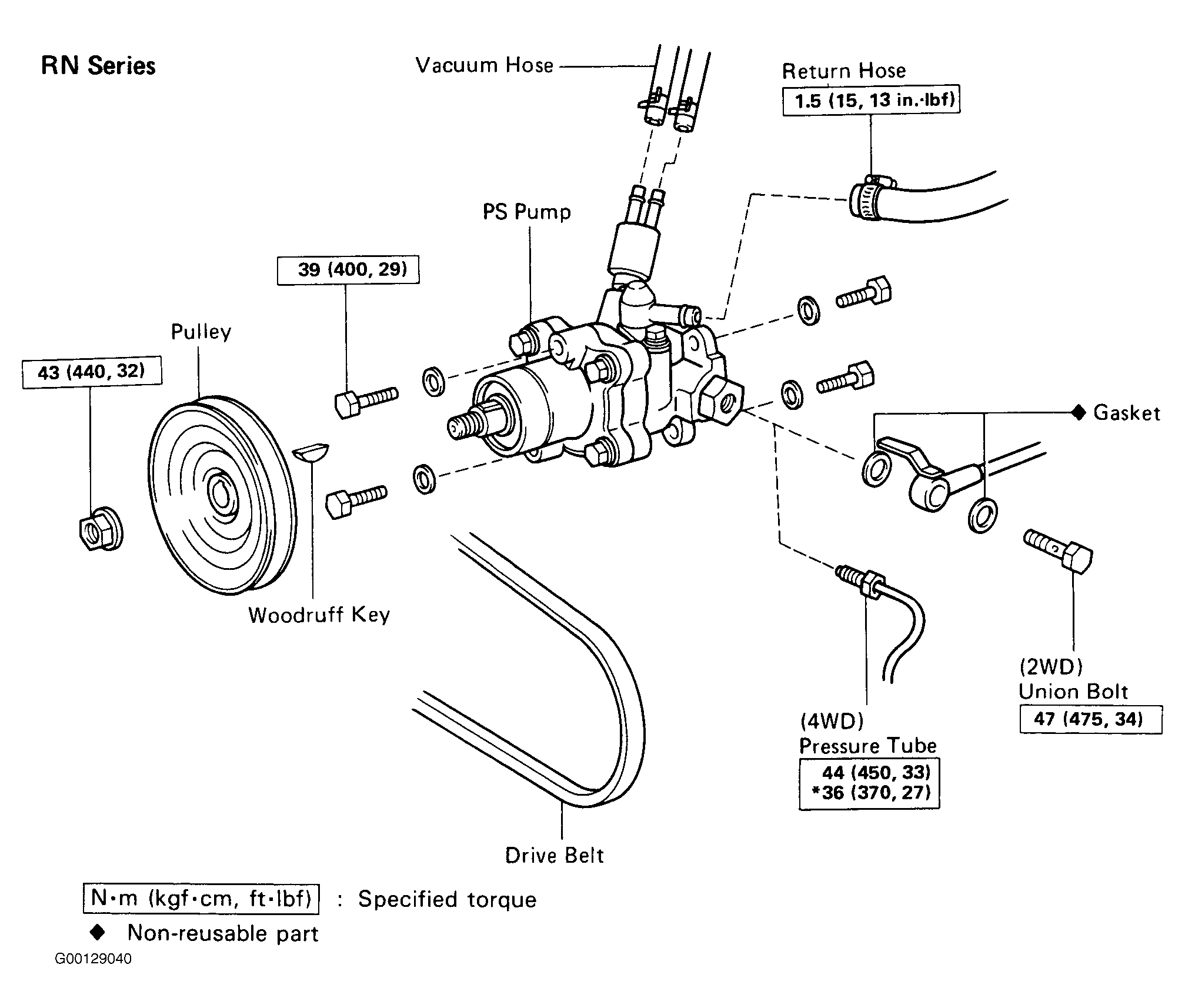

1993 Toyota Cab & Chassis — Drive belt routing diagram 2
Drive belt routing diagram 2 — select to enlarge

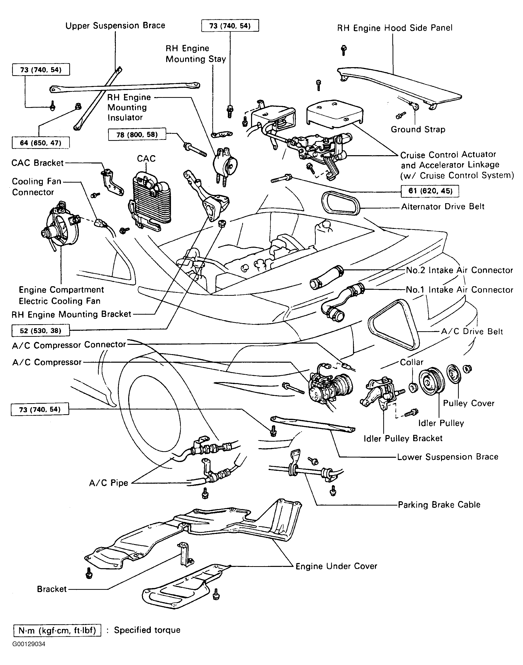

1993 Toyota Cab & Chassis — Drive belt routing diagram 3
Drive belt routing diagram 3 — select to enlarge

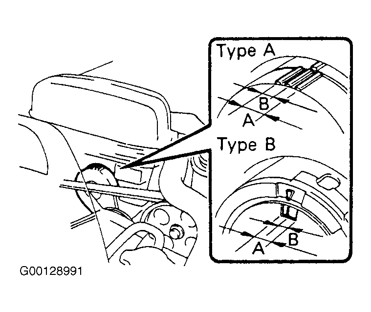

1993 Toyota Cab & Chassis — Drive belt routing diagram 4
Drive belt routing diagram 4 — select to enlarge

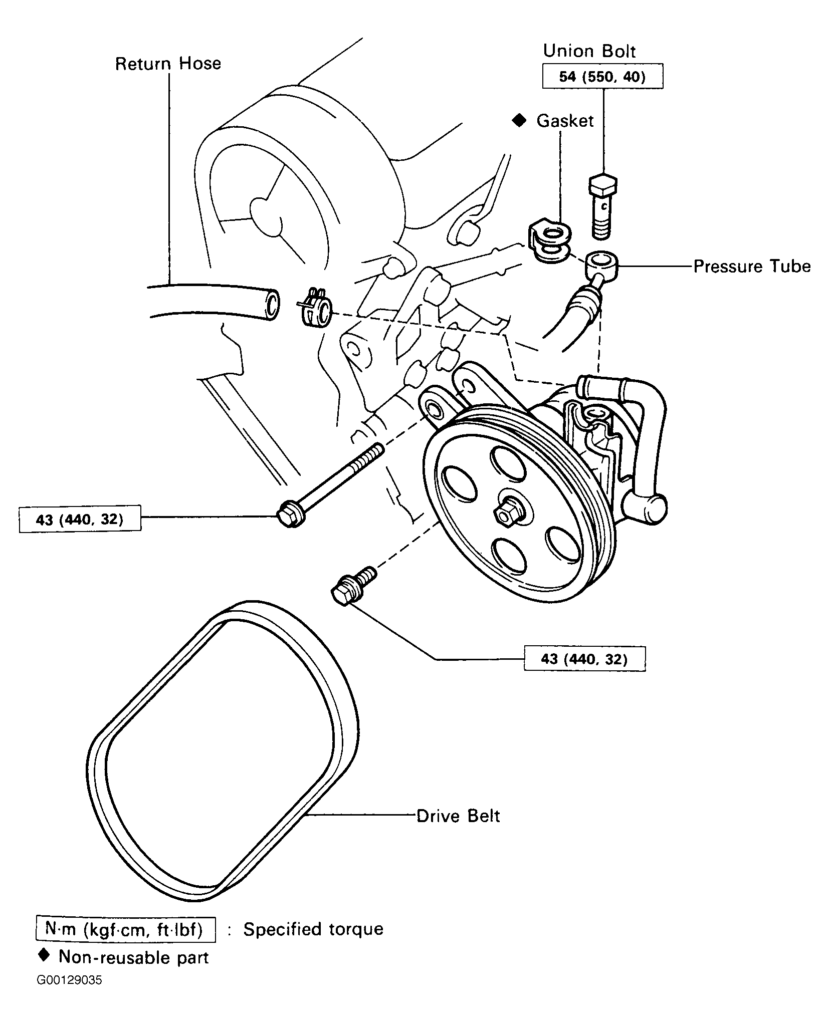

1993 Toyota Cab & Chassis — Drive belt routing diagram 5
Drive belt routing diagram 5 — select to enlarge

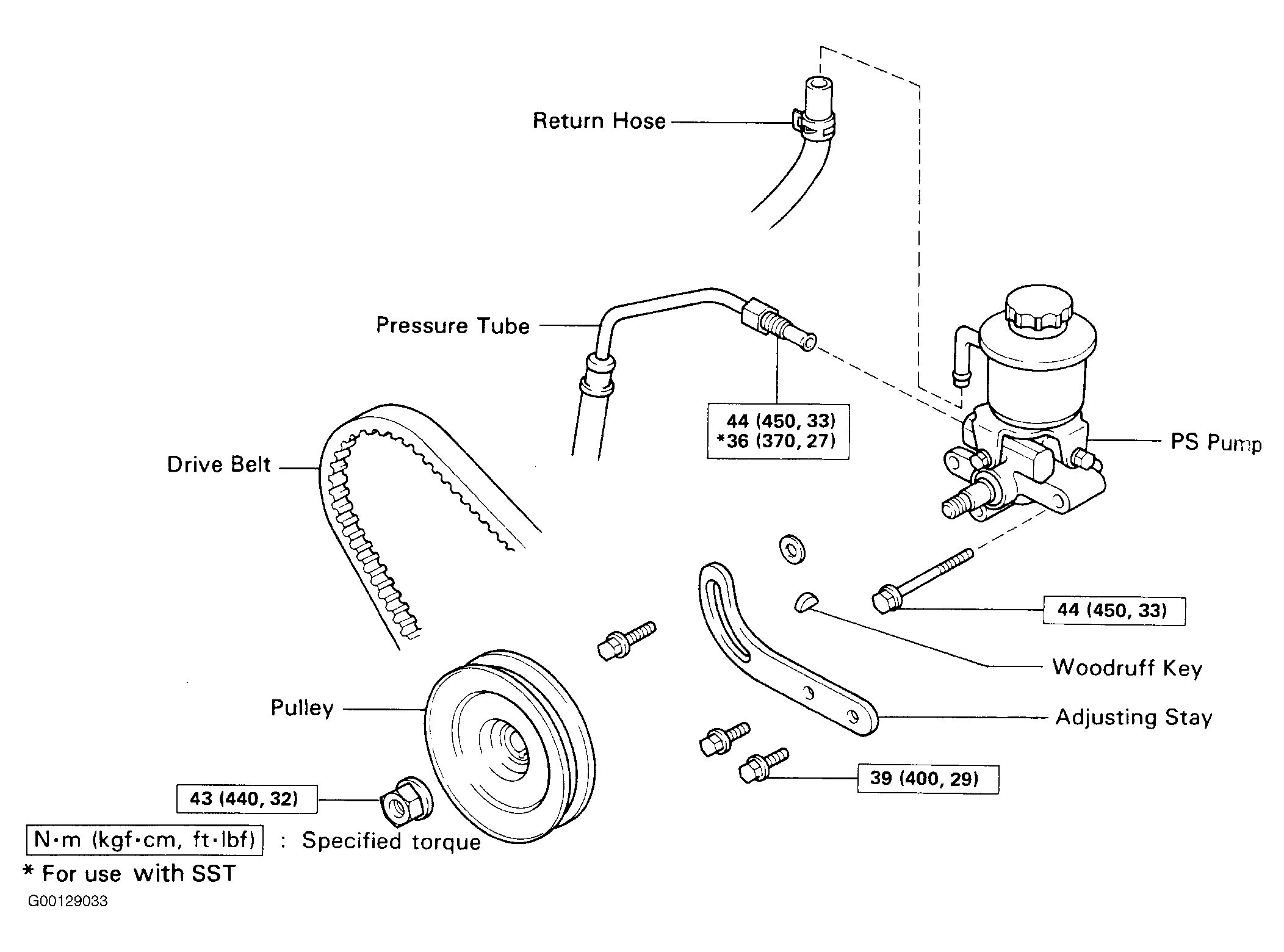

1993 Toyota Cab & Chassis — Drive belt routing diagram 6
Drive belt routing diagram 6 — select to enlarge
