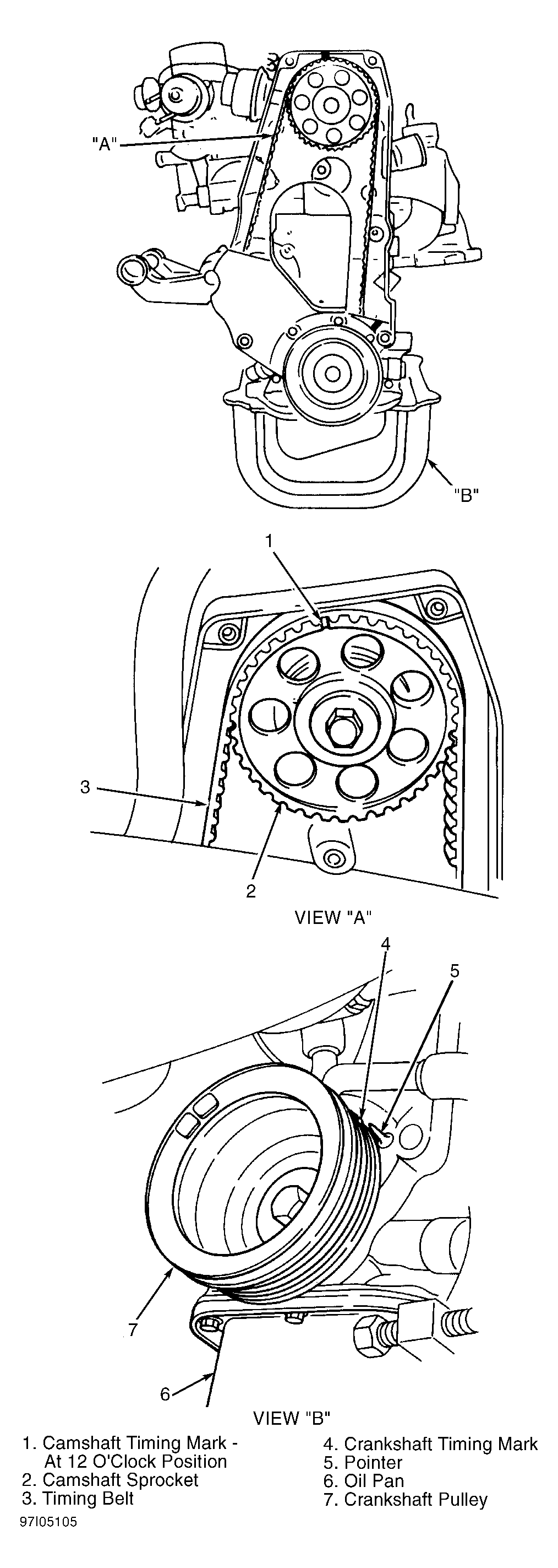

1990 Pontiac LeMans — Timing belt diagram 1
Timing belt diagram 1 — select to enlarge
