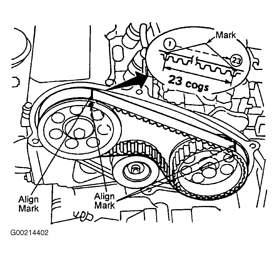

1985 Nissan Sentra — Timing belt diagram 1
Timing belt diagram 1 — select to enlarge
