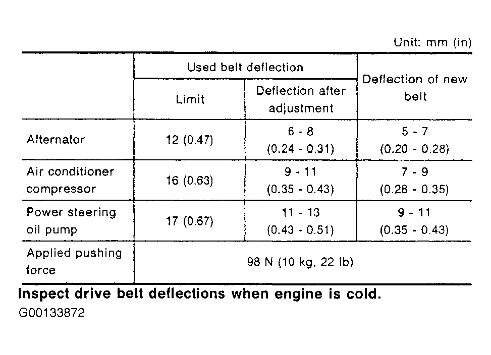

1992 Nissan NX — Drive belt routing diagram 1
Drive belt routing diagram 1 — select to enlarge

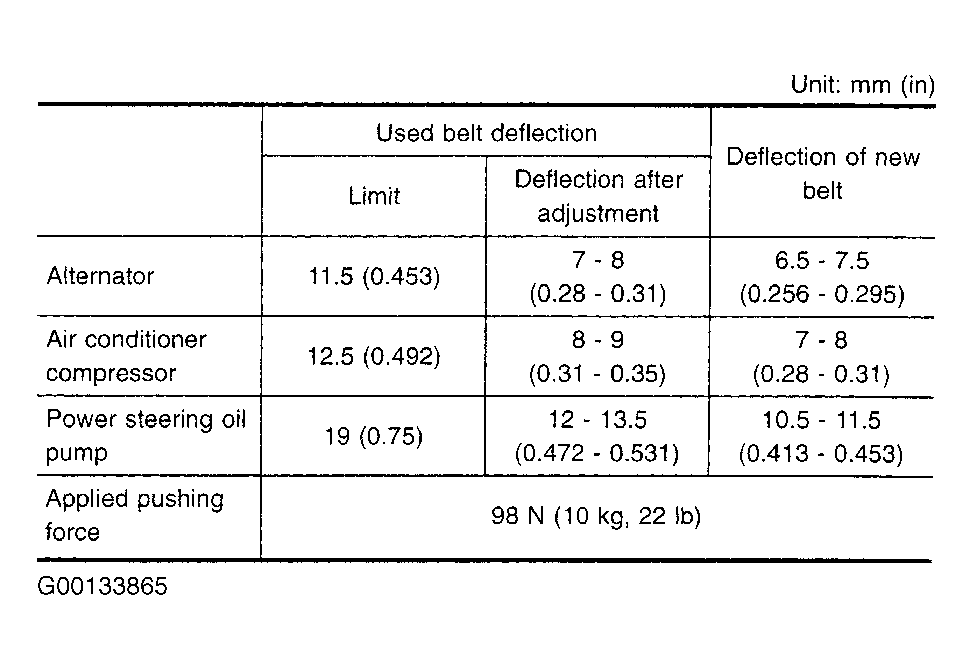

1992 Nissan NX — Drive belt routing diagram 2
Drive belt routing diagram 2 — select to enlarge

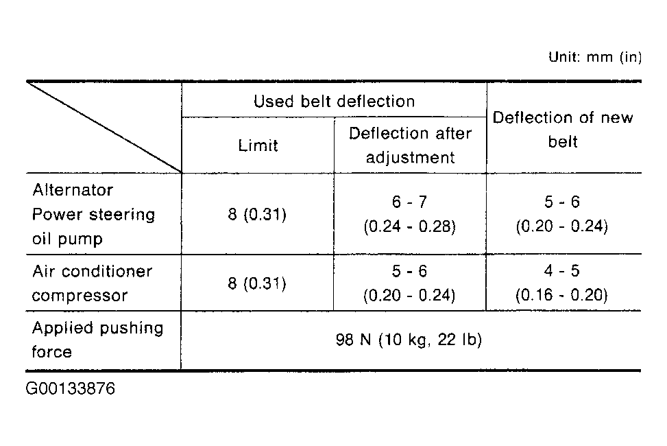

1992 Nissan NX — Drive belt routing diagram 3
Drive belt routing diagram 3 — select to enlarge

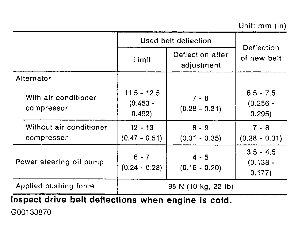

1992 Nissan NX — Drive belt routing diagram 4
Drive belt routing diagram 4 — select to enlarge
