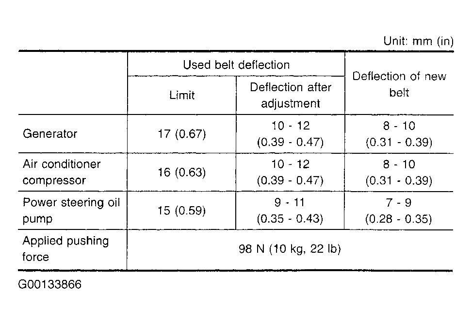

1996 Nissan 200SX — Drive belt routing diagram 1
Drive belt routing diagram 1 — select to enlarge
