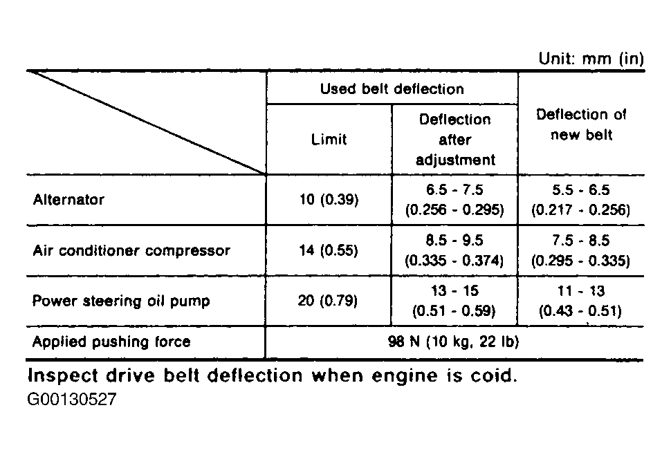

1993 Infiniti J30 — Drive belt routing diagram 1
Drive belt routing diagram 1 — select to enlarge
