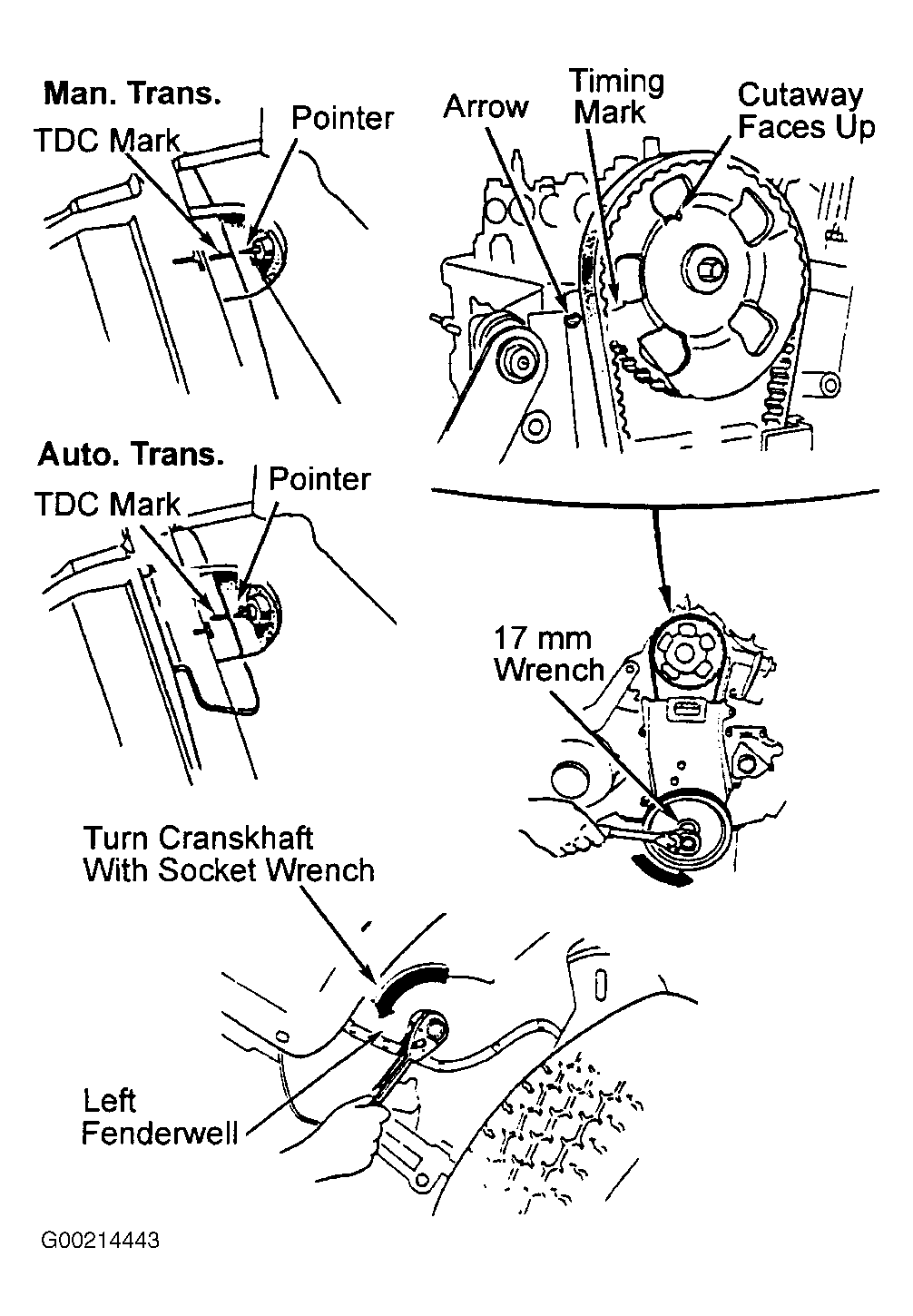

1987 Honda Prelude — Timing belt diagram 1
Timing belt diagram 1 — select to enlarge
