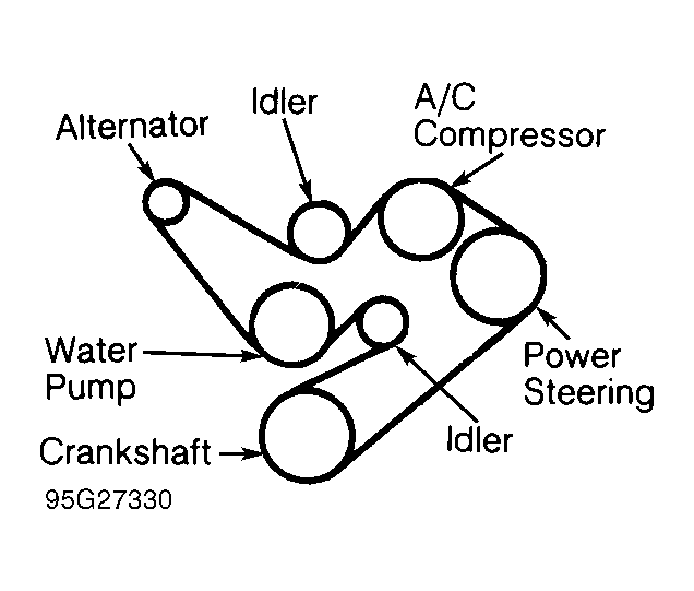

1995 Ford Ranger — Drive belt routing diagram 1
Drive belt routing diagram 1 — select to enlarge
