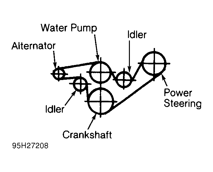

1997 Ford Cutaway — Drive belt routing diagram 1
Drive belt routing diagram 1 — select to enlarge

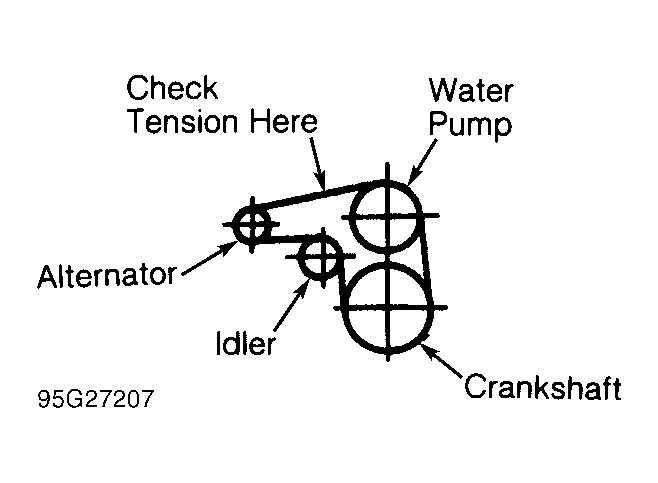

1997 Ford Cutaway — Drive belt routing diagram 2
Drive belt routing diagram 2 — select to enlarge
