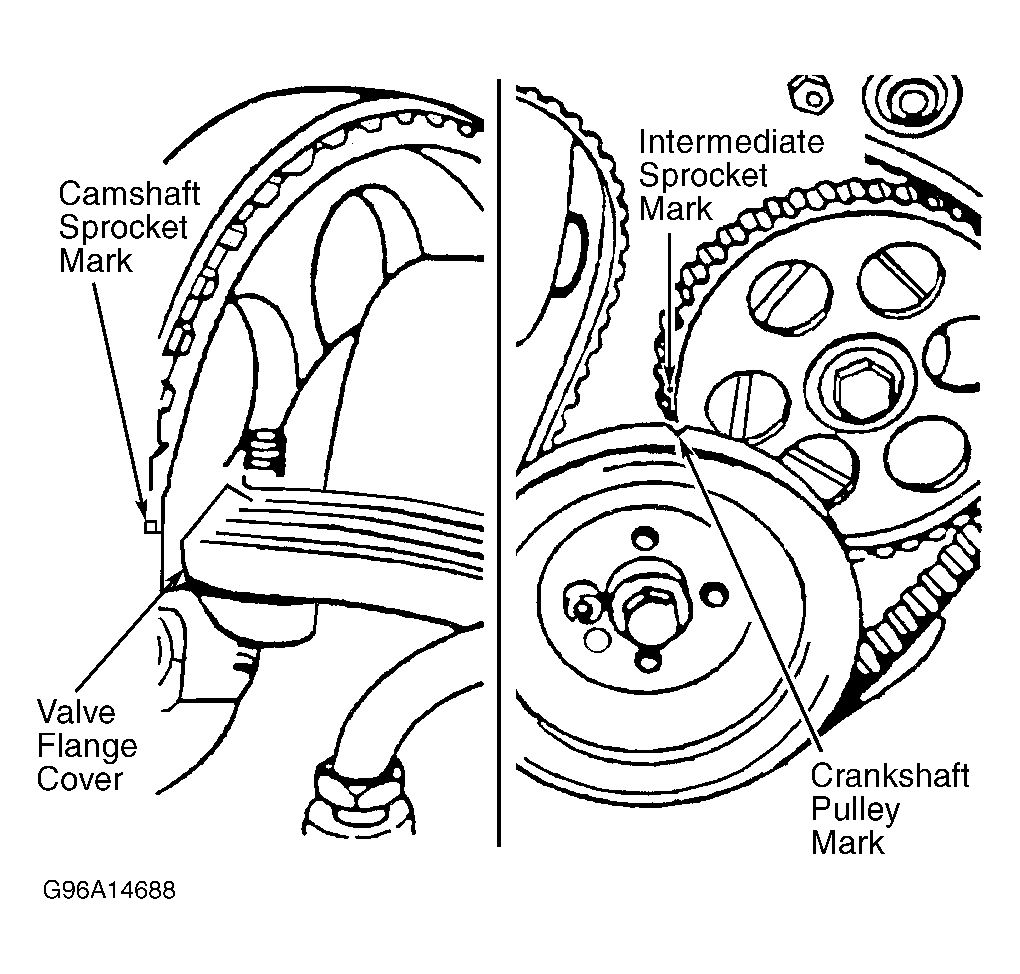

1983 Audi 4000 — Timing belt diagram 1
Timing belt diagram 1 — select to enlarge

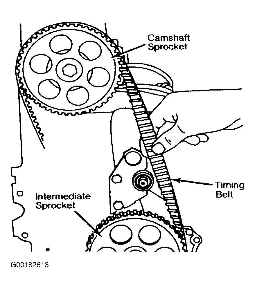

1983 Audi 4000 — Timing belt diagram 2
Timing belt diagram 2 — select to enlarge

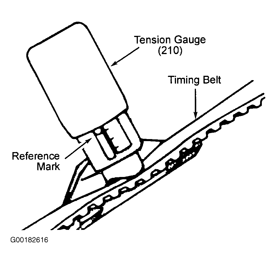

1983 Audi 4000 — Timing belt diagram 3
Timing belt diagram 3 — select to enlarge

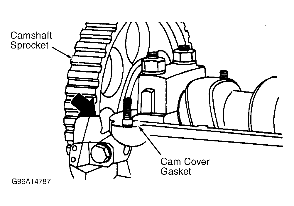

1983 Audi 4000 — Timing belt diagram 4
Timing belt diagram 4 — select to enlarge

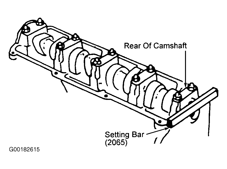

1983 Audi 4000 — Timing belt diagram 5
Timing belt diagram 5 — select to enlarge
