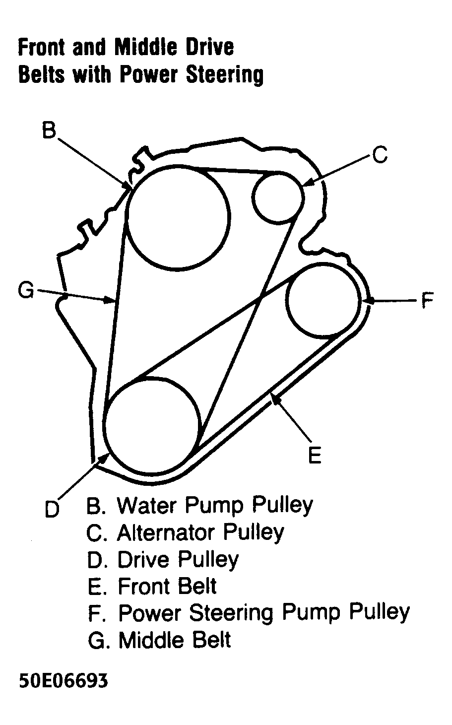

1986 American Motors Encore — Drive belt routing diagram 1
Drive belt routing diagram 1 — select to enlarge

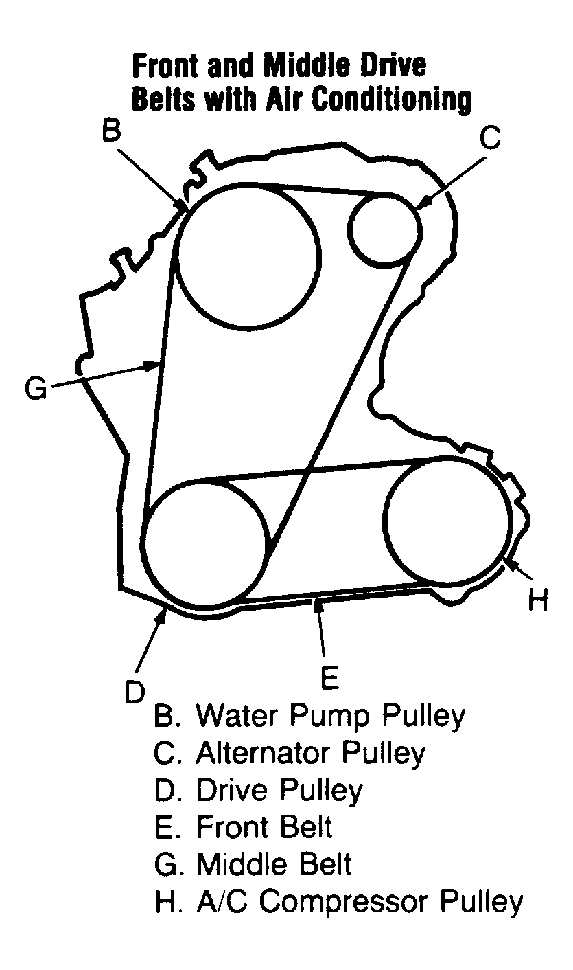

1986 American Motors Encore — Drive belt routing diagram 2
Drive belt routing diagram 2 — select to enlarge

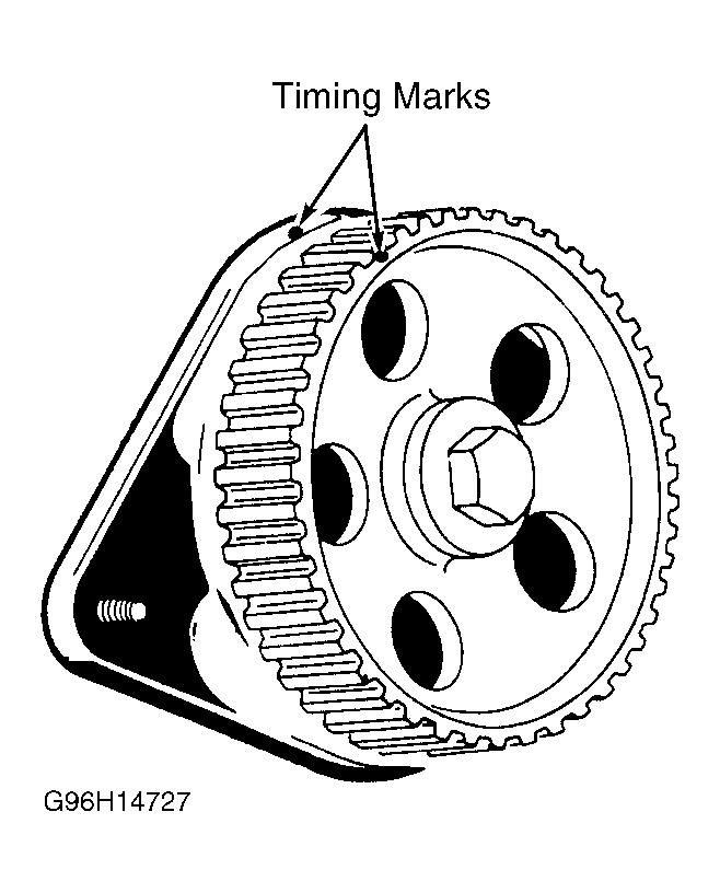

1986 American Motors Encore — Timing belt diagram 9
Timing belt diagram 9 — select to enlarge

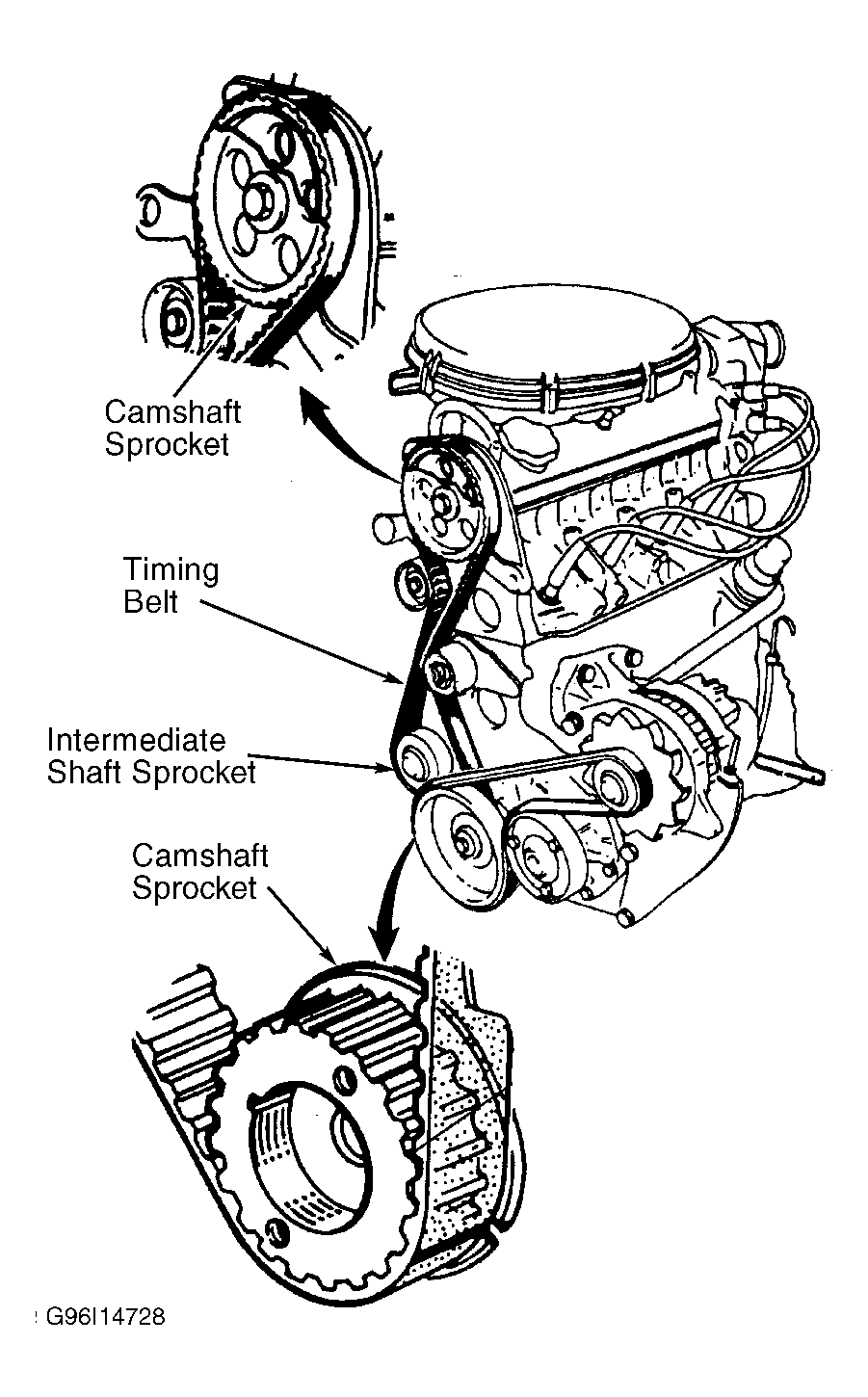

1986 American Motors Encore — Timing belt diagram 10
Timing belt diagram 10 — select to enlarge
