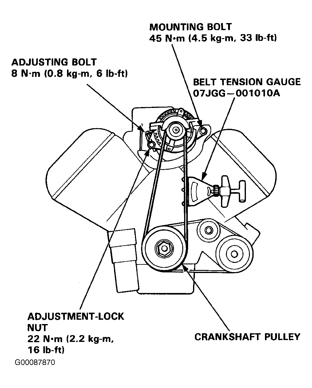

1996 Acura NSX-T — Drive belt routing diagram 1
Drive belt routing diagram 1 — select to enlarge

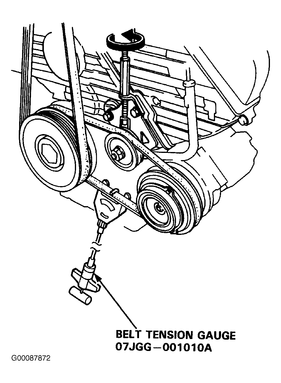

1996 Acura NSX-T — Drive belt routing diagram 2
Drive belt routing diagram 2 — select to enlarge
