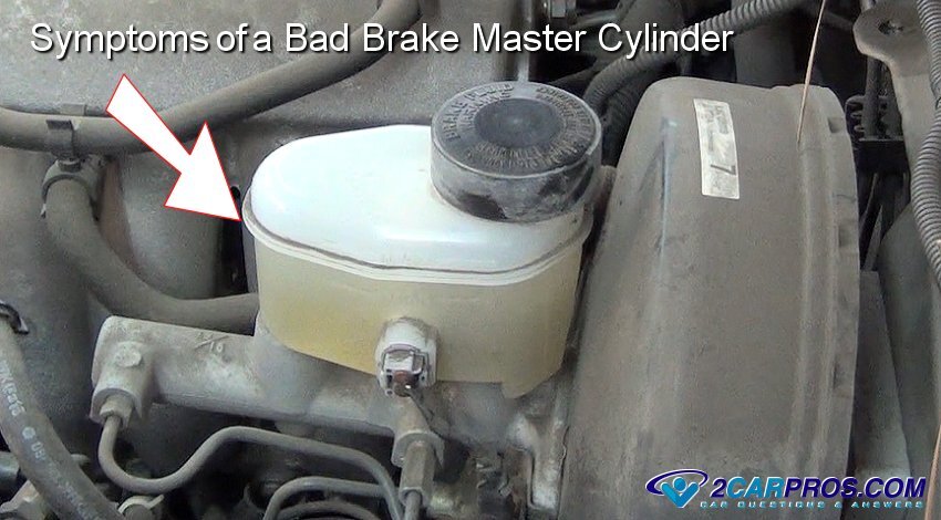

The brake master cylinder is at the heart of the automotive braking system which is responsible for converting the physical force from the brake pedal into hydraulic pressure to engage the brakes, when this part goes bad it can hinder the braking performance which is a safety hazard. In this guide we discuses the failures and what to look for when this brake components goes bad.
What Goes Wrong?
1. Brake Pedal Sinks to Floor
When a brake master goes bad it can do so when the internal seals start to fail and allow brake fluid to bypass internally which causes a sinking sensation while pressing the brake pedal. There are many reasons the brake pedal can be low so don't jump to the conclusion this is the problem 100% of the time. This guide can tell you more - Brake pedal sinks to floor.
2. Brake Fluid Leaks
The brake master cylinder has two main places it can leak form, one is the main seal at the rear of the unit and the other is the seals that attach the fluid reservoir to the brake master housing. When the main seal fails it can fill the brake vacuum booster with brake fluid, at this point the vacuum booster should be replaced as well. This can be detected by using a flashlight to inspect the rear of the master cylinder and the bottom of the brake booster.
3. Brake Warning Light
As a safety precaution brake systems are designed to have two separate functionalities that are independent of each other, front and rear, this is so when the either the front or rear brake system has a malfunction, the opposite system will still work. The brake system warning light can be telling you that one half of the brake system is not working which can be an internal brake master cylinder failure, this light can also be on due to low brake fluid levels.
4. Air in the Brake Fluid
This can happen even though you have bleed the brake system completely including opening the ABS controller valves. If you constantly find air inside the brake system every time you bleed it, this is because the main seal at the rear of the brake master is going bad. The main seal is meant to hold pressure inward while the master is in use but when the brake pedal is released this seal can allow backflow air to get sucked back into the master via the plunger, (In this case the brake master may not leak fluid).
5. Brake System Lock Up
The brake master cylinder plunger can become seized inside the master cylinder housing and not return to the neutral position causing the brakes to lock up. This can be confirmed by opening the brake bleeders at each wheel and if the problem goes away the brake master cylinder needs to be replaced.
