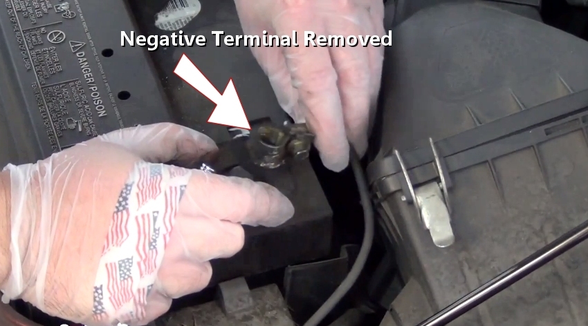

Start with the engine cold, wear appropriate clothing and safety gear (goggles, gloves etc.). Remove the negative battery cable, move the cable end far enough away to avoid an accidental connection. (Cars 2017 and newer may need a CAN memory device connected to preserve settings). Allow a minimum of 10 minutes before working with the airbag system.
negative battery terminal removed

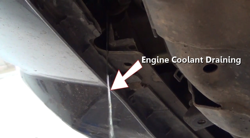

Release the radiator cap (engine cold), and loosen the radiator drain valve or remove the lower radiator hose to drain the cooling system, have a fluid catch basin ready.
coolant draining

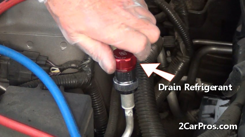

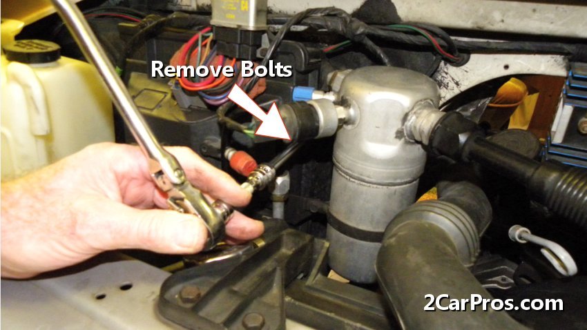

Most vehicles utilize a common plenum for both heater core and evaporator core, these types will require the refrigerant be evacuated from the system, once evacuated, disconnect heater hoses and necessary air conditioner hoses (lines).
drain refrigerant

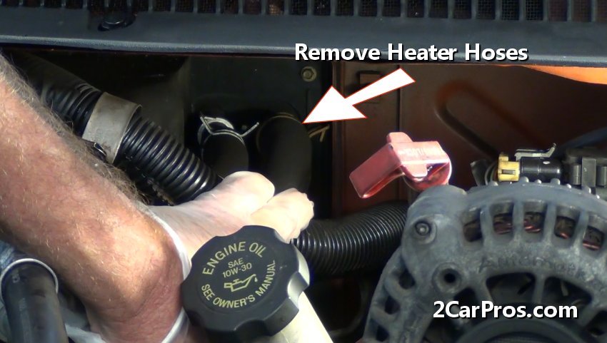

Using the hose clamp removal tool, loosen and remove the heater hoses from the heater core inlet and outlet fittings. Check the condition of the heater hoses and replace if needed.
remove heater hoses

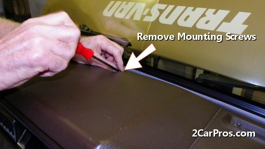

Locate and remove upper dash mounting screws. Remove any mounting hardware across the top of the dash assembly, which is usually covered by pop-in trim pieces along the base of the windshield.
removing dash screws

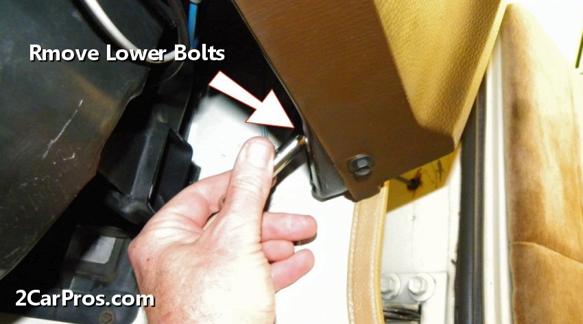

Locate and remove the lower dashboard mounting bolts. (Note: Some vehicles require the center console to be removed to access center mounting bolts.)
removing lower dash mounting bolts

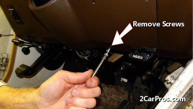

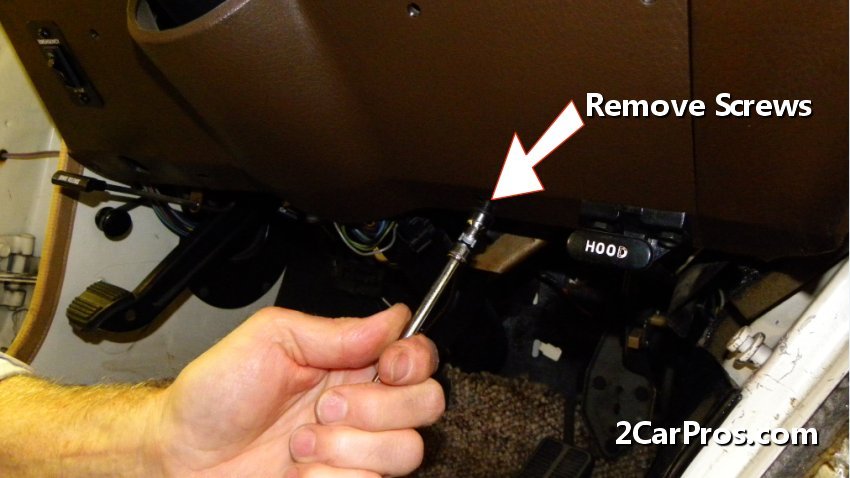

Use a small socket or screwdriver to remove mounting screws to the lower bezel allowing access to the lower steering column mounting bolts.
removing lower panel

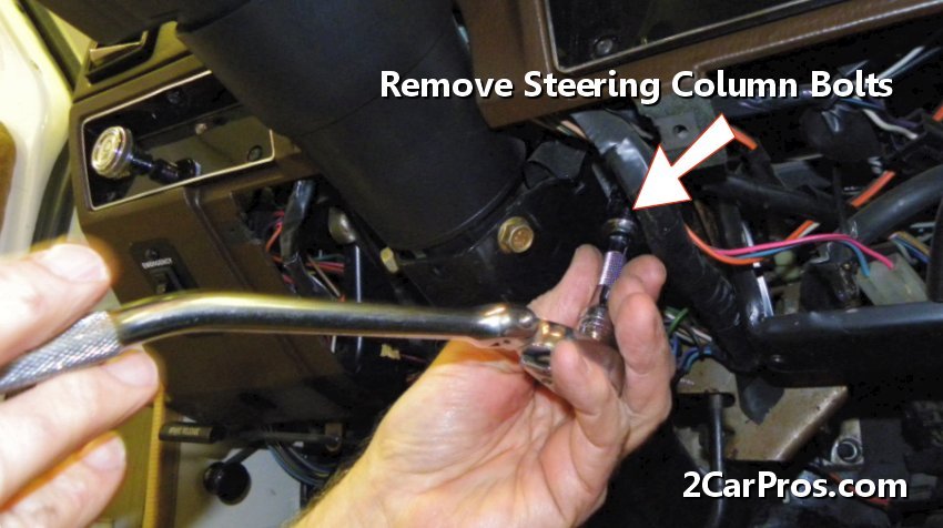

You will need to lower the steering column to allow dashboard clearance. This is done by removing the shift indicator cable (if applicable), then removing the nuts/bolts that hold the column to the dash assembly. This will allow the column to become loose from the dashboard, in most instances allowing the column to rest on the drivers seat will supply sufficient room. Locate the left side dashboard mounting hardware and remove.
remove steering column mounting bolts

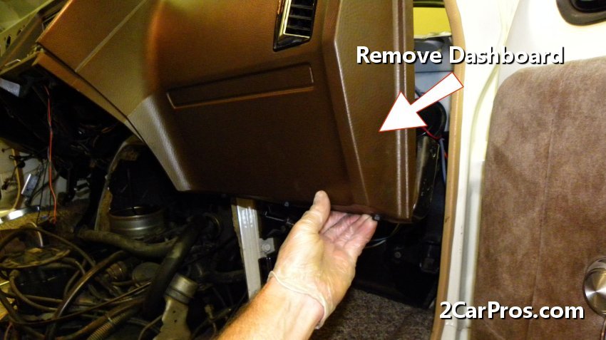

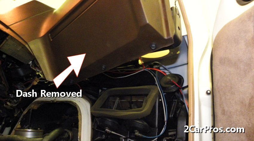

The dashboard should now be loose from the vehicle with nothing but electrical connectors or vacuum lines, gently pull the dashboard away to inspect.
dashboard removal
Slowly pull away from firewall while keeping an eye out for any wiring or vacuum lines, once back far enough support (hang) dash assembly in a position that will allow for enough room to remove the HVAC plenum.dashboard removed

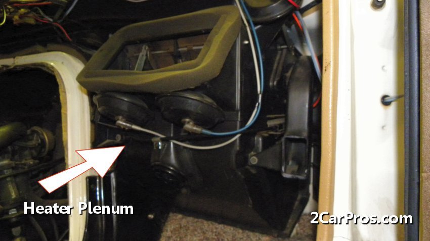

The HVAC plenum will now be exposed.
heater plenum

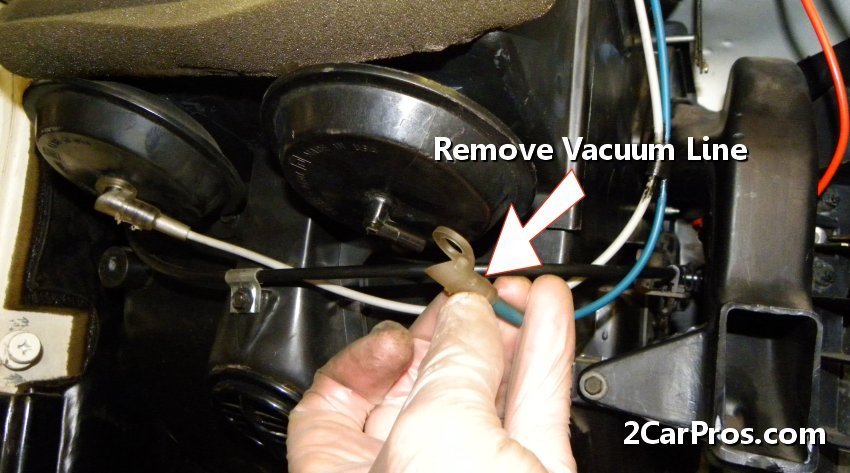

Remove electrical connectors from the blend door actuators, temperature sensors, blower motor also, remove any vacuum lines if equipped  (use your cell phone to snap pictures of the wiring if needed).
removing vacuum lines

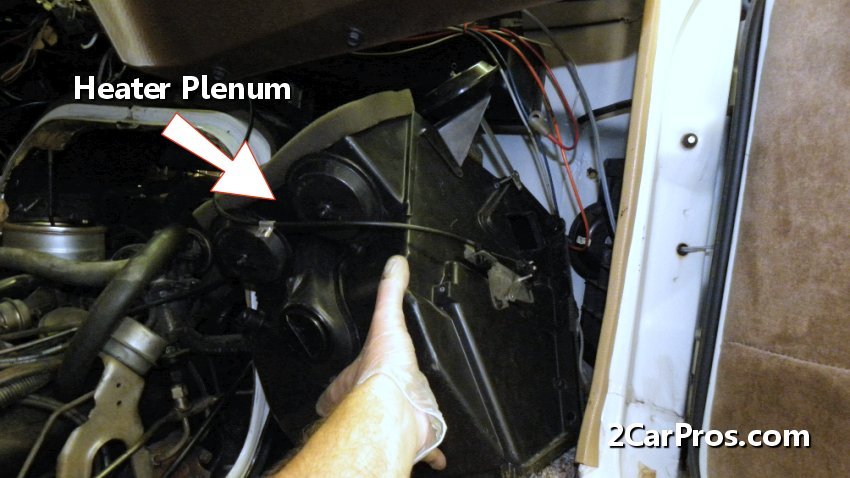

Gently pull backwards on the plenum assembly (this can be stuck slightly due to sealing gaskets from the firewall to the plenum). Keep an eye out for anything that you missed, then remove the HVAC plenum from the vehicle. Again use your cell phone to take shots of the assembly to ensure proper reinstallation. (There might be coolant leaking from the heater core so use an old towel to help control spillage.)
removing heater plenum

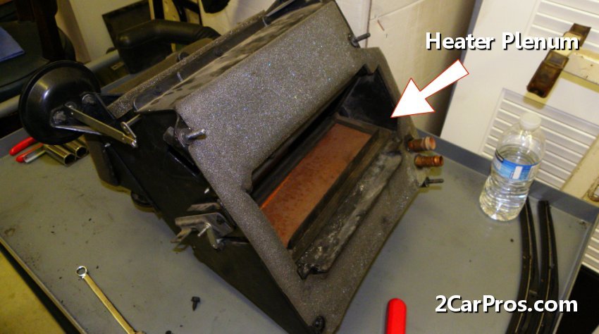

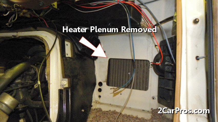

Place the HVAC plenum assembly on a suitable work area for disassembly.
heater plenum removed
This is what it looks like after the HVAC plenum has been removed. On this application you can see the air condition evaporator core which did not need to be removed in this instance.

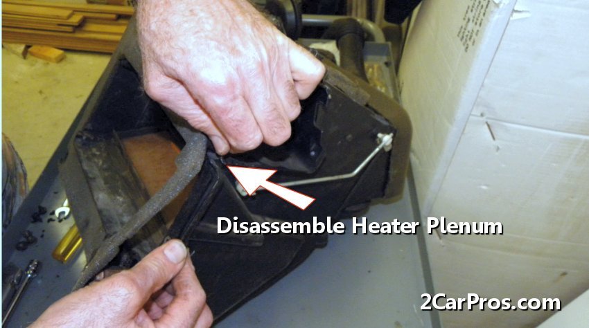

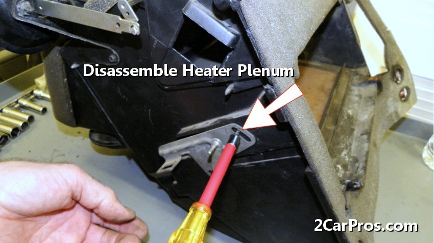

To remove the heater core the plenum will need to be disassembled. Locate and remove plenum screws to dissemble and gain access to the heater core.
disassemble heater plenum
Gently pull the plenum open to expose the heater core.

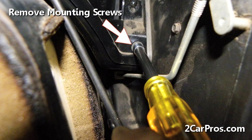

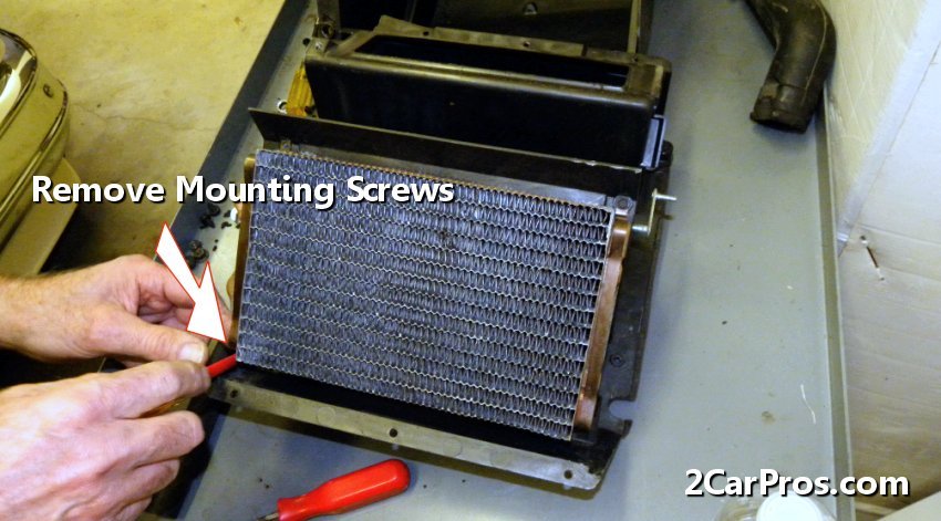

Remove the mounting screws holding the core to the housing.
remove heater core mounting screws

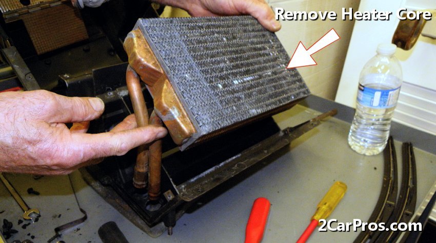

Remove the core from the housing mounts.
remove heater core

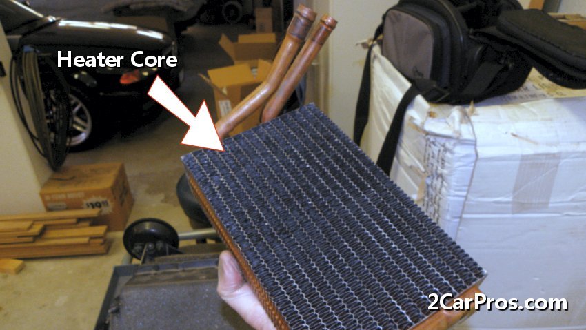

Match the new heater core to the old core to ensure a proper installation, reverse these steps to reassemble. Ensure the heater core hose connections are in good condition (round with no dents, this will allow coolant to leak). In our shop we would test for leaks before installation. Use caution when installing the heater core, these units are made of thin metal and plastic and are easily broken. Clean and inspect the HVAC unit to make sure seals and gaskets are reusable and in good condition, reassemble the HVAC plenum accordingly.
new heater core
