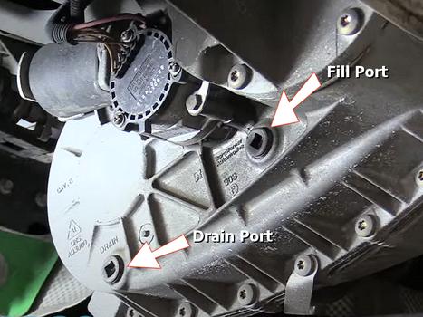

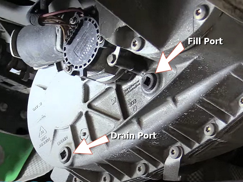

2. Using a flashlight, locate the drain and fill plugs in the transfer case which are usually near the bottom and side of the unit, the fill plug will be slightly higher than the drain plug. Here is what they typically look like in the image below.
transfer case fill drain port

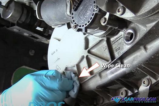

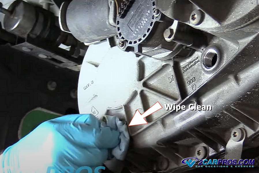

5. Once the fluid has stopped draining use a shop towel to wipe the surface clean, this will help the plug to seal to the transmission case without leaking. Some drain plugs will have a metal sealing washer which should be replaced when doing the job.
wipe clean

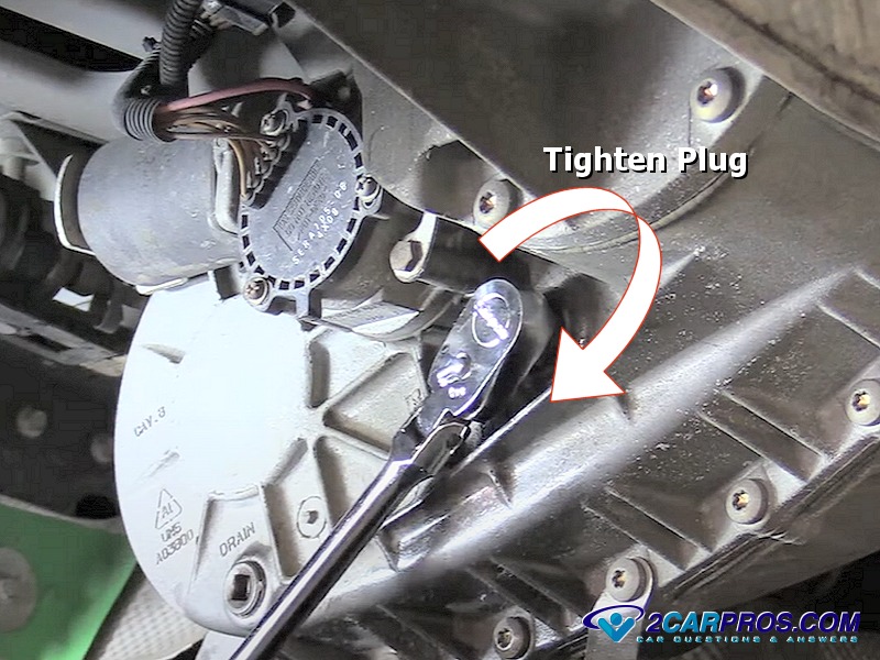

6. Reinstall the drain plug and tighten to specifications, in this case the torque spec is 19 foot pounds.

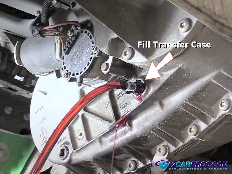

7. Use a fluid pump which is available on Amazon or the local auto parts store for about $12.00, refill the transfer case using the manufacturer's specified fluid type, in this case it's Motorcraft, MERCON ATF Capacity - 1.9L (4.0 pts.). Once excess fluid starts to pour out of the fill port, the fluid level is correct.
fill transfer case
8. Use a shop towel to wipe up any remaining fluid and reinstall the fill port plug and tighten to specification which is again,19 foot pounds of torque.
tighten transfer case fill port
