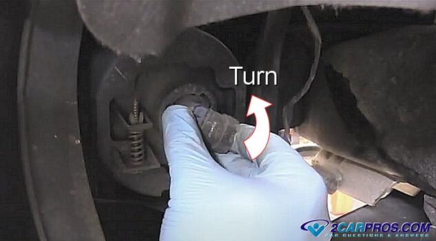

2. Grasp the fog light bulb and turn it counterclockwise while pushing inward slightly, this will dislodge the bulb from the fog light lens housing. Sometimes they can be a little stuck in which case you can use a pair of pliers to help break it loose. Depending on your vehicle, the bulb may be secured with a locking ring which can be released by being twisted it counterclockwise as well.
turn fog light bulb

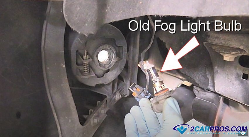

3. Gently remove the bulb from the housing for inspection, here is what the old fog light bulb looks like. The bulb may have a burned mark or be light blue in color indicating a leak in the glass, in either case the bulb is no good.
burned out fog light bulb

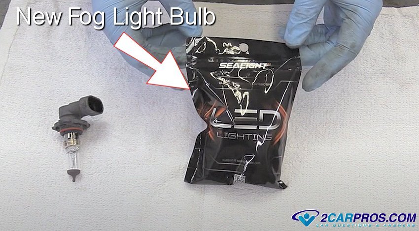

4. Match the old bulb to the new fog light bulb they should match identically unless they are being switched out to a LED style of bulb which will be different in appearance. Using a microfiber cloth, clean the new bulb to ensure there are no fingerprints or contaminants on the glass.
new automotive fog light bulb
