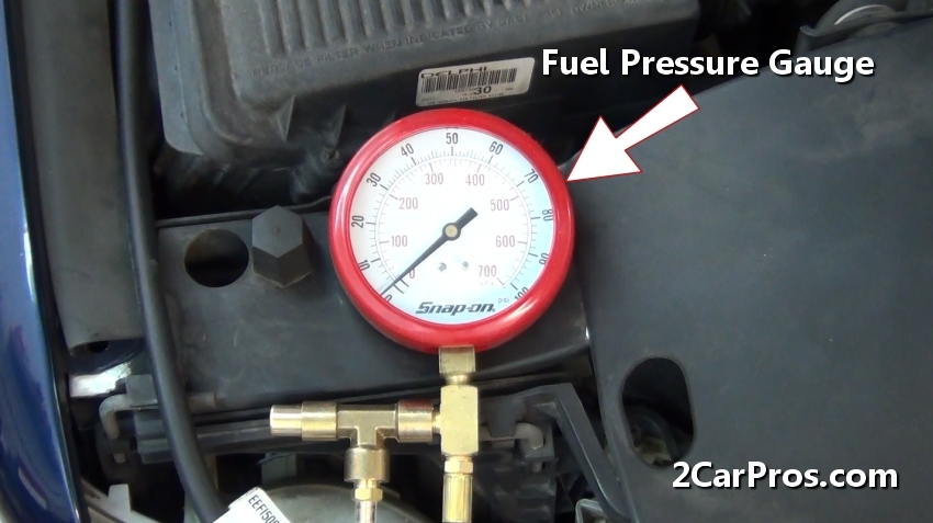

Step 4 - The engine's fuel system must operate at a specific pressure, if this pressure is inadequate the engine will hesitate. Locate the fuel pressure test port or use a fuel filter adapter to connect a fuel pressure gauge and check the reading.
fuel pressure gauge

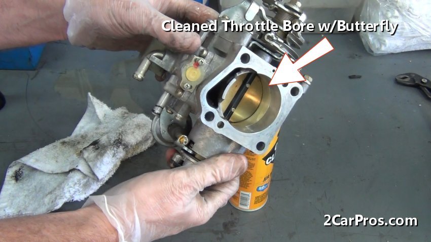

Step 8 - The throttle bore is designed to control the volume of air the engine will ingest. The butterfly and throat of the bore (plate) becomes contaminated with impurities and must be cleaned much like the mass air flow sensor. Once this condition is corrected the engine can return to normal operation.
cleaned throttle bore
