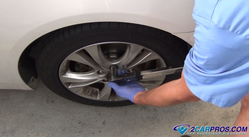

3. Loose Wheel Lug Nuts: Lugs nut are designed to hold the wheels onto the axle or bearing hub. When these lugs come loose they allow the rim of the wheel to move slightly which makes a clicking sound. Use a torque wrench or breaker bar to check the lugs nuts of each wheel to ensure their tightness. If you are using a torque wrench most lug nut need to be tightened between 75 and 95 foot pounds. If the lug nuts have been loose for an extended amount of time it could allow the wheel to come off while damaging the rim or wheel studs.
tighten wheel lugs
