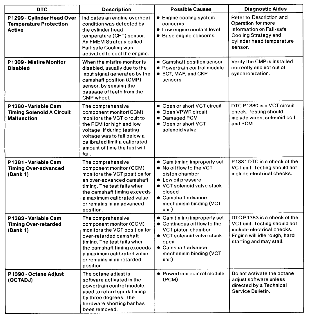

Car won't start and has code of p1383. What does this mean?
Tuesday, April 7th, 2020 AT 12:45 PM (Merged)
  • 52,797 POSTS
Take a look at the chart.
Variable valve timing solenoid usually fails from lack of changing the oil

Do the camshaft position sensor need to be replaced?
Tuesday, April 7th, 2020 AT 12:46 PM (Merged)
  • 52,797 POSTS
No, you need to follow the chart and checks for the vvt solenoid
DAVID103
  • 11 POSTS
Will changing the oil help? Also what is a vct and where do I find it?
