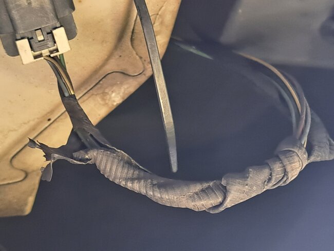

I inherited this vehicle one month ago. The "Service Zone Detection System" warning light is lit on the instrument cluster. Mounted up inside the rear wheel wells, just before the bumper, are two sensors, one on each side. They are covered by a plastic shield, held in place by four plastic push pins. The drivers side appears to be okay, but on the passenger, side it looks to have heat/fire damage. The lower right corner of the plastic shield had melted and dripped down to form a stalactite. I removed both the cover and the module. The module is $352.00 at GM! Is there a way to bench test the module?

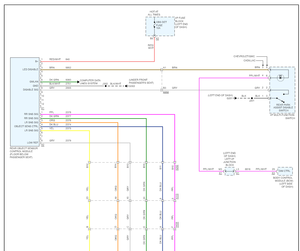

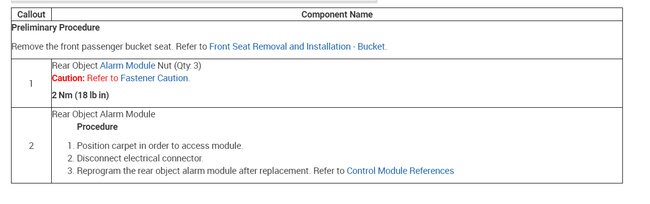

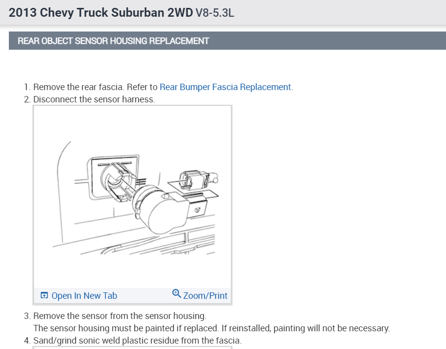

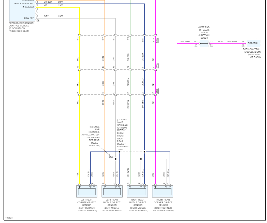

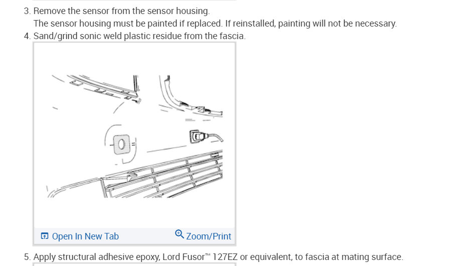

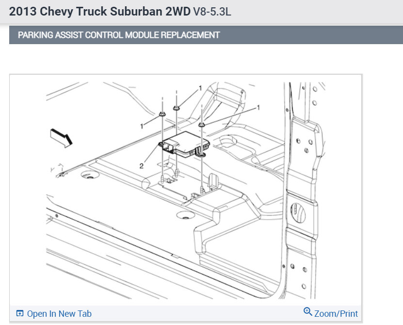

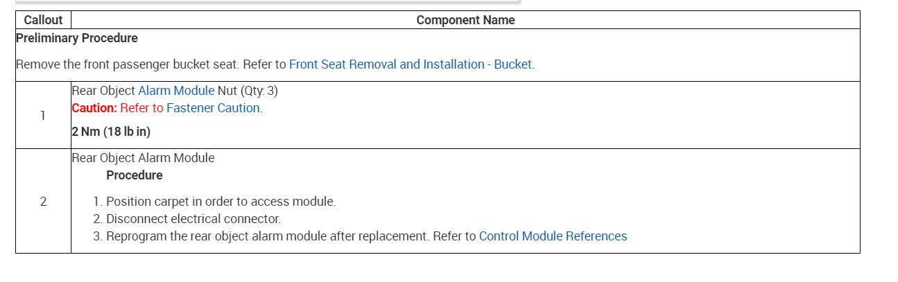

Here are the wiring diagrams and location of the sensors and the module so you can see how the system works. Please check for moisture damage at the module under the seat. Check out the images (below). Please let us know what happens.

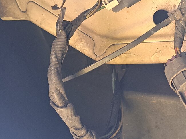

I learned from my brother that the exhaust pipe developed a hole due to rust. The exhaust was blowing directly into the right wheel well, melting some parts. The module itself was not damaged, the plastic cover was, along with a small bundle of wires leading up towards the trunk area. It leads up just on the right side of the spare tire.
Jun 3, 2023 at 4:49 AM
  • 55,399 POSTS
Good find, I would cut the melted part of the wiring away to see if any wires were damaged and repair as needed.
