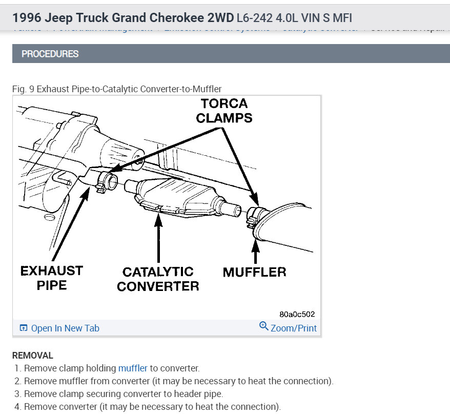

The engine idles fine and will rev while neutral. When shifted into drive the vehicle will increase speed to about 25 MPH and then won't go much faster. I checked the fuel pressure, and it was about 45 PSI. Replaced both O2 sensors and the output shaft speed sensor. No OBD codes.

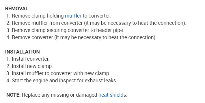

This sounds like you have a clogged catalytic converter but to be sure this guide can help us confirm the failure and I have included instructions on how to change the cat out in case you need it.
And this may help as well:
https://www.2carpros.com/articles/engine-has-low-power-output

Sorry I took so long to reply but you were correct, the converter was bad, running fine now. thanks for the advice.
