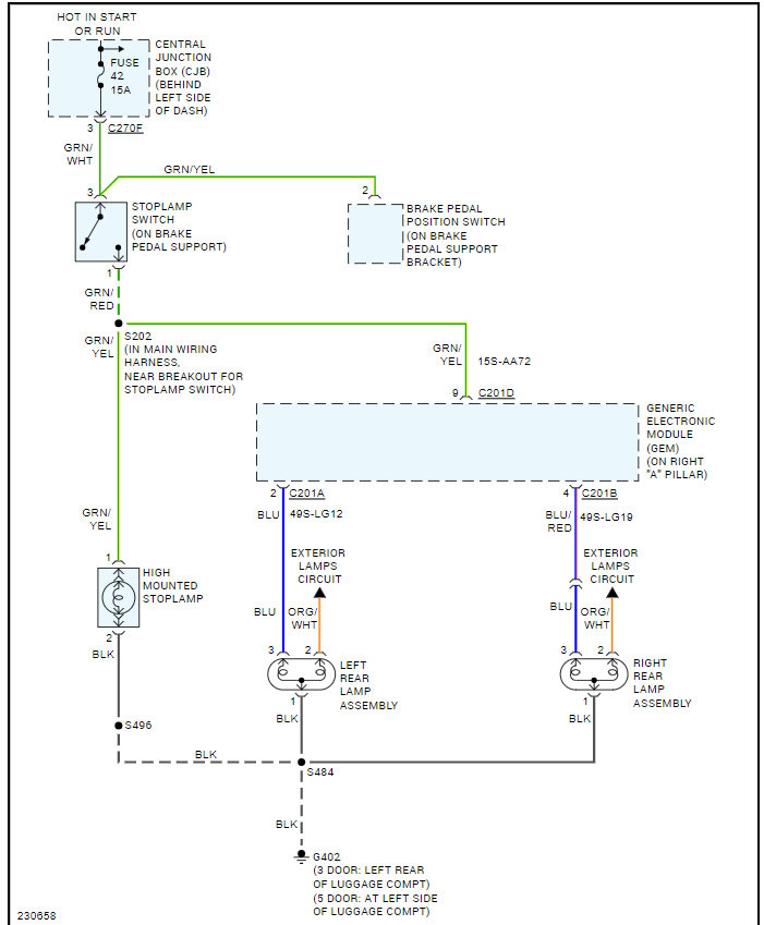

Hi, could someone tell me what color the wires are on rear brake light the car listed above Zetec. I’m trying to connect in a towbar electrics but can’t find anything online.
Thanks Matt.
Oct 2, 2024 at 5:40 AM
  • 54,832 POSTS

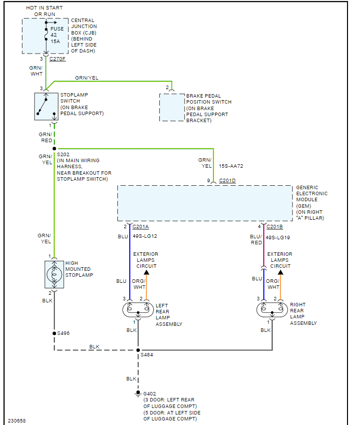

Hi Matt,
Sure, here is the brake light wiring diagrams. Check out the images (below). Let us know if you need anything else.
