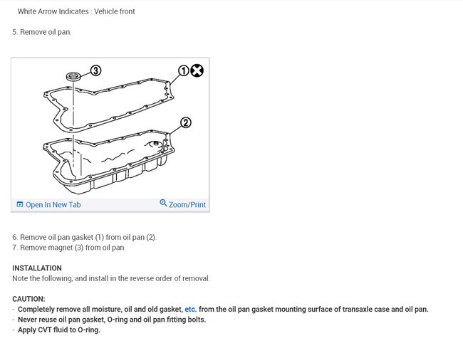

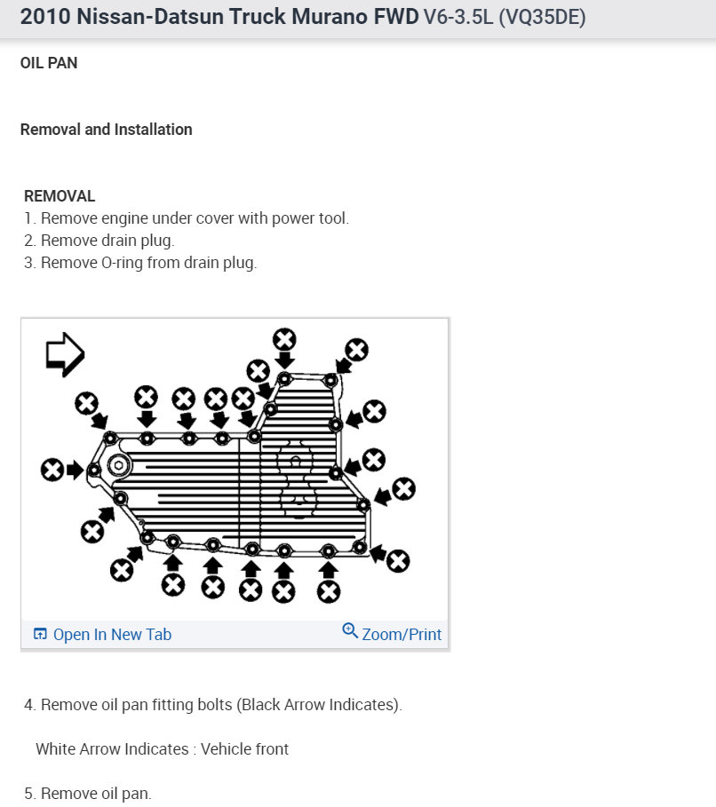

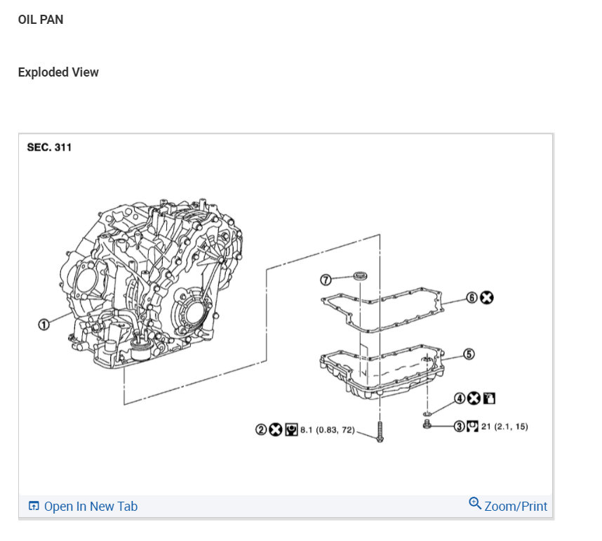

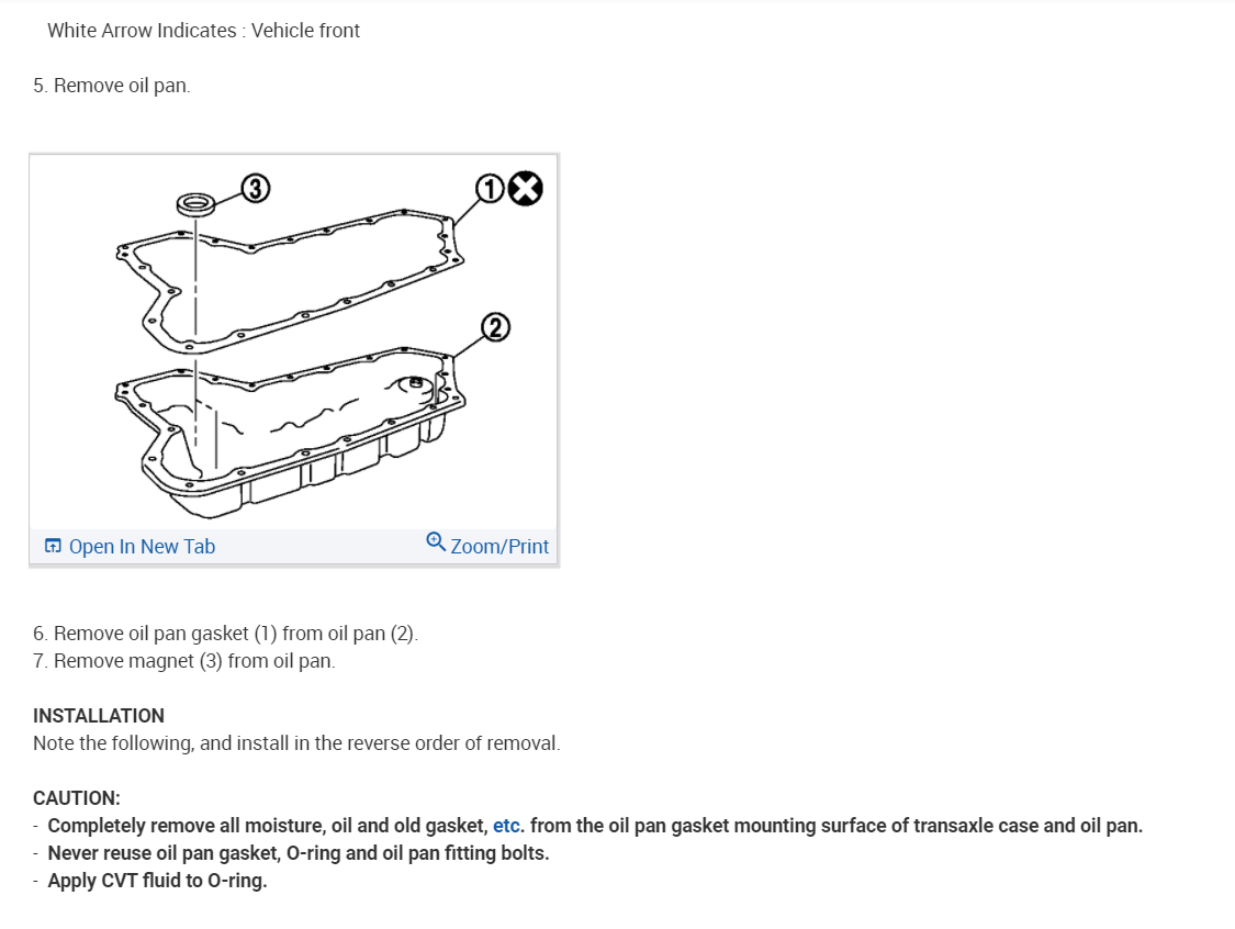

I need to know how to drain my transmission fluid and the location pf my PCV valve. I've looked where Haynes says it is and can't find it. ya'll have been helping with everything on this car. so far, it's a $6.00.00 to $7,000.00 loss.
Mar 27, 2022 at 8:57 AM
  • 55,423 POSTS
This needs to be two questions. We handle one issue per post. We will take care of the transmission service on this post. Please start a new question for the PCV issue. This guide can help you see what you are getting into with directions on the diagrams below to show you how on your car:
Type .................... Genuine Nissan CVT fluid NS-2*
*Using Automatic Transmission fluid other than Genuine Nissan CVT fluid NS-2 will cause deterioration in drivability and CVT Transmission durability, and may damage the CVT Transmission, which is not covered by the NISSAN new vehicle limited warranty
Capacity .................... 10.2 qt (9.0L)
Mar 28, 2022 at 3:52 AM
