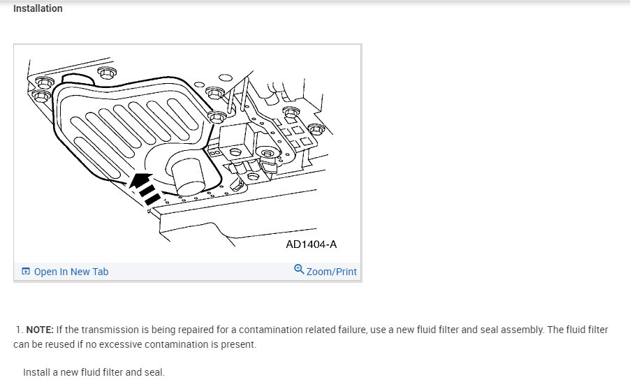

Your Transmission YouTube video, was for a 4X4 transmission or regular transmission?
176,000 MILES • 4WD • AUTOMATIC
FORDLARRY
On your YouTube video.
https://youtu.be/A-X4afWLLO8
Changing the transmission fluid and filter.
Nice YouTube video.
But you never said if this was for a 4X4 transmission or regular transmission?
Thanks,
Larry
Jul 22, 2022 at 5:52 AM
  • 110,248 POSTS

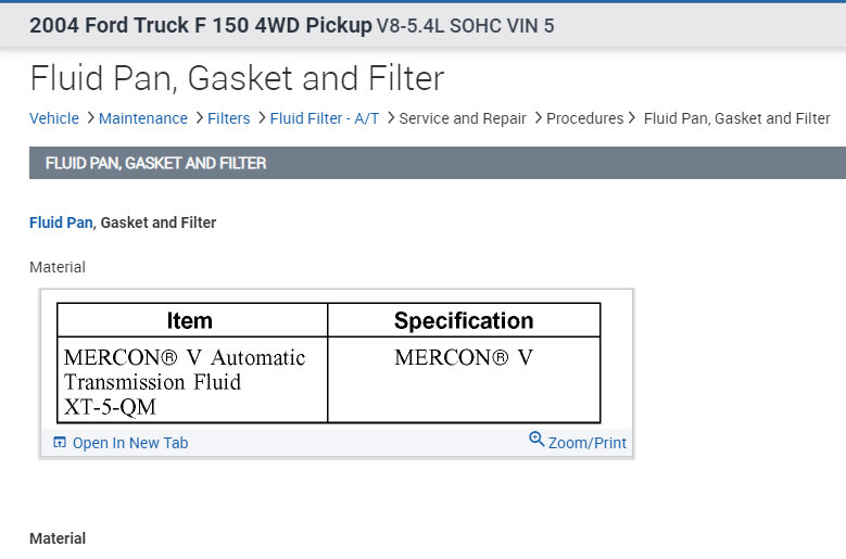

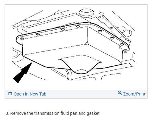

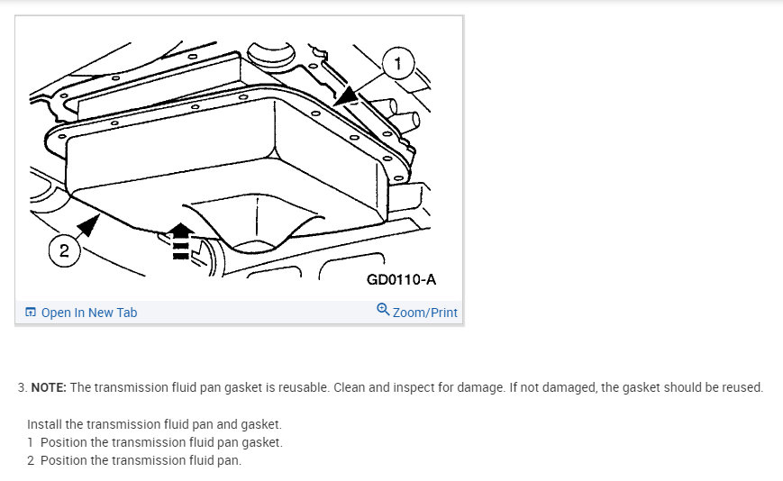

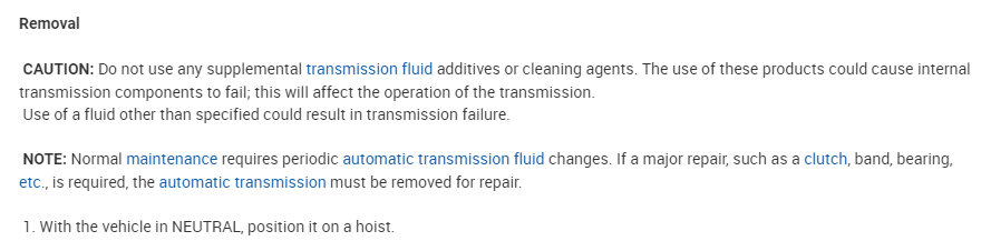

Hi Larry,

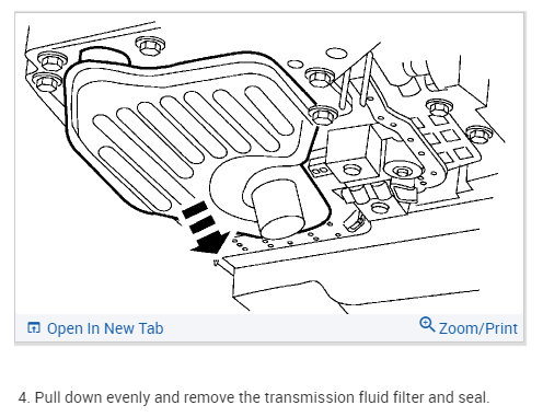

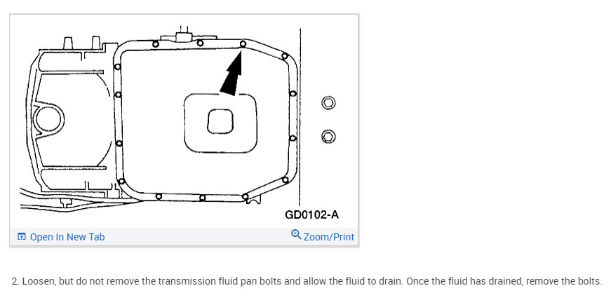

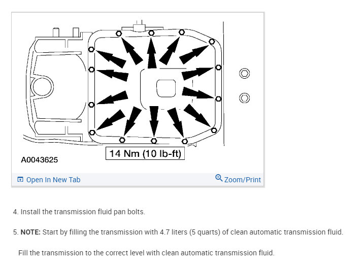

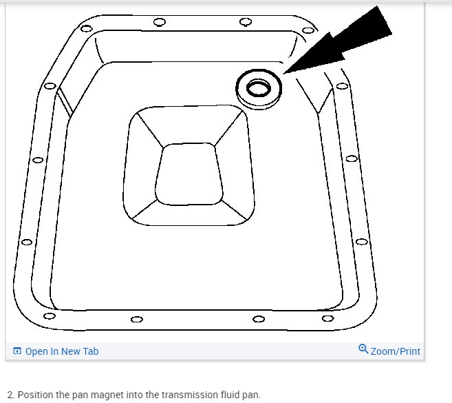

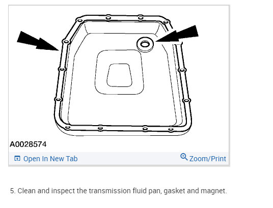

The transmission on either vehicle would be the same. Actually, the tail housing would be different to accommodate the transfer case on a 4wd, but the transmission itself is the same. Also, servicing is done the same as well.
If you are concerned, I attached the directions below for changing the fluid, filter, and pan gasket. This is from a 5.4L The 4.6L is similar.
