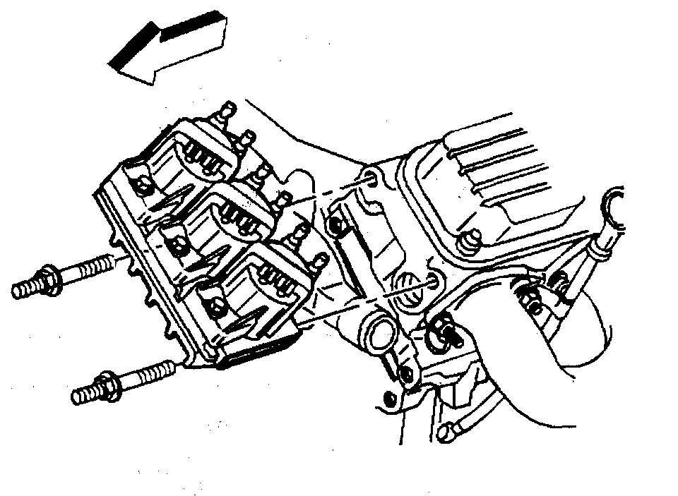

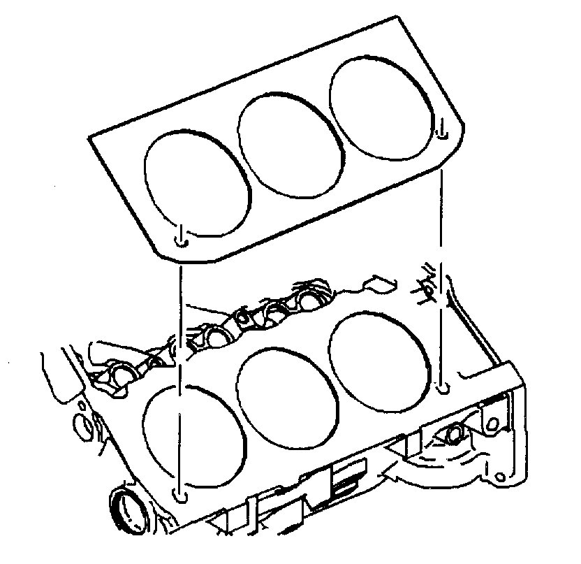

I checked the oil today since the low level light came on and found thick yellow gunk on the oil cap. I have this car for two years and changed the with synthetic oil every six months/6,000 miles and have never seen this before. On a side note i keep losing antifreeze every so often. I am inclined to think it is a blown head gasket or a LIM gasket because of the low coolant but the weird thing is that my oil level is not abnormally high, it keeps getting low. So I am losing both coolant and oil. Any ideas are appreciated.

Honestly, based on your description, it sounds like a bad head gasket.
The first thing we need to do is determine if a head gasket has failed. Follow the directions in the following link and let me know what you find.
Now, if you determine it is a bad head gasket, here are the directions for replacing it. The attached pictures correlate with these directions.
CYLINDER HEAD REMOVAL AND INSTALLATION
REMOVAL PROCEDURE
1. Disconnect the negative battery cable.
CAUTION: Refer to Battery Disconnect Caution in Service Precautions.
2. Remove the intake manifold. Refer to Intake Manifold Replacement (Complete - VIN 1).
3. Remove the exhaust manifold. Refer to Exhaust Manifold Replacement (Left).
4. Remove the rocker arm cover. Refer to Valve Rocker Arm Cover Replacement (Left).
Picture 1

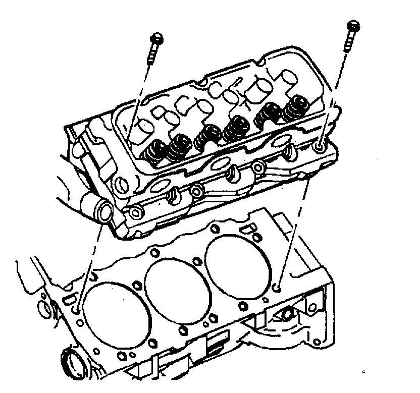

Picture 2
13. Remove the cylinder head bolts. Discard the bolts.
14. Remove the cylinder head.

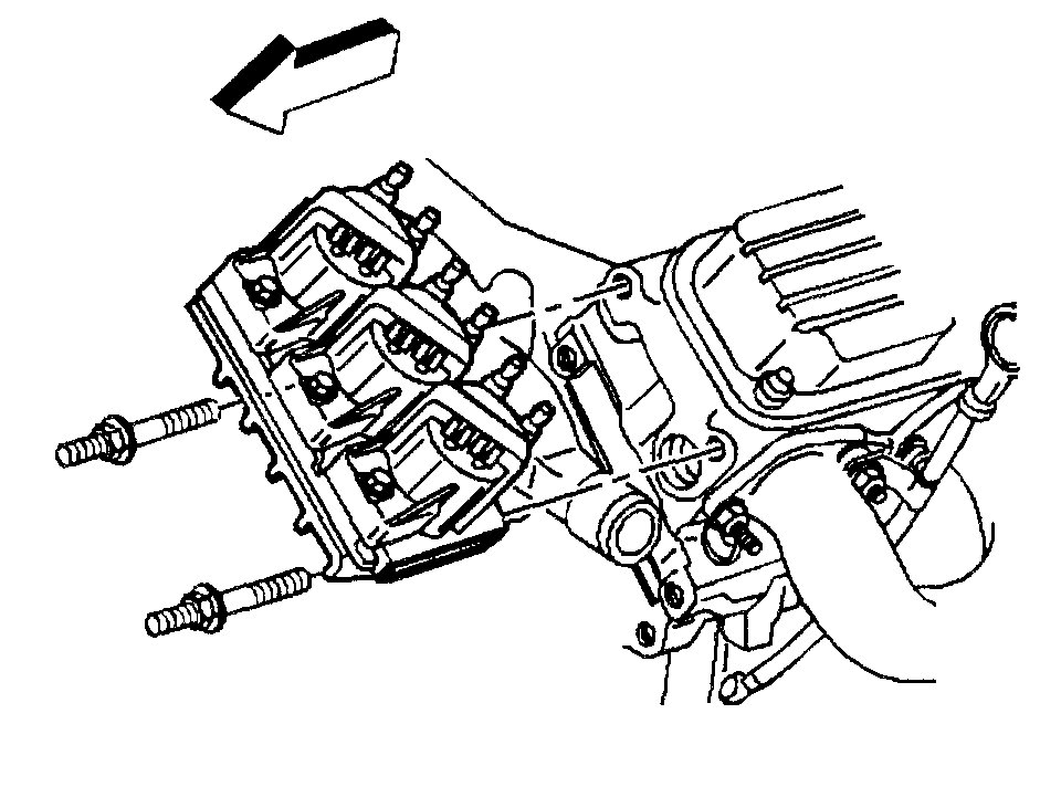

Picture 3
15. Remove the cylinder head gasket.
16. Clean all of the gasket mating surfaces.
17. Inspect the cylinder head. Refer to Cylinder Head Clean and Inspect in Unit Repair.

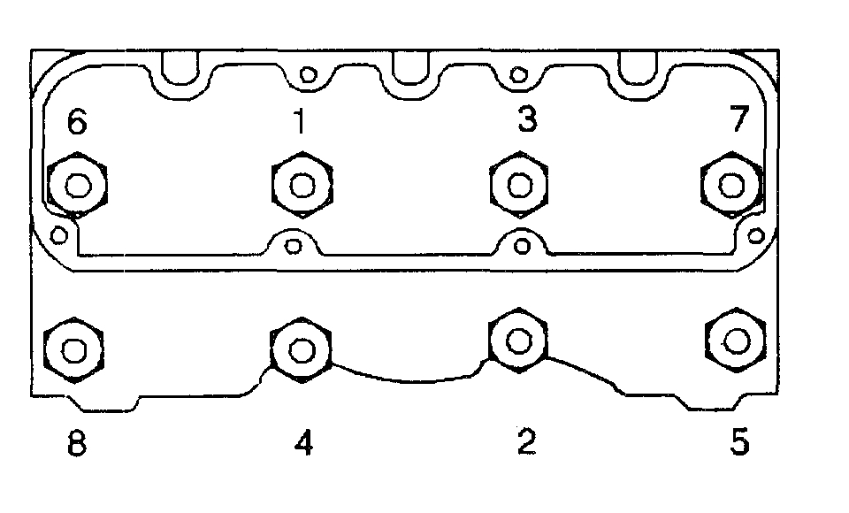

1. Clean the threads in the block. Use a 7/16-14 tap.
Picture 4

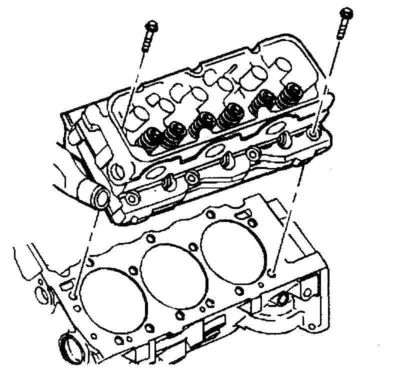

2. Install the head gasket with the arrow pointing to the front of the engine.
Picture 5

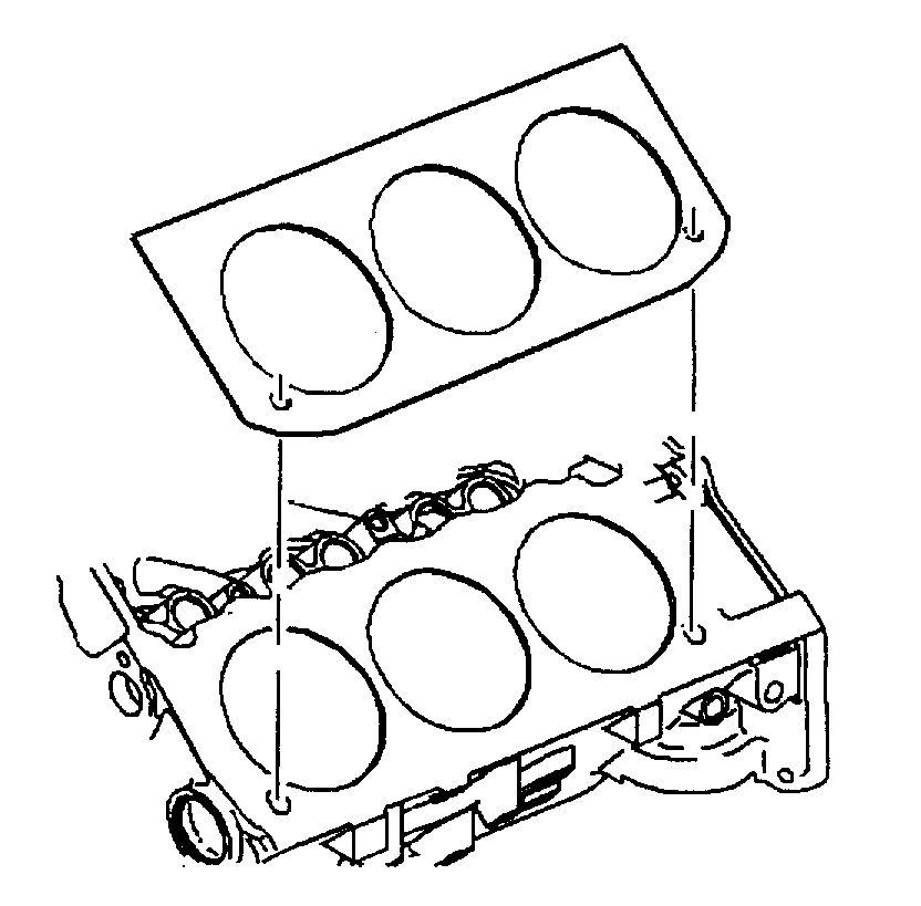

3. Install the cylinder head.
Picture 6
4. Install the new cylinder head bolts.
^ Tighten the bolts in sequence to 50 Nm (37 ft. lbs.).
^ Rotate each bolt 120° in sequence. Use the J 36660.
