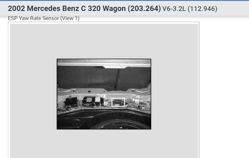

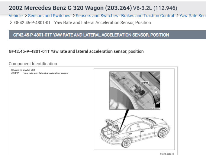

Yaw sensor location for S203 Mercedes wagon found it for sedan w203 not wagon.
Sep 9, 2023 at 9:30 AM
Experienced Mechanic
110,251 POSTS
I attached two pics below to help locate it. Pic 2 shows the actual sensor.
Take a look at the pics and let me know if that is what you need.
