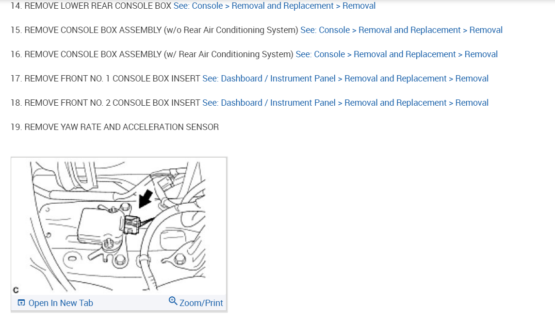

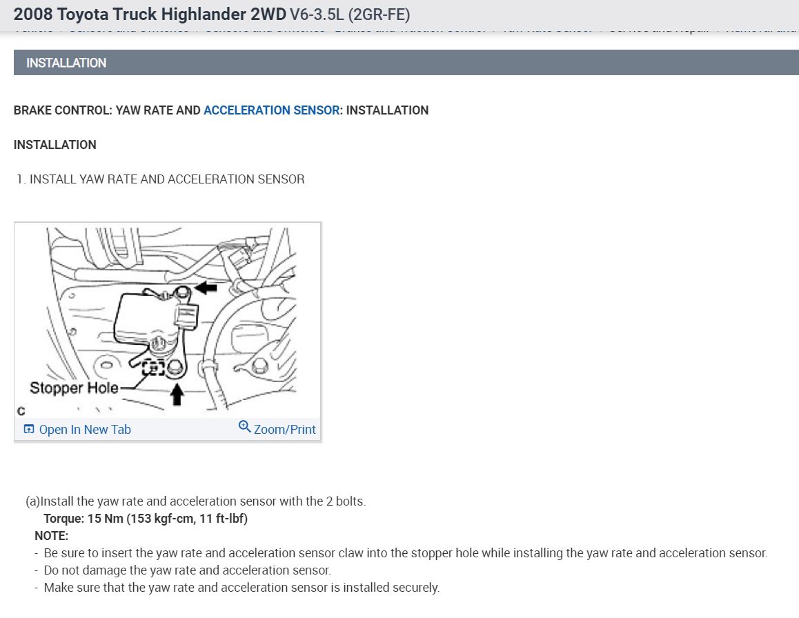

I was told when I got the brakes down that my Yaw Sensor was not making a connection, causing my ABS, and traction light to come on. Currently I have all kinds of warning signs on my vehicle, ABS.
Apr 4, 2023 at 11:53 PM
  • 55,433 POSTS

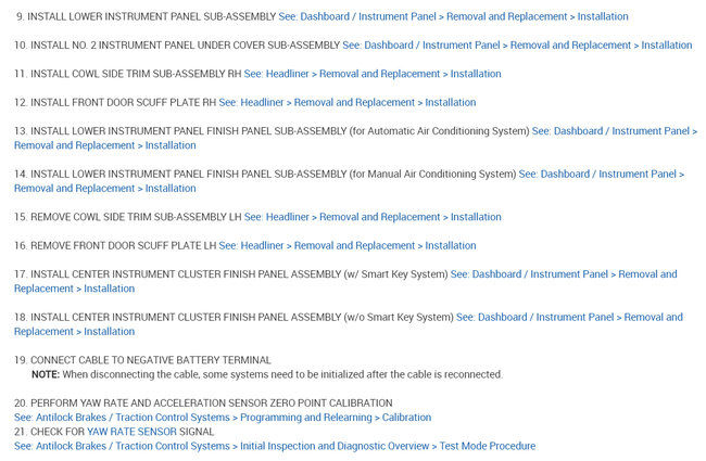

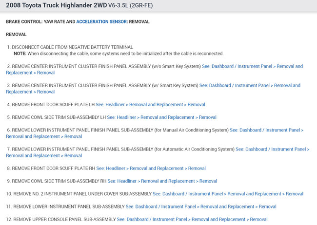

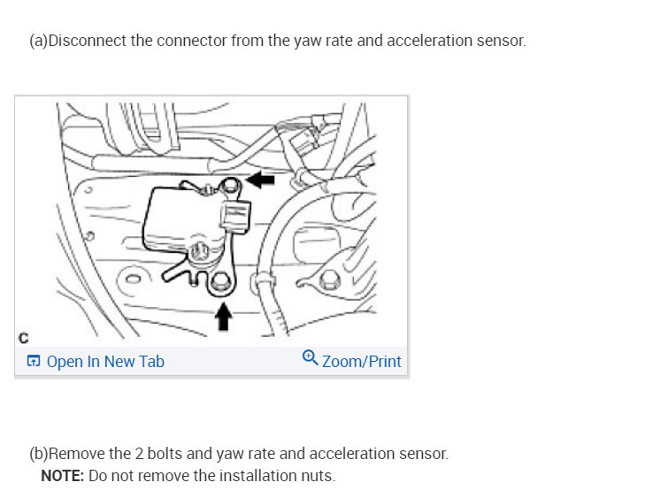

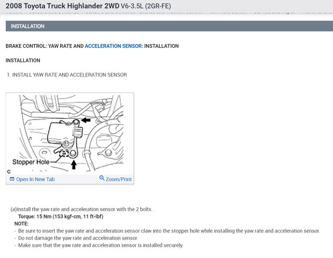

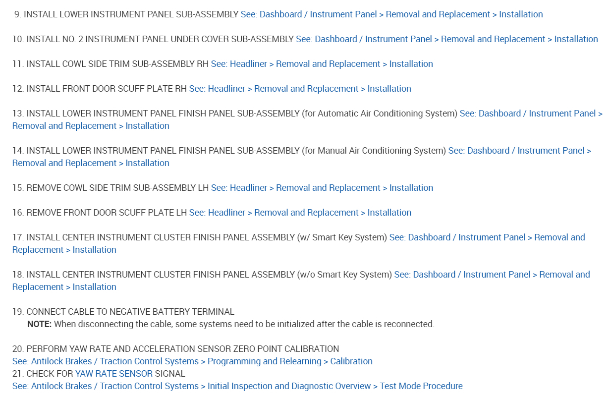

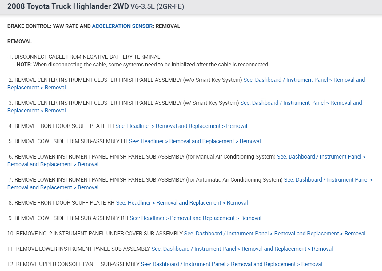

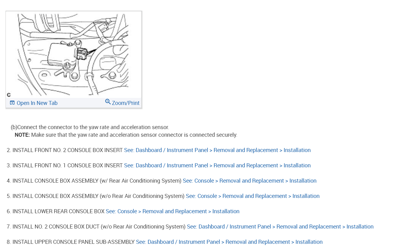

The yaw and acceleration are in under the center console here are the instructions on how to change it out in the images below. Please let us know if you need anything else to get the problem fixed.
