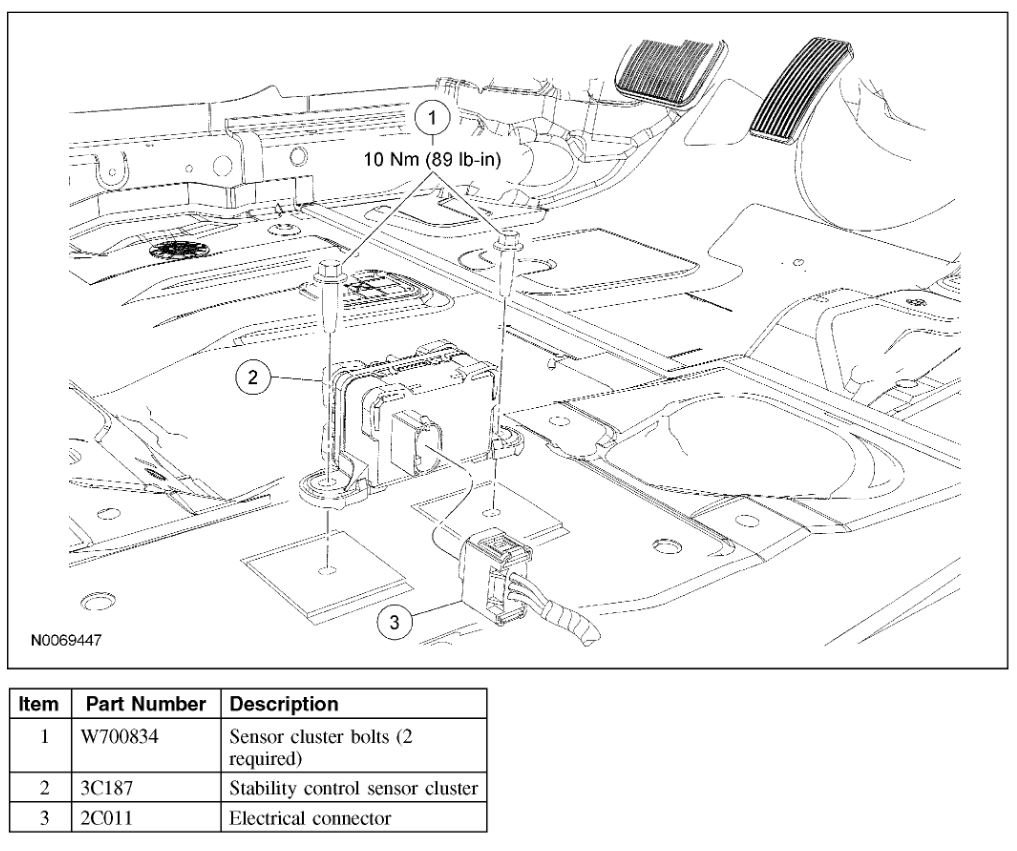

where i can find the yaw rate sensor in the vehicle listed above?

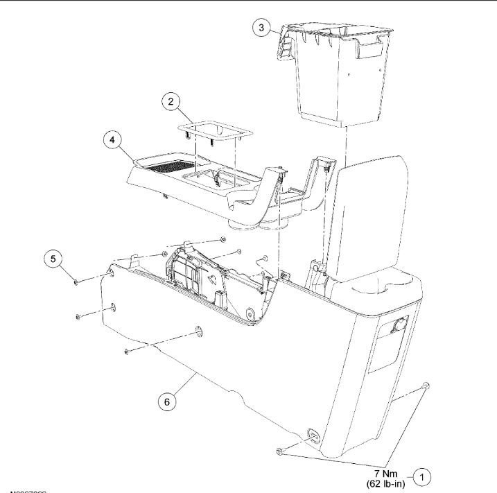

It is under the center floor console. You remove the center console and it's bolted to the floor. Slide the seats forward and remove the two rear bolts on the console, then move them back and remove the trim ring around the shifter. Remove the storage bin and upper finish panel, now remove the remaining bolts and remove the console.
What issue do you have telling you there is a problem with the sensor block?

I can’t find the sensor I already looked what other part can I find it?

That is where it should be in that vehicle. It is put there so it gats better data. Do you have the same year, make and model?
