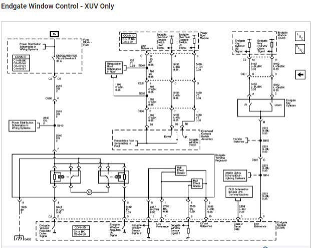

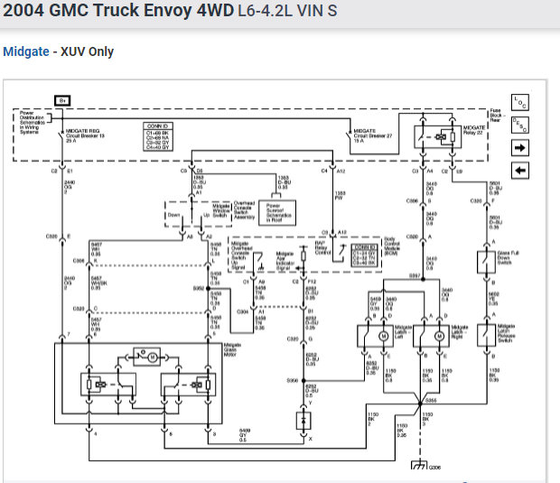

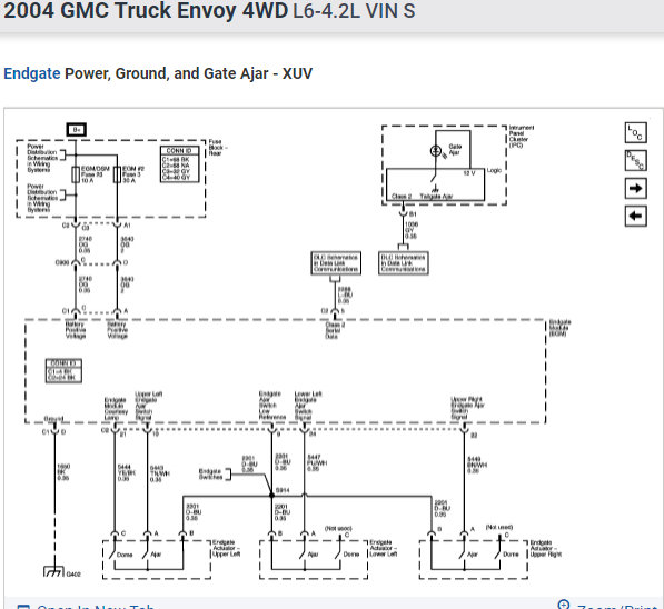

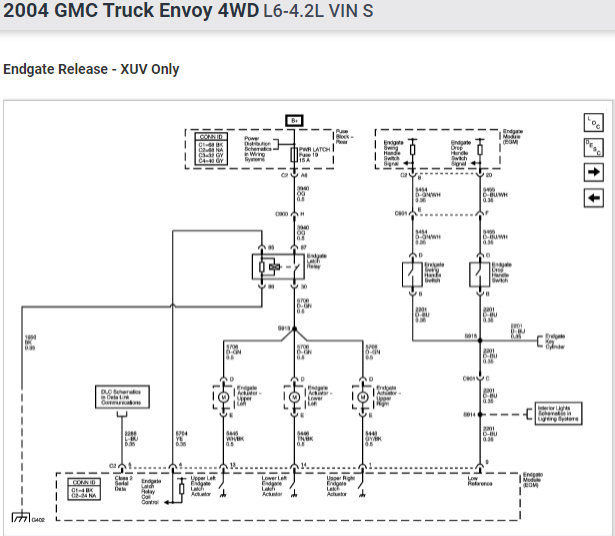

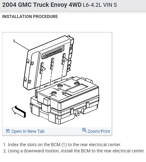

I currently own the vehicle listed above XUV, 4.2 Liter, I-6. The vehicle seems to run fine, but my issue is with the tailgate/endgame not getting power to the window as well as the door release buttons at the rear of the vehicle. Also, the rear defrost button is not working as well.I would like to assume that the problem is contained to the rear function of the vehicle (the power going to the tailgate/endgame specifically) because I don't have power to the tailgate window as well as the door, but power to everywhere else.it could be a possibility of a fuse or shorted wire, but I have no wiring diagram to isolate the tailgate. The XUV is a rare vehicle and a lot of GM dealers see it and said that they have never heard of it before. which means I'm going to pay them to experiment like I am. Does anyone have this issue or have wiring schematics for the tailgate in particular? Your help would be greatly appreciated.
Jul 13, 2021 at 8:35 AM
SQM
  • 6,383 POSTS
I have attached few wiring diagrams for the XUV. Let me know if you have able to read it. Some reason the format of these does not allow me to upload larger images.

The lock cylinders are all factory. What i have actually changed is the Tailgate Window Regulator (AC Delco # 19210376) and the previously mentioned Body Control Module (Manufacturer #10359109). I'm not getting any fault codes on the dash when I hit any buttons or switches for the tailgate or roof. It seems as though it's not communicating with the back tailgate at all.

First and foremost, I apologize for the delayed response. I'm in the military and I had to leave for work reasons, so I didn't want to give you the impression that I didn't appreciate your assistance. With that being said, I have tried all of the steps you recommended and where it currently stands is...if I attach a 3rd party device (Autel MaxiCOM) and remotely log in to control specific features (tailgate window up/down, tailgate open/close, roof open/close) it works, but it does not work if I try to control it from the buttons inside the vehicle and outside handle respectively. I don't know if there's an overall delete and reprogramming procedure for the functionality or if there is a particular relay/fuse that controls the functionality directly as opposed to remotely that makes a difference. I have replaced all switches in the tailgate as well as the actual CPU that controls the functions. I could "assume" that those are "known goods", but I could be wrong...what do you think? As always, your thoughts and opinions are welcome and greatly appreciated in this endeavor!

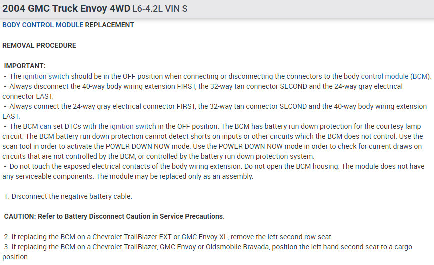

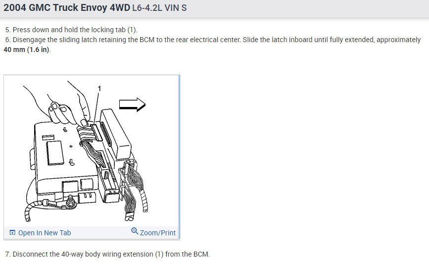

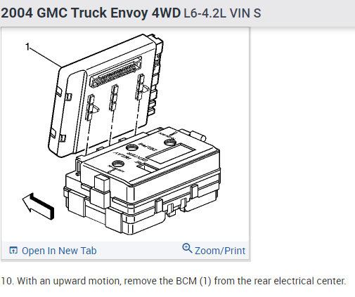

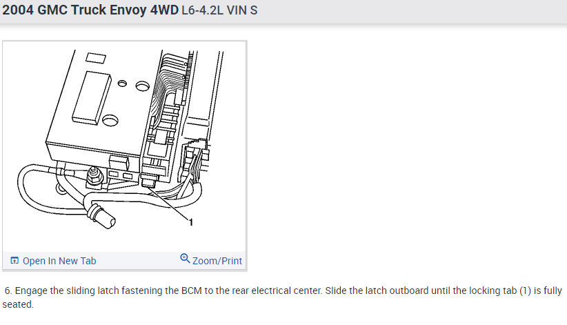

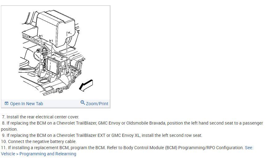

Hey, glad to hear back from you.
The BCM for that vehicle does need to be reprogrammed.
Did you get a chance to do that?
Dec 17, 2021 at 1:40 AM
JETSON21
  • 9 POSTS
No sir, I have not. Do I need special instructions on how to do so, or is it just a matter of me unplugging the battery and letting the charge drain for about 30 minutes?
Dec 17, 2021 at 2:10 AM
SQM

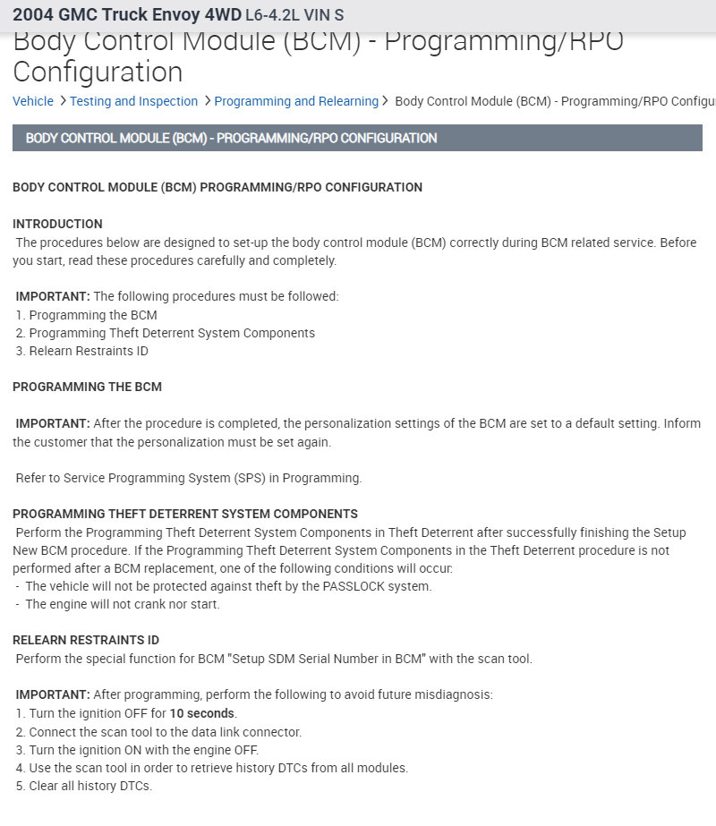

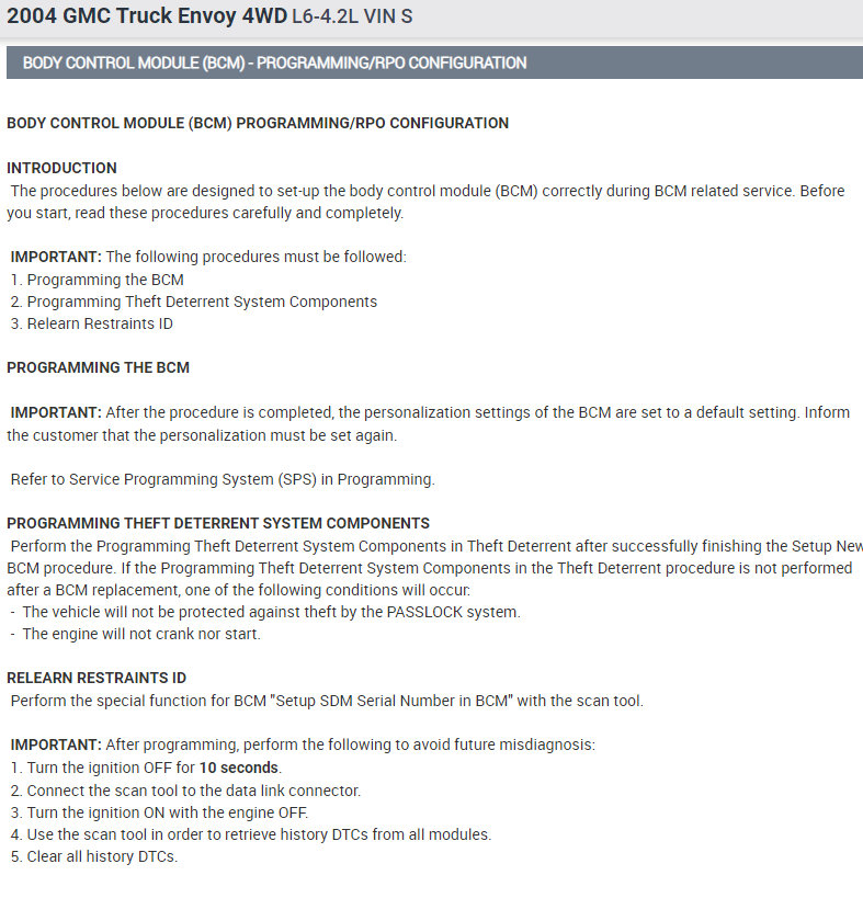

  • 6,383 POSTS
These typically require a special scan tool to perform the programming/relearn.
But disconnecting the battery could work.
Look below for the steps that Alldata provides.
Dec 17, 2021 at 4:25 AM

Now the question I have is: Is there a procedure specifically for the Rear BCM? I tried the procedure that you passed along, but that is for all Envoys in general. The functions and controls for the regular controls did reset and relearn, but it had nothing to do with the rear controls.

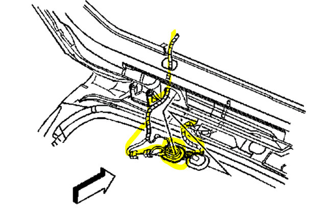

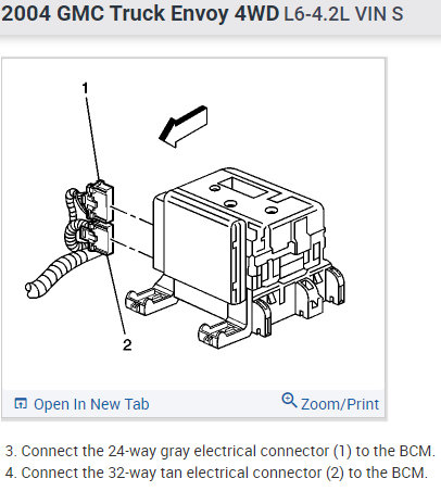

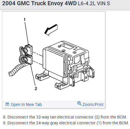

I do have a question. Have you checked for damaged wires where the wiring harness goes from the body (top of liftgate) to the liftgate door? It is common for them to fail from opening and closing many times. Pull back the rubber boot there and inspect them. See pic 2.

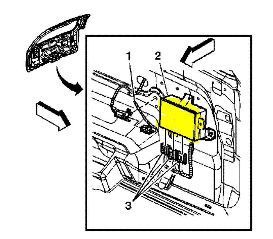

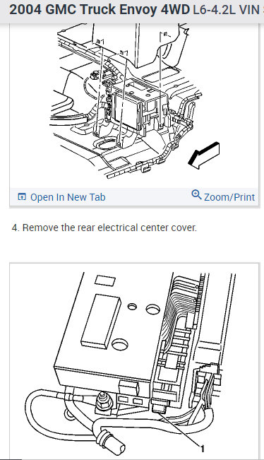

Also, there is a liftgate module in the door itself. See pic 1. Check to make sure none of the wiring is damaged, cut, or disconnected.
Let us know what you find. I have a feeling that you have an open circuit to the liftgate module. Chances are it is where the wiring goes from the body to the door. Also, thank you for your service to our country. It is truly appreciated. I hope you have a safe and good new year.
