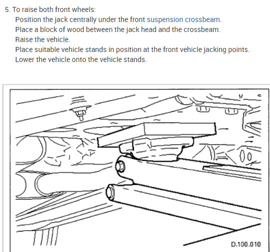

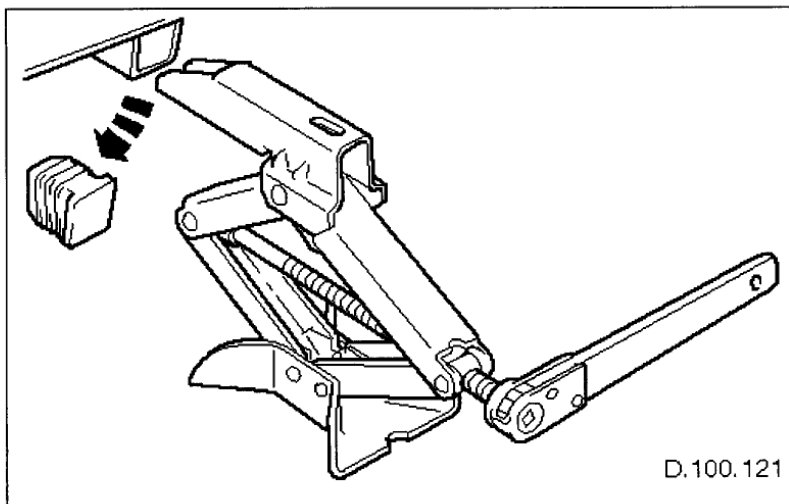

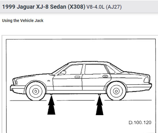

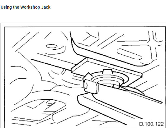

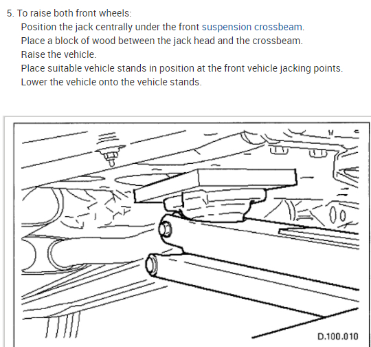

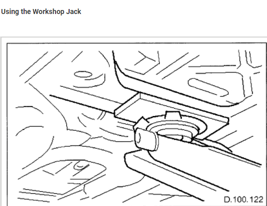

I have the vehicle listed above and would like to get the jack points front and rear using a floor jack. The manual shows front and rear points but their diagrams are atrocious. Any help would certainly be appreciated.
Thanks in advance.
Steve
Mar 5, 2021 at 5:38 AM
DANNY L
  • 5,648 POSTS
Hello, I'm Danny,
Here is the information you requested. This is a tutorial for you to view showing how to properly jack-lift your vehicle:
I've attached picture steps below showing how to lift-jack your vehicle off the ground. Hope this helps and thanks for using 2CarPros.
